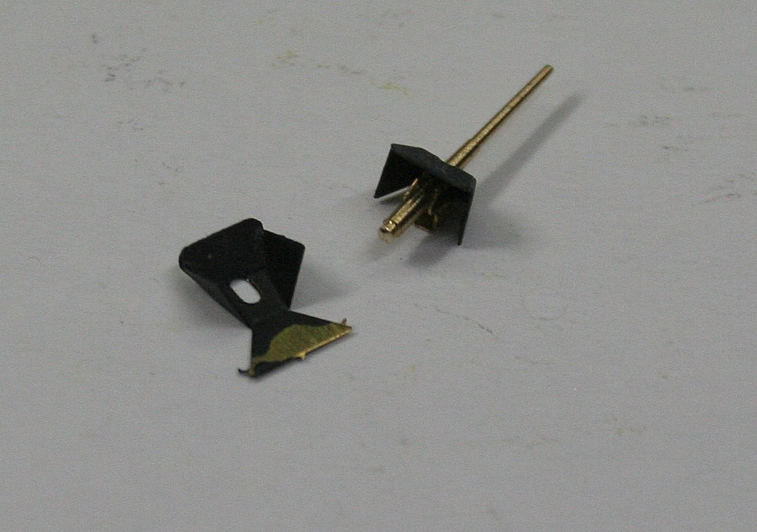

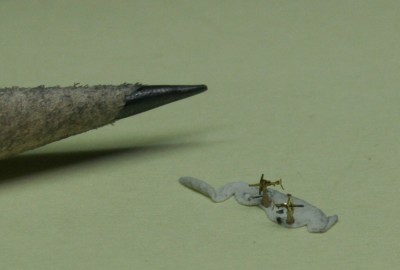

Having previously folded up the gunshields it was time to build the 8 x main guns
So as to make the positioning, holding and alignment easier I made a mini-jig
the gun bases were tacked in place with thinned matt varnish
That way I was able to dribble CA onto the trunnion positions using a soft piece of stretched sprue-- and not dislodge the finely balanced barrel!

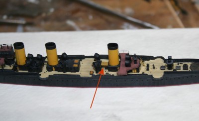

Study of the plans and photos led me to add more doors-as well as the platform ahead of funnel 3; this was made of some PE with wood planking ( Old WEM Askold set from scrap-box )
This platfrom is hard to discern in photos --and it is not that easy to glean from the plans either!!

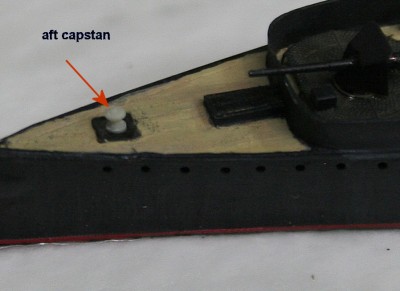

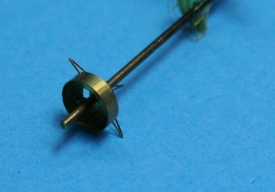

The capstans on the foredeck and the aft deck were turned from resin-mast scrap in a mini-drill.
Resin turns beautifully --and unlike plastic is a ""clean" material to turn--not un-akin to metal!

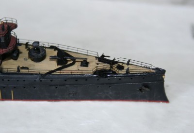

Created the anchor beds by outlining with the railing

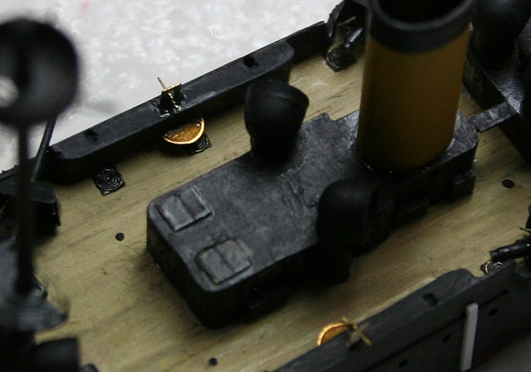

I have added the gash shutes and some overboard discharge pipes made of 1/350 PE railing longitudinals )

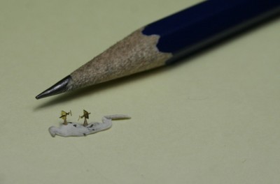

....spent even more time making 6 x 47 mm guns-- the conical bases were made from cocktail stick tipd immersed in CA. topped with a small styrene sliver-- furnished with shields from a WEM Askold PE fret and a copper wire barrel.
The kit supplied items were too tall and clunky for my liking
