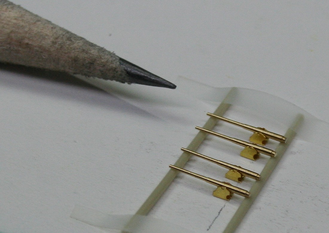

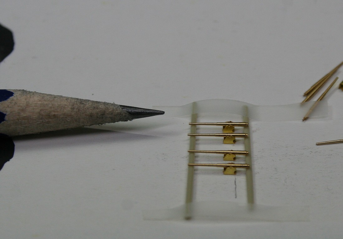

Having previously folded up the gunshields it was time to build the 8 x main guns
So as to make the positioning, holding and alignment easier I made a mini-jig
the gun bases were tacked in place with thinned matt varnish
That way I was able to dribble CA onto the trunnion positions using a soft piece of stretched sprue-- and not dislodge the finely balanced barrel!
For ease of assembly by less obsessive modellers (!) the rather nice PE shields incorrectly have base plate..
As a temporary measure, I left in place to ease painting- and removed afterwards

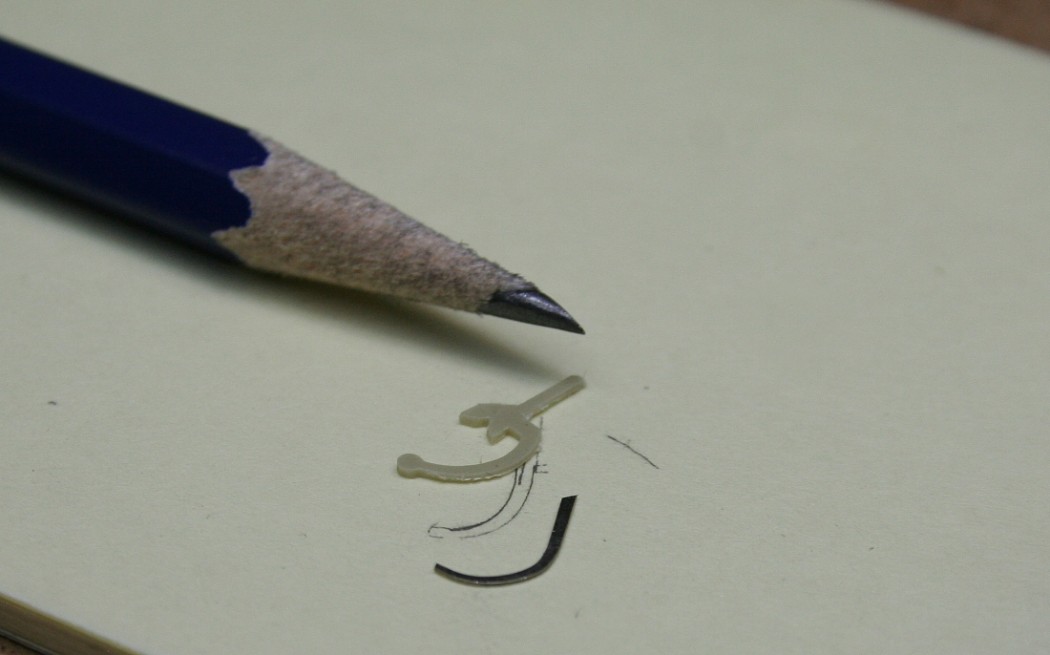

Zhemchug had some truly gargantuan davits--of a pattern that many Russian ships of her era had...
I have in the past built these either by refining the kit resin items, scratchbuilding by laminating brass and styrene strip so as to obtain the taper and then bending the brass to hole dthe styrene strip in shape etc etc
This time I took a new approach....==> using very sharp Fiskar scissors to cut some tapered strips from some old (and pretty thick !) Railway model nickel silver PE fret waste.
Unlike brass this metal seems to be able to withstand bending ( stretching!) in the 'wrong ' --ie flat plane -
- I tried it with brass first but it kept fatiguing and breaking.
See below the original resin parts as a comparison-- they are too thick, not quite the correct shape, slightly too tall and incredibly fragile ! ( brittle resin)
After adding some small shards of the same thick PE to the lower bases, a styrene strip on the hull , a dab of white glue below the cradle and some PE brass porthole lids to simulate the twin pulleys ...
It all looked reasonably convincing once painted compared to the photos of the real thing

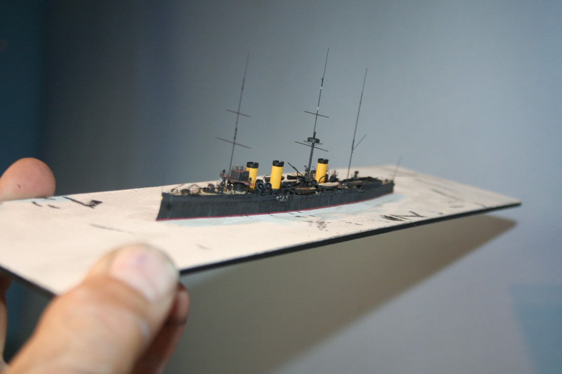

I love a Saturday afternoon of bad weather==> model ship progress! :cool_2:
After the tedium of making wire davits and ships boats ...the fun of erecting masts could commence !
Zhemchug carried outrageously tall masts--three of them.
I have devised a method of enuring the masts all set perpendicular whilst the slow setting epoxy and CA are setting
Simply suspend the ship upside down--the masts dangle nicely... :heh: easier than trying to keep them in position with the ship upright!!-- let gravity be your friend! :thumbs_up_1:
The ship carried identifying stripes on her main mast--I made these using very thin decal stripes--black thin on white broad....
The various sections of the masts had the strapping simulated with decal striping--makes just enough of a bump to look interesting....
The wild nature of the masts..(!!) is evident in these hastily shot images....
More soon
Jim B :wave_1:

the method of installation of masts, by gravity,is really "simple" and effective :thumbs_up_1:
thank's for the tip

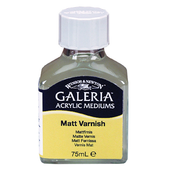

Thereafter the flatcoating was uneventful...( phew!) as usual I was using the Galeria varnish I obtained a very flat even and dead smooth surface.

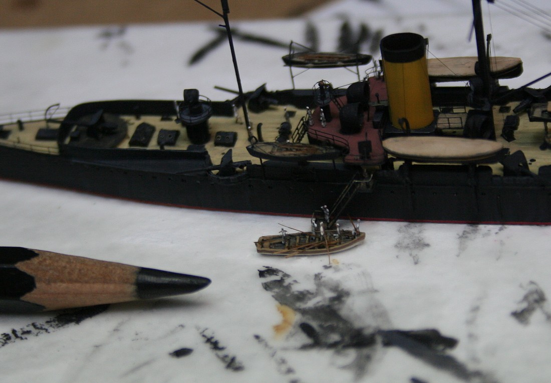

So as to add some interest to the scene I have placed a rowing gig idling about the accommodation ladder ( waiting for the 'brass to return?)-with the crew engaged in fending her off using a boat spar- no big deal ...as the are on the leeward side...
Rigging is not an activity that lends itself well to posting on--so there may be radio silence for a day or six....

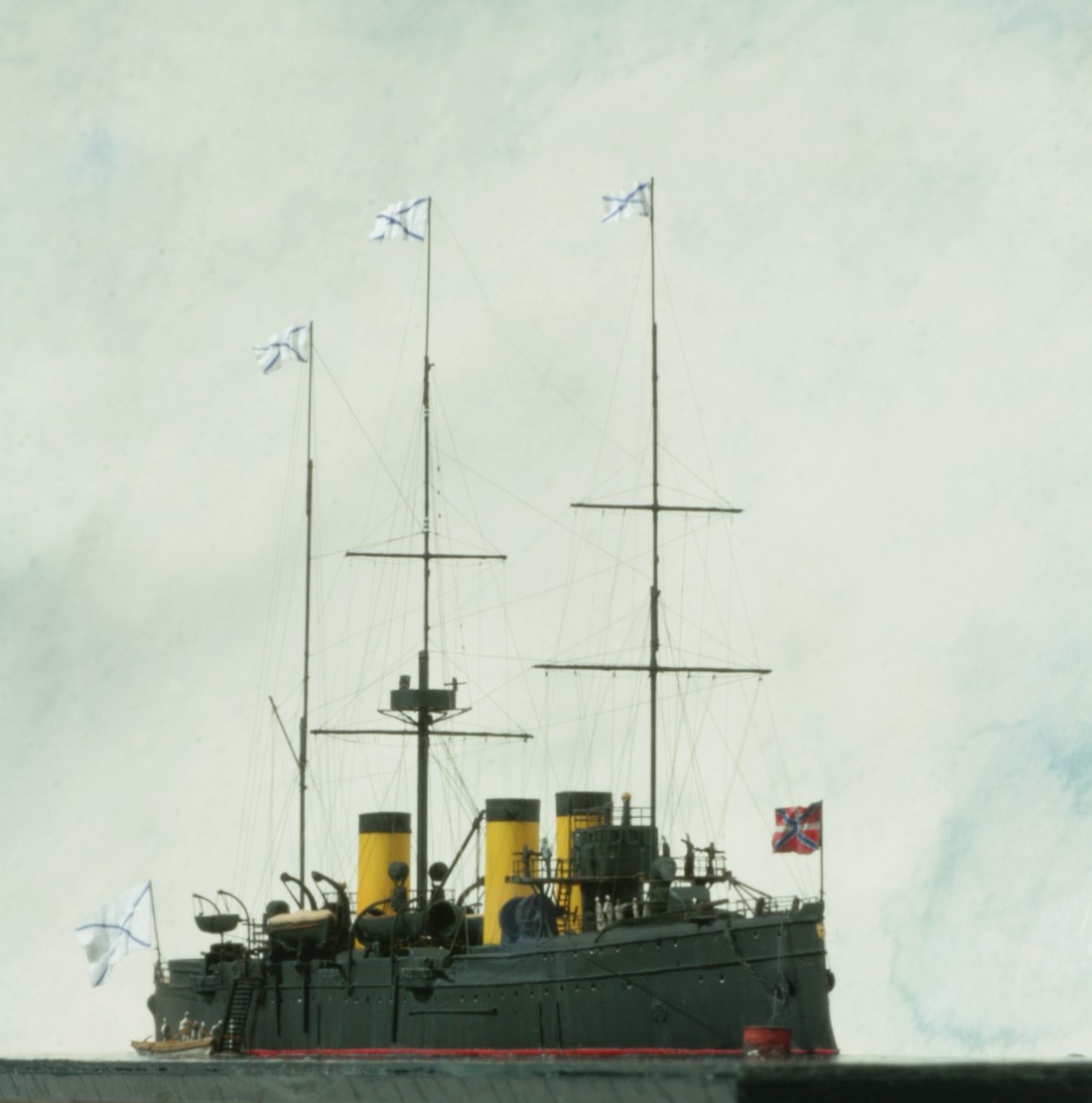

back from the ( rigging ) wilderness....! :wave_1:
she is complete at last!- there was a lot of very fine rigging to do on some very very skinny masts...
( :mad_1: :Mad_6: :Mad_5: :mad_2: :censored_2: :lol_3: )
- full photo coverage will be in the gallery in due course.
meanwhile..... here are a few taster shots....
onwards to the new project :thumbs_up_1:
Thank you all for following this build--a link to the gallery will be posted when it appears there ....
Jim Baumann

Are the flags printed paper? How did you get them to flutter so naturally? I tend to use white glue + paper but it tends to appear overscale in 1/700.
