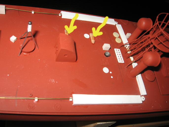

Before manufacturing and installing the torpedo tubes I concentrated on some of the smaller, surface mounted deck detail. The torpedo tube races (sometimes called racers) were made from square section aluminium strip. This was formed around a paint tin of approximately the correct diameter, matched to the plans and trimmed to length before being gently bent to match the deck camber. CA glue was used to fix it in place.
The small white circles represent the glazed deck lights. These were punched out of self adhesive aluminium foil, embossed slightly and are practically flush with the deck.
The arrows indicate the positions of the two countersunk bolts which hold down the removable deck section.
One of the man holes was raised higher than the others to clear the boiler room sky light and on the model this was reproduced by adding a length of (blue) plastic tube to a cast resin man hole.
The positions for a lot of the deck detail have been transferred from the plans and pencilled onto the deck.
The triangular shapes at the deck edge are the mounting positions for the Maxim machine guns.
The hole (with a black collar) is the position for the aft mast.

File comment: The location positions for much of the deck detail have been transferred from the plans and pencilled in.

Hi all
The deck detailing continued.
I had worried about the two steel lattice-work supports for the bridge wings. I knew the joint of the lift-off section of the deck would be beneath them, so the dilemma was, should they be attached to the hull or to the lift off section? In the end I decided to reinforce them and attach them to the hull.
The picture shows the model, still lacking much deck detail and in red primer. The lattice-work bridge wing support, so much a feature of many German destroyers of the period, are arrowed.
They were printed out on the 1.5mm plastic card sheet, so I carefully cut them out and glued a bent brass wire (1.5mm diameter) to their reverse edge. This in turn was inserted into two holes in the deck and glued in place. As both supports were now quite solid I was able to slide the removable deck section into place, with the bridge wings sitting on top of, but not glued to the supports.
Two small crane type hoists were situated on the deck amid ships, port and starboard. These were used to hoist torpedo re-loads on board. The re loads would have been lowered onto a small trolley which ran on the rails along the deck. These two cranes would probably have lent themselves to being etched in brass but I do not have access to this equipment so fabricated them from wire and off cuts.
The navigation lights are resin castings, like the anchor crane, which was covered in more detail in a previous post. These have been painted prior to fitting.
File comment: The lattice work supports for the bridge wings remain fixed to the deck while the bridge and boiler room roof lift off.
