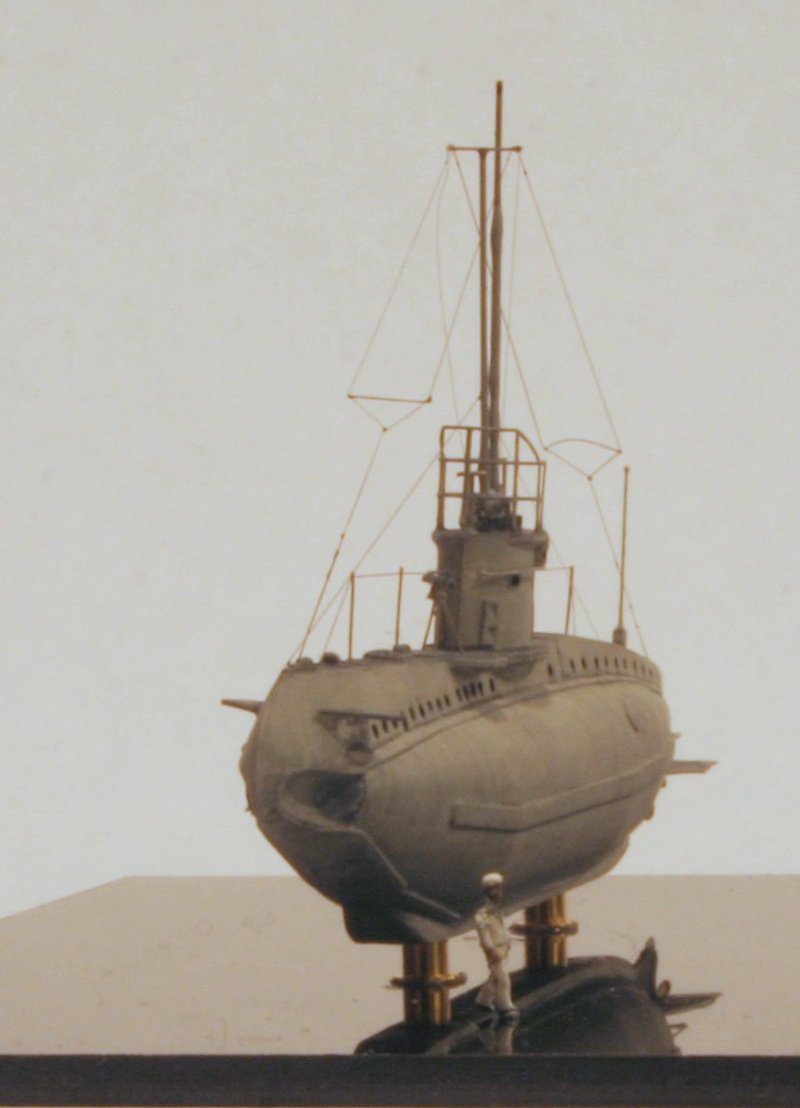

Fishing line --even the very finest --as mentioned in 1/700 is too thick fro my liking
==> and also does not allow reliable consistent sag to be created.
Copper wire does a good job of this- but can be very prone to kinking and dislodging when working on it
( especially in 1/700 scale)....
Here are a couple of masters of copper rigging -both of whom generally work in in scales of 1/384 upwards
