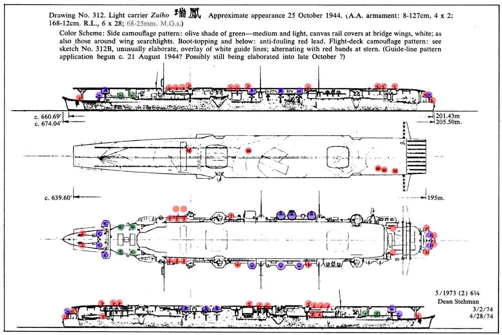

I'm currently painting up a Hasegawa Zuiho model that's been on the shelf of doom for the past few years and I'd like a hand with a few details of her configuration at Cape Engano.
Is there any good information as to where the single 25mm were placed? I've trawled up a very basic image from the net, but I'm not overly trusting of it. :scratch:
The kit instructions state that the armament remained grey after she was camouflaged and the box art seems to indicate that the masts were likewise left grey. Is this correct? What about the underside of the flight deck overhangs and the steel decks? Is there any info on these areas on this or other ships? Did everything end up green?
Apart from the boat deck area, were there any other external decks covered with linoleum?
Thanks in advance,
Mike. :smallsmile:
PostPosted: Mon Aug 05, 2013 1:36 pm
Posts: 8835
Hi, Mike -
Tough questions, because the documentation is so thin. I am not the final expert so, anyone who has done some research should feel free to chime in.
I don't have an authoritative chart on placement of the single 25mm mounts. I've got a 40 year old plan done by an expert of the time. Below.
Grey armament and masts seem as likely as not. I've attached a colorized photo by a Japanese illustrator. You must judge for yourself. :smallsmile: It should be noted that the bases of the 12.7cm mounts seems to follow the color of the area they are in, though.
I would think that the forecastle deck ahead of the bridge, to the the anchor deck, would be linoleum covered as well.
FWIW.

Thanks for that Dan! :thumbs_up_1:
I was a bit surprised to see AA mounts actually on the flight deck in the diagram, but I guess it makes sense as she was no more than bait.
I think what I'll do is leave some areas grey, just to have some visual interest. I'll paint the overhanging areas green since the well known photo of Amagi on her side seems to indicate that those areas were green.
Thanks again,
Mike. :cool_1:
PostPosted: Tue Aug 06, 2013 1:24 pm
Posts: 8835
Your plan seems reasonable to me.
