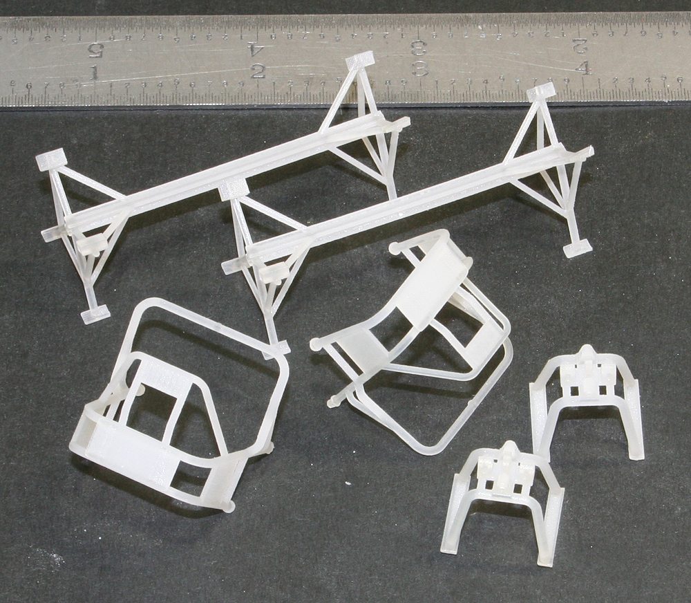

A little hard to see all the parts in some of the previous shots, so's here's a catalog for anyone keeping score.
I actually have a lot more parts coming in the net 2 weeks... in the meantime, I'll be fettling these, getting them ready for paint.
Again, the parts come in with some wax and oil, which I clean off each part with warm soapy water and a toothbrush. Then, each part needs a certain amount of surface smoothing in addition to the deflashing/sprue clean up that you'd expect with a plastic kit.
The plastic is more brittle than regular styrene, which means de-spruing needs to be done more carefully. You can't just snip the parts off... I've been using a jeweler's saw instead.

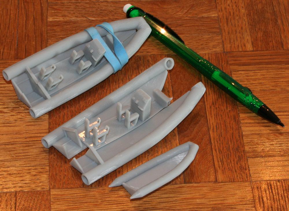

The new RHIB parts were just received today. These come from i.materialise, a Belgian firm that operates like Shapeways, but also farms work out to shops around the world... my parts came to me in Michigan from Wisconsin.
Shapeways' fine detail parts are all done on multijets, but i.materialise leans heavily on stereolithography (the process where parts are drawn by laser in a pool of liquid resin). Both processes are capable of very high definition... but you are at the mercy of the supplier, who may choose not to use the highest def process in interests of processing time. You can still see the strata on the close up of the small RHIB... but it's almost invisible to my unaided 56 year old eyes. They'll still get sanded and filled though.
Another point is that you are at the mercy of part orientation... look closely at the seat/deck assembly for the large RHIB, it's downright glossy... that surface was horizontal and up.
File comment: RHIBs. Big ones are split so that I could hollow them out to save material.

File comment: Small RHIB, with visible striations

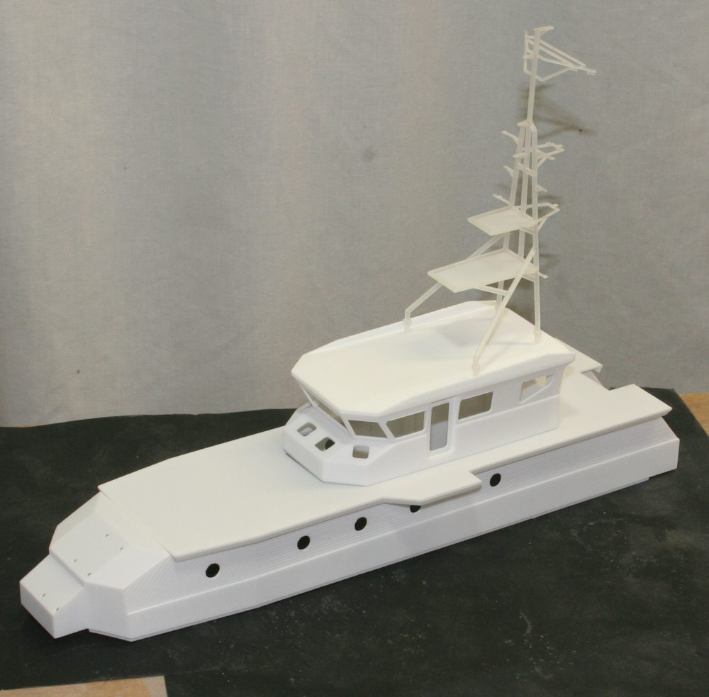

I lied. I said this model would be 99% 3D Printed. Well, maybe 96%... I made the main deck from plywood & styrene.
I did design a deck for printing, but it was so trivial I didn't bother... just used the design as a pattern to cut out the 1/32" aircraft ply, and coated that with 0.010" styrene.
Also, the bulkheads and deck beams are ply.
And I turned the exhaust outlets from brass.
I have to admit, it was good smelling the sawdust again as I sanded the deck edge...
BTW, the notches in the aft quarters are for ejectable gasoline tanks, as spec'd by the CCG. The ship is diesel powered, so they have to carry gasoline for the boats on deck. This is done with these side tanks, and the tanks are ejectable for safety reasons...

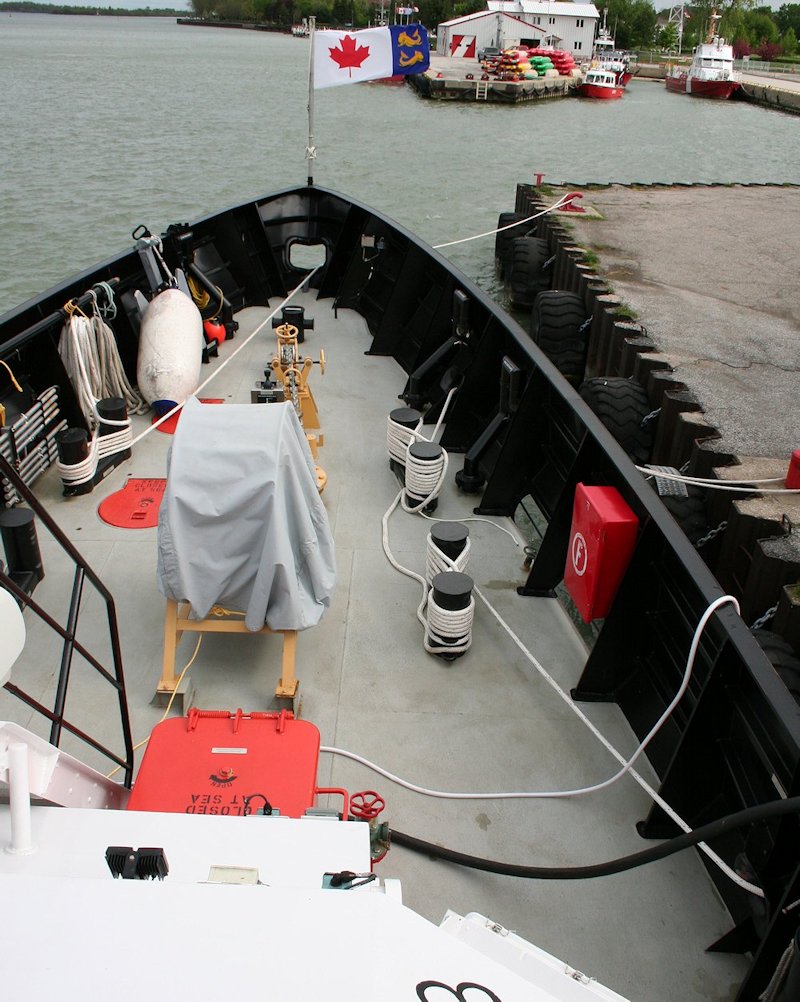

File comment: 1:1 ladder... ok, a few liberties taken... my railings are a heavy 0.75mm, close to the limit for this printing technology and modeling feasibility.

The forward bulwark braces (20 per side) are ALL different, to fit inside the bulwark with its changing form. Of course you COULD design these to be printed with the hull, but then it would be a nightmare to sand between them, not to mention painting, especially where they meet the deck. So they're all loose, and now it's time to pay the piper...
I designed them 0.5mm "into" the bulwark wall, and then subtracted them from the hull, leaving perfectly placed grooves for placement. These are all scraped out after painting, and the braces are prepainted and ready for gluing in place. Well, at least I've started.

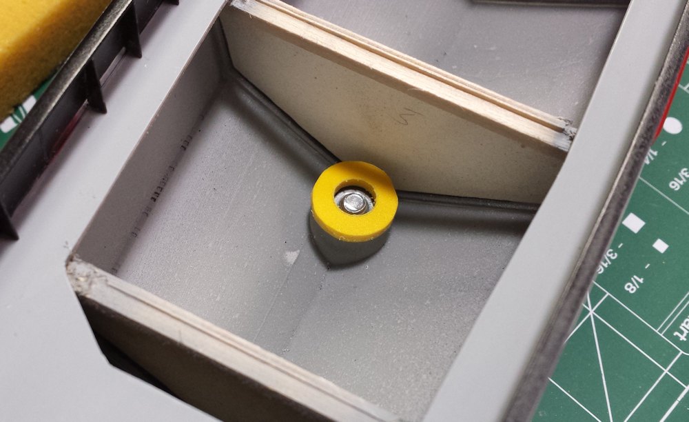

If you're going to print a hull, you can include all sorts of features... ledge for the deck, ribs for placing bulkheads, etc.
I included nice heavy bosses for the pedestal mounting.
> Inside, a cut-out locates the 1/4"-20 nuts; a simple cap is glued on to trap the nut.
> Under the keel, cut-outs provide sockets for the pedestals themselves. These are flat-bottomed, and set at the same height, so the pedestals are simple flat topped cylinders of the same length, and they mount the hull perfectly square to the base... no carving the pedestals to fit the hull!
And being so solid, I have no fears about the mounting screws being snugged up over the years...
File comment: Nut in socket

File comment: Cap to trap the nut
File comment: Socket underneath perfectly matches the pedestal.

Working on the foredeck, it's like hanging ornaments on a tree...
You can see some of the crazy bent vent pipes along the bulwarks... easy in 3D, they'd be a bear to hand build!

Another example of the problem of surface finish. SLS (selective laser sintering) fuses dry nylon powder together to make the part. It's more affordable than most multijet processes, but it make porous parts with a larger step dimension. This means lots of filling and sanding, which again means that little surface detail should be included to allow for the sanding. It's also helpful to use a heavy primer-filler for the first coat or two.
My pilot house and pilot house roof are both SLS. The house is nearly done and is looking good, while the roof has only had the first coat of primer filler, and could use another before I go to regular "finish primer"... see the steps in the shallow angles on the roof.
