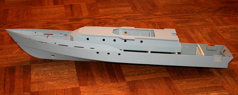

Just to get an idea, how much roughly did the frame below set you back ?

http://www.shapeways.com/materials/frosted-detail
"FUD" material is USD3.49/cm3... and there is a good number of cm3's in there...

Yes, I know, how they calculate it, but would have liked to get a rough idea of the cost such a part before diving myself into the subject matter :big_grin:

Working on the foredeck, it's like hanging ornaments on a tree...
You can see some of the crazy bent vent pipes along the bulwarks... easy in 3D, they'd be a bear to hand build!
File comment: 1:1 version
File comment: ALL fittings should be pegged for mounting. Sometimes I remember to include them in the 3DP, sometimes I add them, like here with 0.030" rod.
File comment: Most of the gear loosely in place. Needs a lot of touch up paint still. I like how the detail on the windlass came out.
