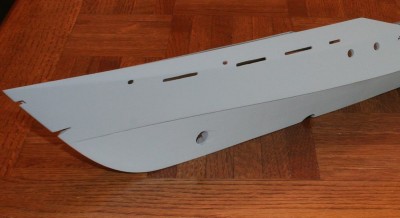

File comment: Hull... with black CA gooped on to hold the internal bulkheads.

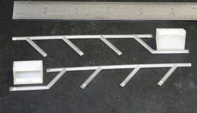

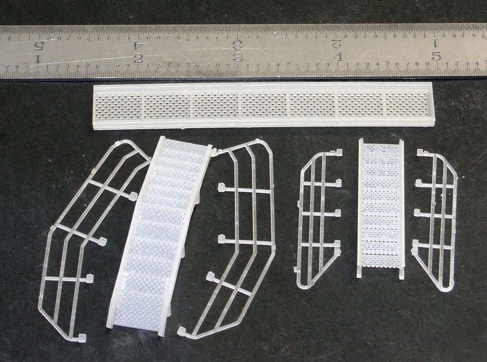

File comment: Ladders and railings

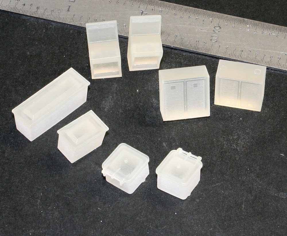

File comment: Some boxy things

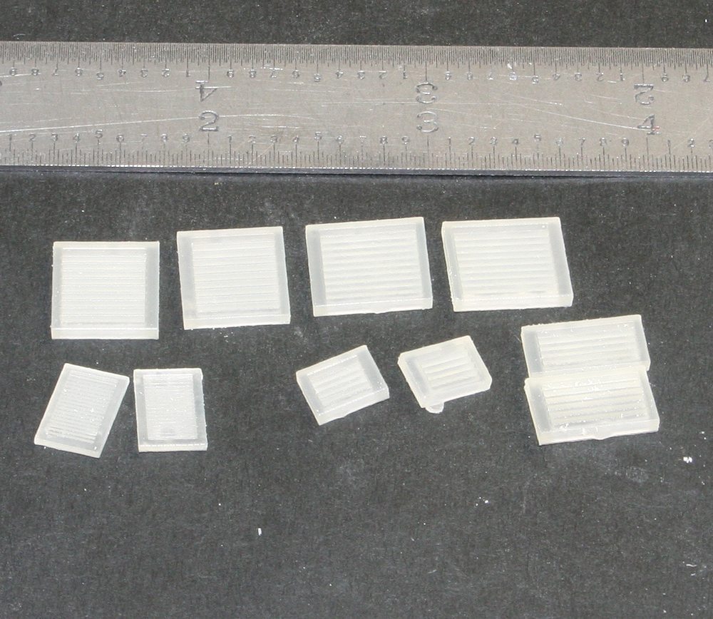

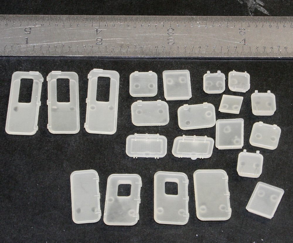

File comment: Doors & hatch covers

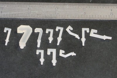

File comment: Bevy of vent pipes

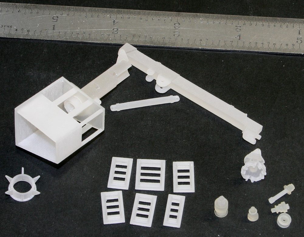

File comment: Crane parts

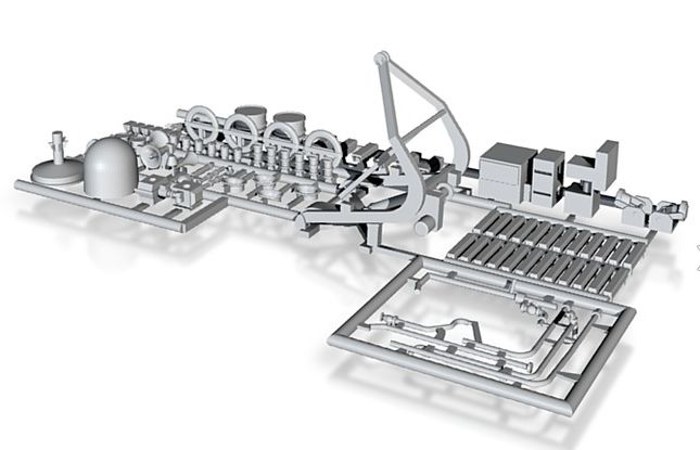

And here's what's coming:
File comment: Miscellaneous things that stick out here and there

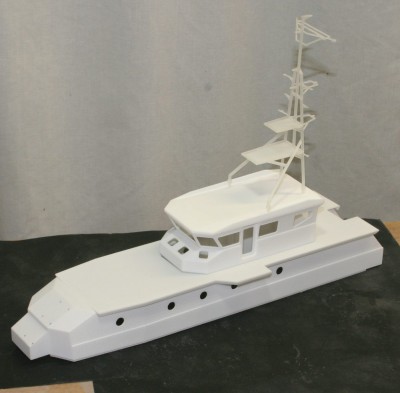

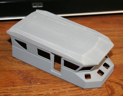

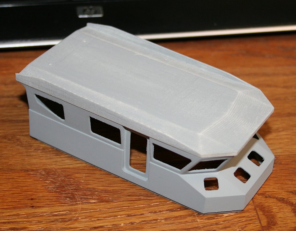

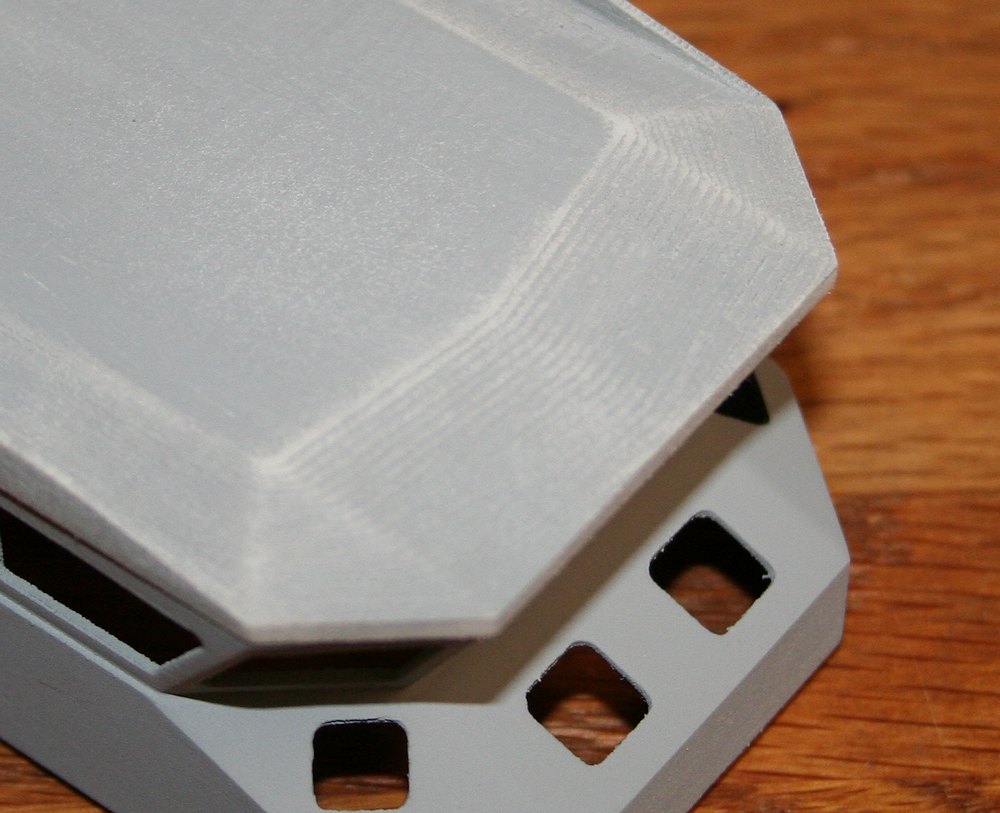

Alright, after a long time of researching, designing, ordering, and waiting for the UPS man, I now have ALL parts in hand to complete the build. Basically, I'm at the point where a kit modeler excitedly opens the new box!
Most everything has been washed, de-sprued, fettled, and washed again, ready for paint and assembly. And indeed, I've started with prime/sand/prime/sand/repeat on the large parts-- hull and cabin. A lot of filling is needed to remove all traces of the 3D Print strata.

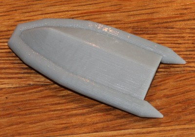

The new RHIB parts were just received today. These come from i.materialise, a Belgian firm that operates like Shapeways, but also farms work out to shops around the world... my parts came to me in Michigan from Wisconsin.
Shapeways' fine detail parts are all done on multijets, but i.materialise leans heavily on stereolithography (the process where parts are drawn by laser in a pool of liquid resin). Both processes are capable of very high definition... but you are at the mercy of the supplier, who may choose not to use the highest def process in interests of processing time. You can still see the strata on the close up of the small RHIB... but it's almost invisible to my unaided 56 year old eyes. They'll still get sanded and filled though.
Another point is that you are at the mercy of part orientation... look closely at the seat/deck assembly for the large RHIB, it's downright glossy... that surface was horizontal and up.
File comment: RHIBs. Big ones are split so that I could hollow them out to save material.

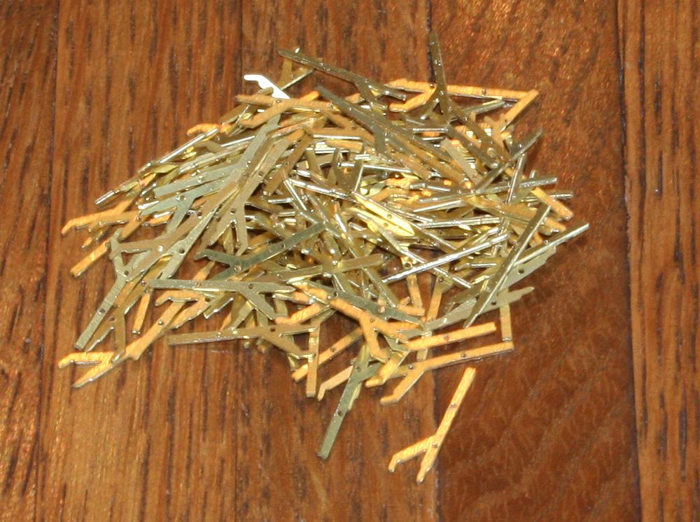

File comment: 124 stanchions in 0.5mm stock- all desprued and fettled.

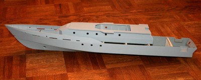

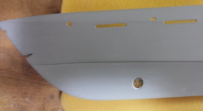

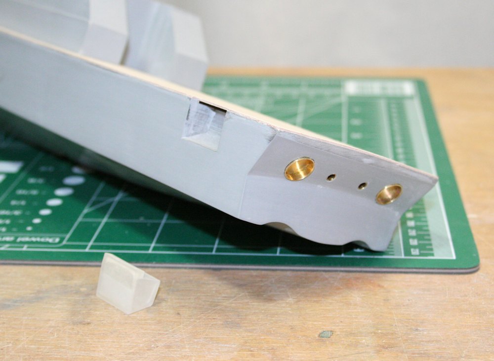

I lied. I said this model would be 99% 3D Printed. Well, maybe 96%... I made the main deck from plywood & styrene.
I did design a deck for printing, but it was so trivial I didn't bother... just used the design as a pattern to cut out the 1/32" aircraft ply, and coated that with 0.010" styrene.
Also, the bulkheads and deck beams are ply.
And I turned the exhaust outlets from brass.
I have to admit, it was good smelling the sawdust again as I sanded the deck edge...
BTW, the notches in the aft quarters are for ejectable gasoline tanks, as spec'd by the CCG. The ship is diesel powered, so they have to carry gasoline for the boats on deck. This is done with these side tanks, and the tanks are ejectable for safety reasons...

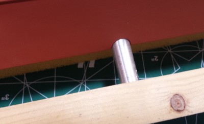

Propshafts-on-skegs, and aft quarter rub rails. I printed the portion of the rub rails with all the intersecting parts, and used 1/2 round styrene for the long straight run forward.

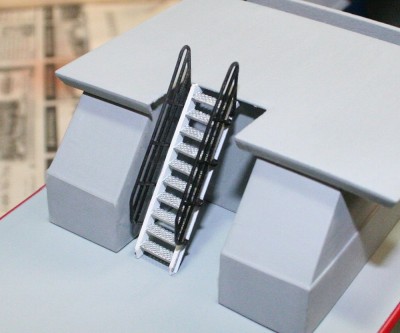

A busy weekend with the airbrush. Lots of little details, as well as big jobs like the hull. I jump around a bit... painted and assembled the aft ladder for example.
File comment: Hull mostly painted
File comment: Aft ladder, all 3DP
File comment: 1:1 ladder... ok, a few liberties taken... my railings are a heavy 0.75mm, close to the limit for this printing technology and modeling feasibility.

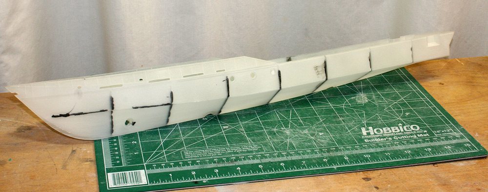

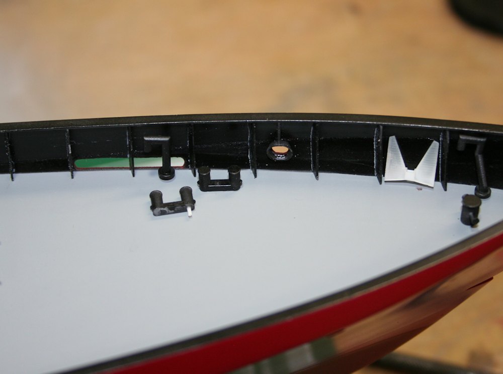

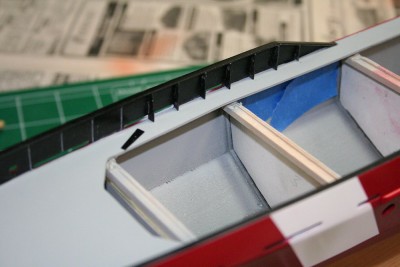

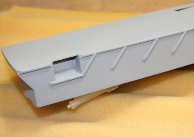

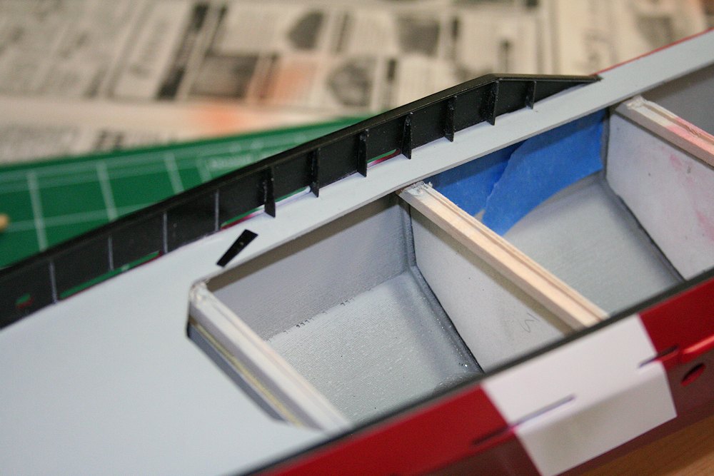

The forward bulwark braces (20 per side) are ALL different, to fit inside the bulwark with its changing form. Of course you COULD design these to be printed with the hull, but then it would be a nightmare to sand between them, not to mention painting, especially where they meet the deck. So they're all loose, and now it's time to pay the piper...
I designed them 0.5mm "into" the bulwark wall, and then subtracted them from the hull, leaving perfectly placed grooves for placement. These are all scraped out after painting, and the braces are prepainted and ready for gluing in place. Well, at least I've started.
File comment: Scraping the grooves out... 0.5mm wide.
File comment: It's a start.

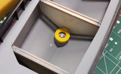

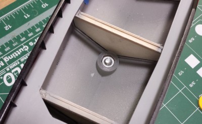

If you're going to print a hull, you can include all sorts of features... ledge for the deck, ribs for placing bulkheads, etc.
I included nice heavy bosses for the pedestal mounting.
> Inside, a cut-out locates the 1/4"-20 nuts; a simple cap is glued on to trap the nut.
> Under the keel, cut-outs provide sockets for the pedestals themselves. These are flat-bottomed, and set at the same height, so the pedestals are simple flat topped cylinders of the same length, and they mount the hull perfectly square to the base... no carving the pedestals to fit the hull!
And being so solid, I have no fears about the mounting screws being snugged up over the years...
File comment: Nut in socket
File comment: Cap to trap the nut
File comment: Socket underneath perfectly matches the pedestal.

PostPosted: Wed Jul 24, 2013 8:42 pm
Joined: Fri Jan 21, 2005 8:24 pm
Posts: 442
Location: Temecula
Working on the foredeck, it's like hanging ornaments on a tree...
You can see some of the crazy bent vent pipes along the bulwarks... easy in 3D, they'd be a bear to hand build!
File comment: 1:1 version
File comment: ALL fittings should be pegged for mounting. Sometimes I remember to include them in the 3DP, sometimes I add them, like here with 0.030" rod.
File comment: Most of the gear loosely in place. Needs a lot of touch up paint still. I like how the detail on the windlass came out.

PostPosted: Fri Jul 26, 2013 9:57 pm
Posts: 442
Location: Temecula
Another example of the problem of surface finish. SLS (selective laser sintering) fuses dry nylon powder together to make the part. It's more affordable than most multijet processes, but it make porous parts with a larger step dimension. This means lots of filling and sanding, which again means that little surface detail should be included to allow for the sanding. It's also helpful to use a heavy primer-filler for the first coat or two.
My pilot house and pilot house roof are both SLS. The house is nearly done and is looking good, while the roof has only had the first coat of primer filler, and could use another before I go to regular "finish primer"... see the steps in the shallow angles on the roof.
