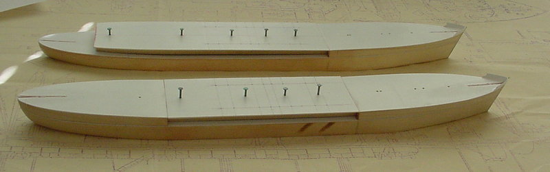

Pic 1 hull blanks
Pic 2 APA foreground (extra deck level aft), AKA in background

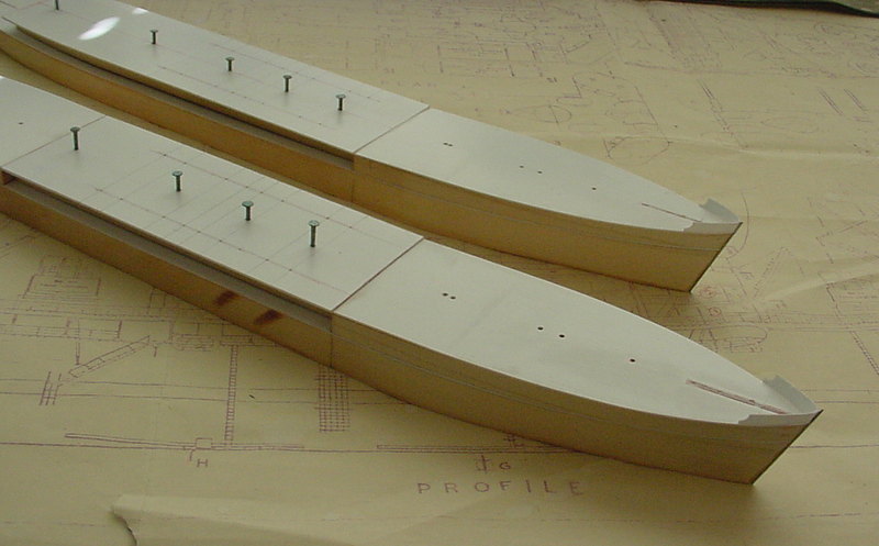

Pic 3 & 4 more hull

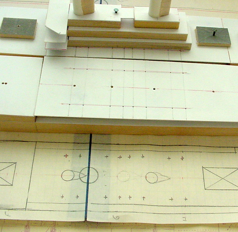

Pic 5 APA, major parts roughed out

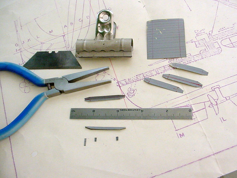

Pic 1 Before parts are made, dimensions need to be known. The width of the boat deck is major, usually it is 12' (.40"), while the LCVP was 10'10" (.37") wide, not a lot of wiggle room. Both the angle davit arm support and the upper boat support are located by holes drilled just outboard of the deck-house bulkhead. I trace the outline of the pinned deck-house on the boat deck, this becomes my "do not cross" line. Add longitudinal locators, punch the hole location and go to the drill press.
Pic 2 Angled davit arm support, the "trickiest" part. The graph paper is decimal inch if you want dimensions. Cut 2" blanks from .032"brass, bend around a 1/4" drill to get the curve to the 30 degree angle. Mark the second bend point (green mark), you will notice that it is "short" - that is because the bend takes length, which has to be "fudged". Straighten the part so the angles are correct and it is on one plane (two bends normally yield a part that is not flat). Cut off excess (red mark) and grind the short end until red disappears (this establishes the height of the part, the long end is inserted in a hole where it will not touch bottom).

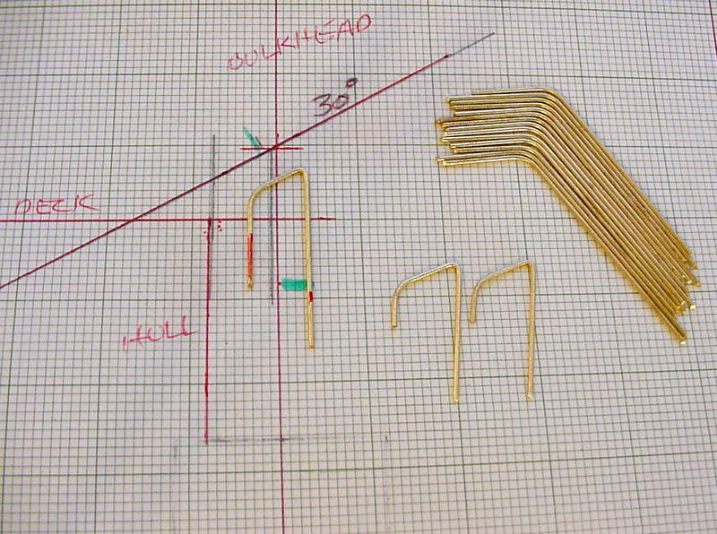

Pic 3 Upper boat support, .028" florist wire (get at any craft shop), two bends around a pliers that is .033" wide. This part is the most sensitive for width, it has to fit in a .040" space yet go around a .37" boat.
Pic 4 Davit arm support sides. Made from a primed .004" thick clear plastic page protector. The tracing pattern is 30 degrees down on both sides of center, crowned with the same 1/4" dia curve that the post was bent around. Length of the part is not an issue, just make it oversize (it will be trimmed to length after it is glued to the wire support). Vertical spacing part to part is 2 mm (.080"). this gives an actual width of 0.067" (the angle causes the difference). You can spit out parts as fast as you can cut one inch with scissors and the set up easy.

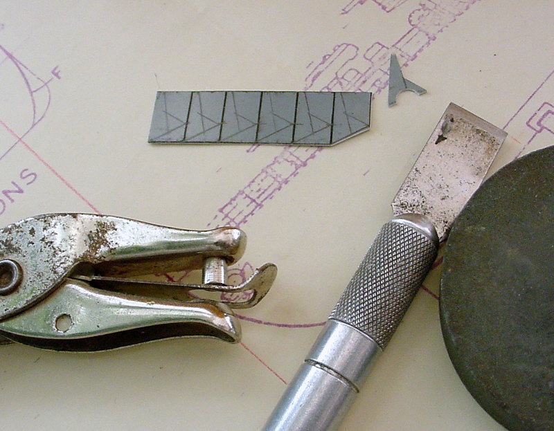

Pic 5 davit arm, .020"styrene. The trick is to draw a set of box grids .30" wide and .47" high. The angle of the base line is 30 degrees going to the right. Where that line ends go 30 degrees up to the left side of the box. The upper portion of the arm is .060"wide at the top and .180"wide at the bottom (measured from left side of box). Four chop cuts with the wide blade, circular recess at the bottom with a .200" dia paper punch. Cut a little "V" notch at the top of the arm. The nice thing about using a grid box is that you only have to measure and mark at the beginning and end of both rows and columns, the marks in between can be made off a straight edge. Even though it looks complicated at first view, after making hundreds, the arm is much easier than the wire support.
Pic 6 Horizontal beam, .005" brass 1.38" x .20". The centerline distance between arm supports is 1.40", 1.38" allows for the wire thickness. I make a 90 degree bend with the paperclip and then pliers. The part is then folded over a .018" thick ruler. "Ironing" with smooth pliers while still on the ruler gives a nice finish. The lift blocks are scrap PE trimmings.
