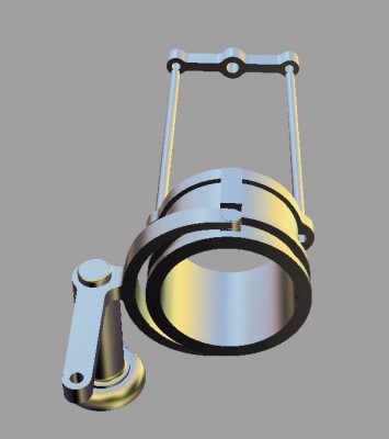

The control linkage inside the turret, like this one from the original Monitor, requires a "swash plate". In the Tecumseh, the central shaft is fixed but the turret-- and the linkage -- rotates around it. The linkage inside the turret acts through rollers to raise and lower the swash plate. The swash plate itself just slides up and down the central shaft -- it does not rotate. It would be a simple matter to connect the rack and pinion in the pilot house to this same swash plate, raising and lowering it from above. (The rack and pinion could also be connected at some point below the turret to the same effect.)
Below the turret there is additional linkage, not fully shown, which connects the up and down motion of the swash plate to the reversing gear of the turret engine. This part of the system would be common to either control input -- the lever inside the turret or the handwheel in the pilot house. Note that if a crewman pulled the lever, the handwheel in the pilothouse would turn. If the Captain turned the handwheel, the lever in the turret would move, traversing part of its range.
