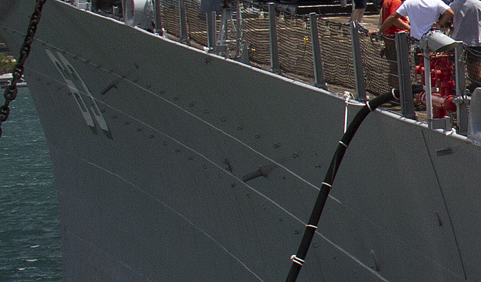

My recollection of the padeyes on either side of the bow area of the hull (2 rows of eyes) is that they are more than likely 3" ID or 4" ID eyes. I don't think they are larger, but very well could be. Any way that you could give me an approximation of their actual size? Also, while I do have photos of the forward hull from various angles, as the photo fades into the background, I am unable to count exactly how many eyes were on each row. Could you get me a count? One other item of dimensional properties might be the distance from row to row and from top edge of hull down to first row, even if they were eyeballed - I can then use the forward body plan to figure approx. distance.

Hank,
I can certainly get you some detailed photos of the eyes from the walkway that goes around the bow. Sadly its not right against the bow but its still close enough for some zoomed in shots and a count. I'll see what I can get looking over the rail but I doubt it'll be much. I'll make notes where the eyes stop in relation to anything I can find that's close by. I'll let you know by the end of the week.

Post by Fliger747 »
Hank:
Here is a portion of a bow photo showing the padeyes. Look to be 3" to my eye. You may be able to scale the location from the lifelines.
Regards: Tom

Here's the pad eyes on the bow.
Case sensitive password: Battleship
http://s647.photobucket.com/user/Cliffy ... t=4&page=1
Note: ALL of them are arranged vertically EXCEPT for the forward most row that is horizontal. Look at the closeups to see what I mean.
Pad eye count as follows:
Top Row: 25
Middle Row: 31
Bottom Row: 26

Cliffy B,
Thanks - saw this on the CASF BB forum. I'll make a note of your count and advice as to arrangement.
This DOES help.

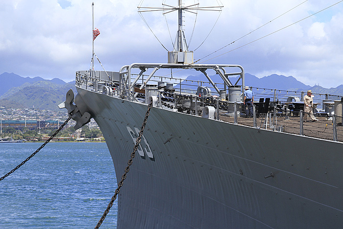

Fliger747 wrote:
Another one
I'm sure everyone is going to cringe when I ask this, but what is the egg beater looking antenna at the bow? I've always wondered and never found an answer (Never set foot on a ship, I just enjoy them by proxy).
Cliffy B
Posts: 3125
Location: Hawaii
Re: Post Your BB-64 Photo Requests
Post by Cliffy B »
The antennae on the bow is the LINK 11 antennae usually associated with NTDS. The BBs just got the antennae however and not the full NTDS package. If I'm remembering correctly, LINK 11 allowed them to see what the sensors of their escorts saw allowing the BBs to go to EMCON and therefore masking the emissions from the capital ship.

Cliffy B wrote:The antennae on the bow is the LINK 11 antennae usually associated with NTDS. The BBs just got the antennae however and not the full NTDS package. If I'm remembering correctly, LINK 11 allowed them to see what the sensors of their escorts saw allowing the BBs to go to EMCON and therefore masking the emissions from the capital ship.
Thanks! Big difference in LINK 11 and LINK 16 antennas. I knew about NTDS from a what it did stand point, I just had never connected it with that antenna. Now that SM-6 is in service, I'm looking forward to what it means for cooperative engagement possibilities with things like the LINK systems. Again thanks.
