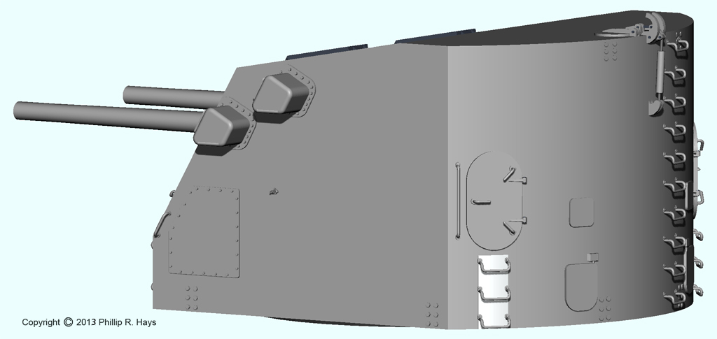

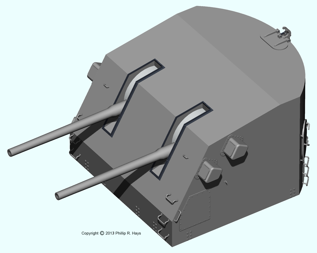

It's been a little slow here lately, so I thought I would post a few of the small projects that are a part of the whole ship project.
First, the dual 5"/38 mount Mk 32. These were pretty much the same on all ships in WWII, and continued in use in the US Navy long after the war. There were several Mods with a lot of small differences, but all were the same outside dimensions. Some ships had bloomers (bucklers) on the forward mounts during part of WWII but other ships did not.
When the OK City was rebuilt as a guided missile ship with command spaces up forward all but one of the 5"/38 mounts were eliminated, and the one, Mount 51, was moved forward to approximately the same position as the original Cleveland class turret #2. There were several changes to the 5"/38 mount over the history of CLG-5/CG-5, mostly having to do with the elimination of the Mount Captain's blast hood and the installation, moving and removal of various antennas from the mount top.
These weren't referred to as "turrets" but were "gun mounts." I am not sure why.
I don't have blueprints for the gun house (or the 5"/38 guns) - the dimensions were taken from Ordnance Phamplets. I still need to add a few details to the shell case ejection ports.

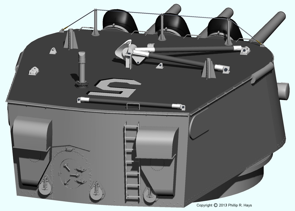

Next up is the triple 6"/47 turret. It is a bit more complex than the 5" mount.
The Cleveland class CLs had four of these, and the earlier Brooklyn class ships had five. There were a lot of variations from ship to ship, mainly in the presence or absence of ladders on the face of the turret and the size and configuration of the vent hoods on the back. Some ships had railings on top but the OK City had them on the sides. In port we tied off canvas awnings to these railings. Turrets on the main deck had hatches in the back plate as shown in the pictures below. Superelevated turrets had hatches in the bottom.
Near the end of WWII the Navy began removing the optical rangefinders from the #1 turrets on ships that went into shipyards. This was a weight saving measure. The #4 turrets on ALL Cleveland class ships never had these rangefinders, and this appears to be true of the #5 turrets on the Brooklyns also.
I have the blueprints for these turrets and this model is drawn to the dimensions in the blueprints. Some small details visible in photographs have been added. I do not have drawings for the 6"/47 gun - I have searched for years and haven't found them - so the barrel dimensions were guestimated from photos and ordnance flyers.
There were several modifications to the replenishment tripod on top of the turret. It could be rigged for operation from either port or starboard, but we normally replenished from the starboard side. The first two pictures show it lowered and the other pictures show it raised. The cable passed through the notch at the top of the tripod, then rubbed against the half-cylindrical bulges on the top sides of the turret before leading down and being fastened to the main deck on the side opposite the replenishment ship. We only took on ammunition at this forward replenishment station.

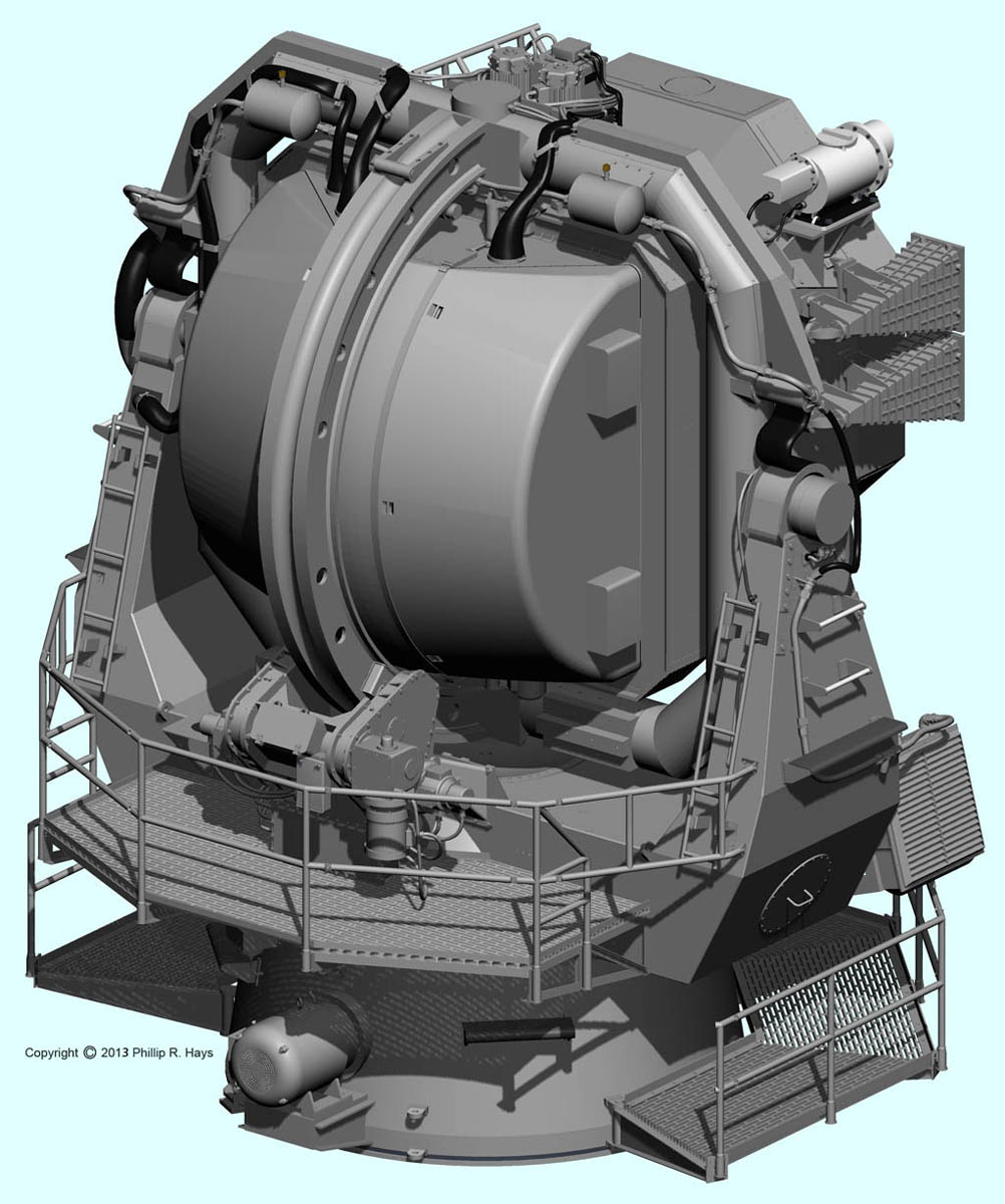

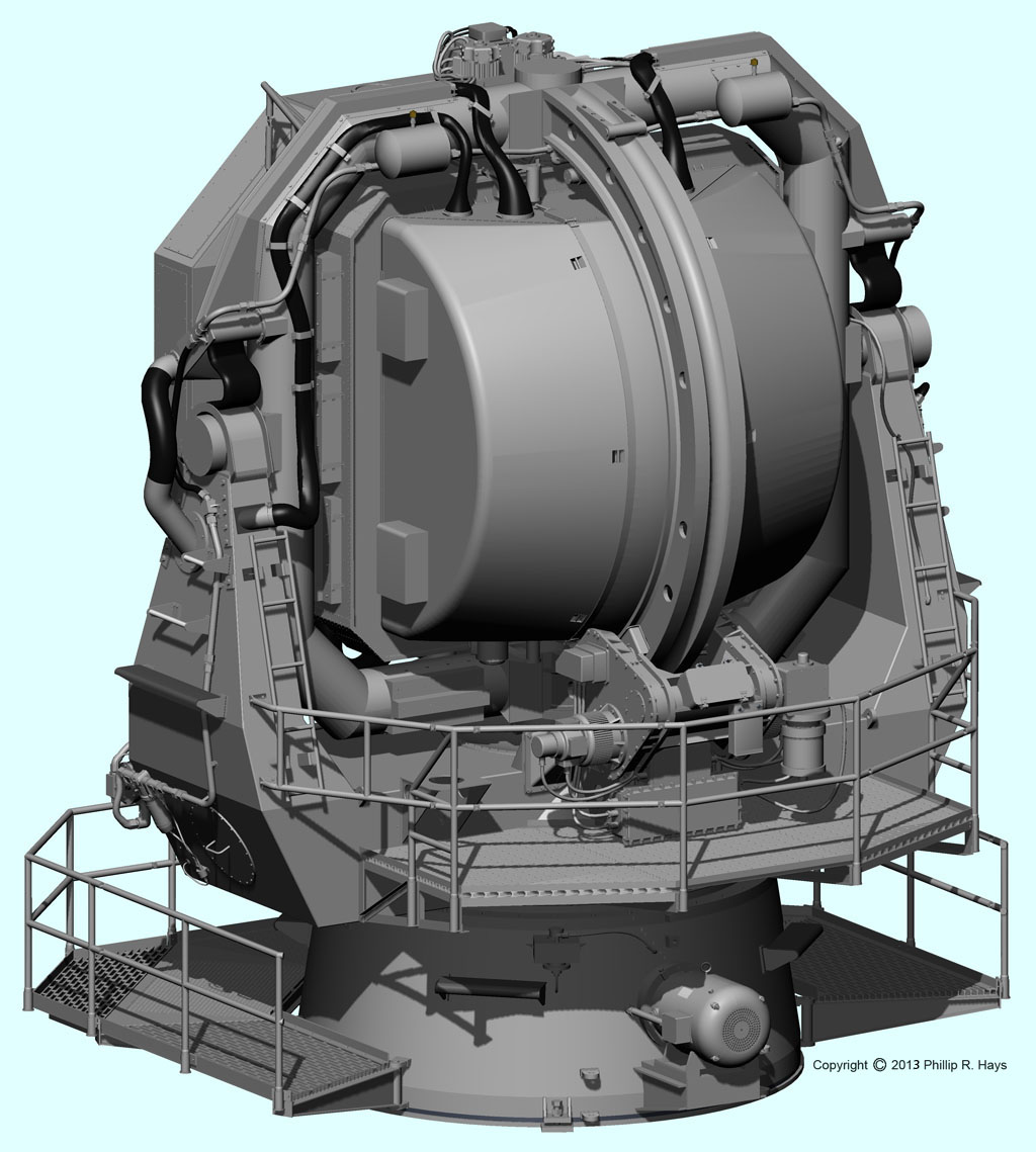

Here is my model of the AN/SPG-49 missile tracking radar antenna. It was a 22 ton behemoth 18 feet (5.6 meters) high and 17 feet (5.2 meters) wide. This thing was a project in itself that took months to finish, and the file size is about 50 Mbytes. I visited the USS Little Rock CLG-4 museum ship in Buffalo, NY, and made photos and took measurements so get the size correct. I haven't found any plans for this antenna, but since I have started on the model the Navy has declassified and released documents for the Talos missile system to the National Archives - about 15,000 pages! Maybe someday I will visit the archives and go through all of that stuff.
This is actually the second model I made. The first was done entirely by photoguestimation from pictures. After I visited the Little Rock I started over with an entirely new model. It should be accurate to half an inch (10mm) or better.
Unlike most radars that have the electronics below decks with wave guides connecting to the antenna, the 49s had all the transmitting and receiving electronics inside the antenna - along with four axis training motors, hydraulics and cooling systems. It was actually two separate C-band radars in one assembly, a 3 megawatt monopulse tracking radar and a 5 kilowatt continuous wave target illumination radar, with horizontal and vertical scanning and polarization mechanisms for the beams. It was an adaptation of the FPS-16 land based radar that was used to track satellites and spacecraft. It's scan range was deliberately limited to 150 miles, although it could easily have tracked the moon.
When Apollo spacecraft were on the way to the moon we received orders to not radiate (we could have tracked them easily while they were in orbit). The Apollos used C-band communications and the 49s would have interfered with communications at the least, and they might have damaged the spacecraft's sensitive high gain receivers.
This model includes everything down to 3/16" (4.7 mm) diameter rivets.

Awesome bit of work on the SPG-49 mate!! :thumbs_up_1: :thumbs_up_1:
I know I have probably asked this before but what would you need to do to use this file to create a 3d printed version of the radar in 1/96 (or 1/72....It would be cheapest to get 1 printed (in either scale)to make a master and resin cast the parts)
I came across a shapeways seller doing 1/96 and 1/72 20mm CIWS Phalanx's but very expensive (approx $84US ea)
Keep up the excellent images mate.....begs the question how much more to render on the modernized version??

I have generated STL files from some of my DesignCAD files - for small boats and such. It can be tricky because I didn't always ensure that there were not "leaks" where complex surface grids come together (not necessary for rendering images or generating 2D plans). If there are gaps they are very small, but 3D printers don't want any gaps at all. It took quite a bit of cleanup.
However, none of the four subassemblies of the SPG-49 are especially complicated. Lots of fiddly bits but I suspect they would print OK. I would need to go back and add pins and sockets for the parts to rotate and figure out how to assemble the parts.
