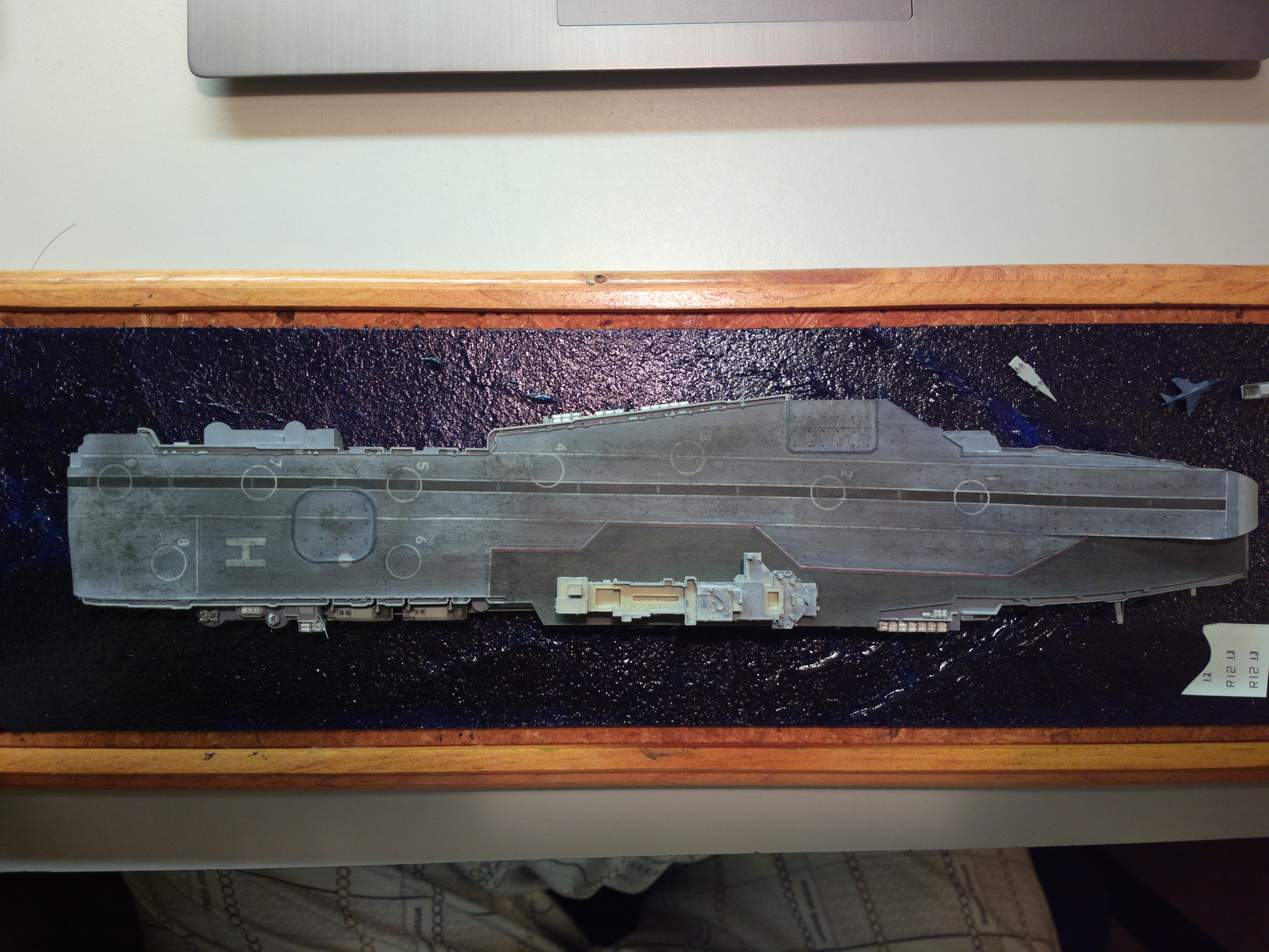

Holy crap an update! Bet you all forgot about this one. Did you know it's quicker to write a Master's thesis than it is to build a model aircraft carrier?
After a series of screw-ups with the flight deck, I think I finally got it fixed to an acceptable point.
Said screw-ups:
1. don't thin Liquitex Acrylic Matte Varnish. It even says so on the bottle. It even says on the website that thinning is bad and may cause fogging. Just don't thin it. No matter how thick it is when applied.
2. don't brush varnish with a paintbrush over top of your subtle and gently-applied pastel weathering
3. don't do both 1 and 2 together. You will have fogging, unwanted streaks, and general chaos on your deck.
4. Gonna try to fix it by masking off the ok parts and painting the rest with the original deck colour? Sure, if you want squares of odd colours all over it!
In the end, I dry-brushed some black throughout the deck, then smoothed it out with some pencil shavings rubbed all over with a paper towel, then sealing it again with the matte varnish (unthinned, this time!).
Pastels and brush work much better when streaking is desired, such as the hull sides, which was what I did.

PostPosted: Mon Feb 17, 2014 3:47 am
Posts: 1534
Location: England
Good job Timmy! :thumbs_up_1: I like how the flight deck markings are faded yet still visible, and the weathering gives that "just been to war" feel like in your reference pictures. Some time ago I was considering getting this kit myself although now I've embarked on a long-term project I don't want the distraction of a 1980s carrier, but I'd love to see this come together to completion.

PostPosted: Mon Feb 17, 2014 6:47 am
Posts: 350
Very nice rust and weathering! It looks very convincing and just like in the photographs of the real thing. And I agree, it is going to take me longer to finish my current build than what it took me to finish my dissertation... :big_grin:

Thanks gents, glad to see it meets with your approval! I was "lucky" that the model is being portrayed with some war time effects, allowing me to go a bit harsher with the weathering to conceal the defects. Also helped to make up for the fact this is my first intensive weathering project!
