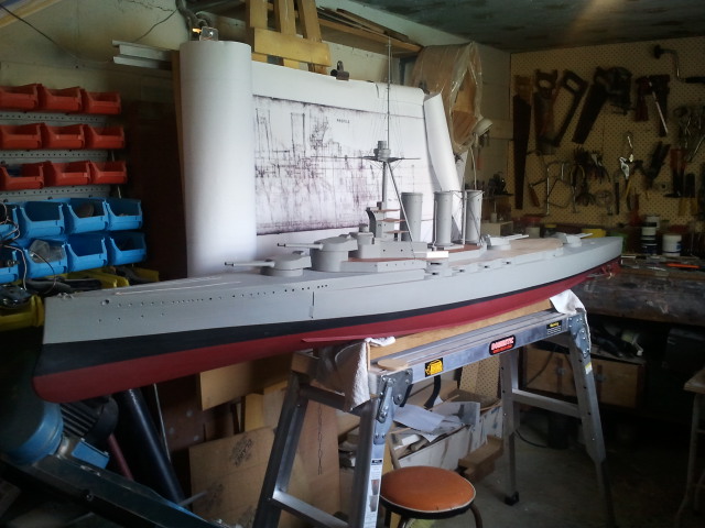

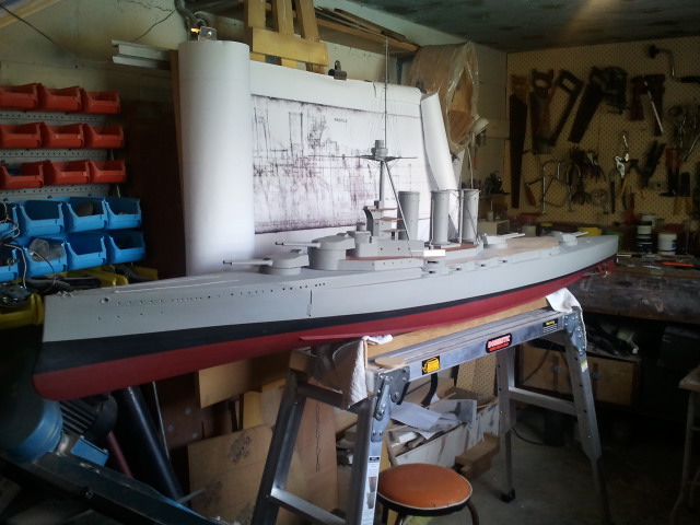

Hi All,
I thought it time I updated on progress. Summer season here has meant long hours at work and early to bed for early starts. None the less, some progress has been made.
This pic is an overview showing 13.5in mains fitted, barrels turned from aluminium and turret structure is ply with plasticard plating. Mast in and rigged to the masthead. The derrick post and No3 funnel  are rigged and rigging is underway on the other funnels. They have to wait for other developments as the deck locations for the rigging are mixed up with other deck fittings, eg the boat cradles. This is where the documentation is lacking and I have to work out as I go. I am awaiting the programmable servos for turret drives.<br /><br />Hours so far approx. 340

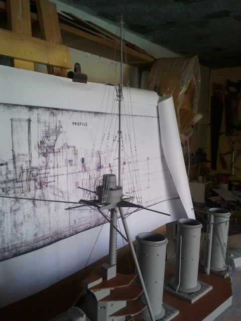

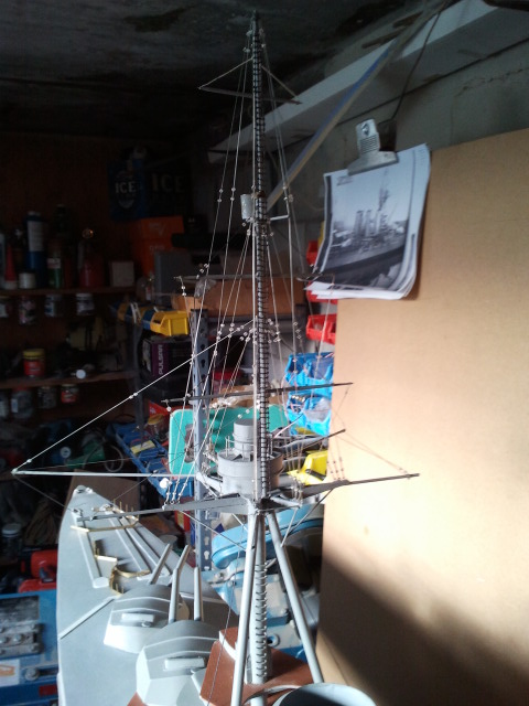

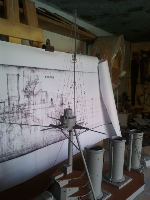

Detail of the mast and rigging so far. All detail on the control top now done, and nav lights (LED) still to be wired and fitted

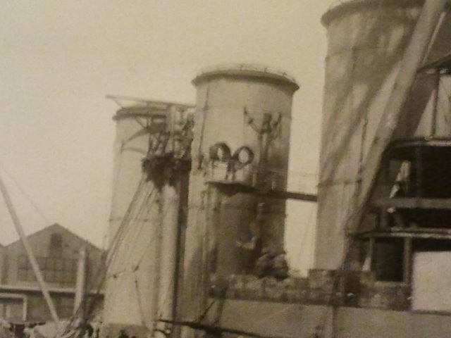

Question ...
I have seen reference to Tiger having 24" Clarke-Chapman searchlights on twin mountings when she was commissioned. Apparently the performance of these was not great and in around 1915 she was re-equipped with 36" lamps
Does anyone have a photo or reliable drawing of the 24"lamps, either on single or twin mountings. A picture of the mounting would also be useful.
In "HMS Tiger at Bay" Victor Hayward refers to the twin "push-pull" mountings being replaced with remote power operated lamps. This shows in the raised searchlight tower abaft No3 funnel.
Searchlights on the bridge tower are the next project; after I correct the 6" mountings (made a blue there)

All of the actual searchlight lamps seem to be of a similar design, i.e. a hollow cylinder lain on its side with a squared-off 'rectangular block' at top.
It is the pedastel or mount where the big differences lie. From what I gather, the pedastel you/we are interested in could be described as looking like two 'F's back to back, the lamp being fixed to the 2 horizontal arms arranged so it can allow the lamp to be rotated back 90? degrees so it points to the side. So you can have one lamp pointing forward while the second can point to the side.
As I said above, I've found clear images of them to be scarce.
Maurice, what are the actual diameters of all 3 funnels in feet? The first is slightly wider than Nos 2 & 3 but by how much?
mauricejob
Posts: 30
Joined: Mon May 13, 2013 8:40 pm
Location: New Zealand
Re: Calling all Lion-class, QM, & Tiger ("Splendid Cat") BC
Post by mauricejob »
I measure the funnels mid height and to the outer edge of the (somewhat thick) printed line, as follows:
No 1; 2-7/32 or 57.6mm
No 2; 2-1/32 or 51.7mm
No 3; 2-1/16 or 52.8mm
At scale of 1:96 and allowing for distortions due to re-copying, that makes the funnels
No1; 17'9" or 5.529m
No 2; 16'3" or 4.963m
No 3; 16'6" or 5.068m
I make an assumption as to realistic dimensions (why would they have built a major item, such as a funnel, to a dimension of inches), it could be argued the funnels actually were in round feet; 18feet and 16 feet in diameter
Hope that helps

Let me correct something about the s/lights, the 'rectangular shapes' (vents?) I said were top and bottom are only on the top of the lamps. And could one S/light point fore while the other points to the side? I have seen it but can't find the image again. But I'm best showing you one of the clearest photographs I have of this twin 24in unit we seek... this is Neptune:

In the many pictures in the book "The Lost Photographs" the lamps can be seen rotated as a unit and individually on the mounting. In one photo the shells are laid right back, ie pointing straight up, possibly for fitting of the lamps (?) Unfortunately they are very small in the photos and detail of the mountings is indistinct, especially as in many they are covered with a tarpaulin.
Interestingly, all the other ships covered in the book have 36inch single lamps, not the 24inch twins.
This shot gives the general appearance of the mounting, another shows the  base to be a cone and others show ather &quot;bits&quot; None show what exactly is between the lamps. I agree with your description of the 'boxes' Note also here that the shells are empty, no lamps fitted as yet.
This shot gives the general appearance of the mounting, another shows the base to be a cone and others show ather "bits" None show what exactly is between the lamps. I agree with your description of the 'boxes' Note also here that the shells are empty, no lamps fitted as yet.

Progress again, after the usual busy season at work, I am back into it. The mast standing rigging is done, some wiring in place, port 6" done, deck planking underway. Also done is the handrail along the port side of the fo'c'sle deck (between the 6" casemates)
I have the R/C system and programmable servos for the turrets. Theses can be slowed to as little as 4% speed and throw increased to 160 degrees. Gearing will do the rest.
The model is now around to bring the starboard detail up to the same stage.
The model out of the workshop to be turned for access to the other side.
Somewhat cluttered pic showing the mast with standing rigging complete. In the interests of pondside durability, the rigging is in .040 fishing nylon which recovers from a knock.

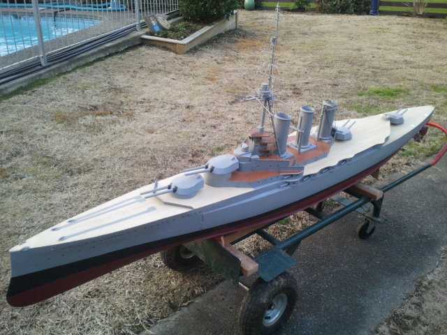

A couple of progress pictures, A local model shop was having a "Social Modelling Day" and I took the ship along.
This pic shows the model on a converted trolley. This is how I propose transporting to the pond, and it lies on this in the  wagon as well
This one shows where most of the more recent work has gone. The searchlight towers are on, most of the bridge work is done, You may be able to see the (unpainted) railings on each deck level up to the Compass Platform
This angle shows among other things, the planked deck, that alone took some 30 hours. I used Basswood (Evergreen product) and stripped it by hand.<br /><br />The small hull is of the tug 'Flying Eagle&quot; at the same scale as Tiger.

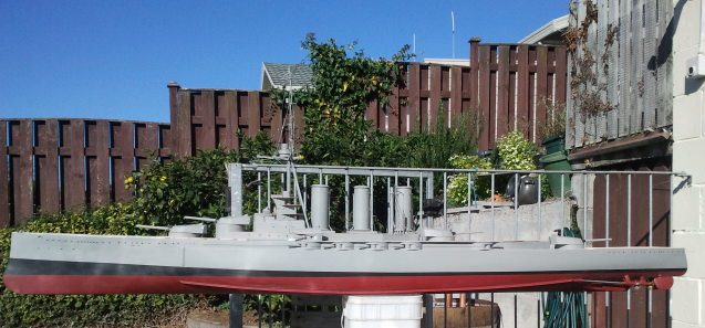

It is time I posted an update! Tiger has progressed as much as expected, at some 800 hours work, the model is nearly complete, it looks complete on the water, but searchlights, and some deck lockers etc still needed. I also have no idea of the appearance of the four coaling winches. Navigation lights are in and tested, smoke system very successful and much detail from the book of photos added.
A quarter bow view which show the overall appearance of the model.
Broadside view which if you can blow it up (shift/control/+) will show you the detail (control/0 restores size to original)

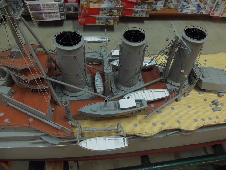

A general view showing the busy midships section including the boats.

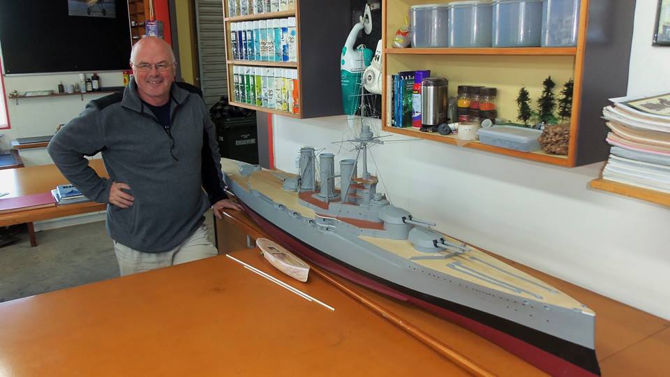

Tiger is now all but finished. There is still some, any probably always be little bits and pieces that can be added, but she has now moved from the workshop to the house.
A recent model boats event was held on one of New Zealands few (1 or 2) purpose built model boat ponds in the town of Hawera, and Tiger caused quite a stir. video of her at the event can be viewed on YouTube at location
https://youtu.be/KkXEyLo1RKM
Performance of the model is great, speed more than enough, turning is good and she is very predictable. The smoke system may be upgraded to generate more, we'll see.
Tiger in her new purpose built cabinet
