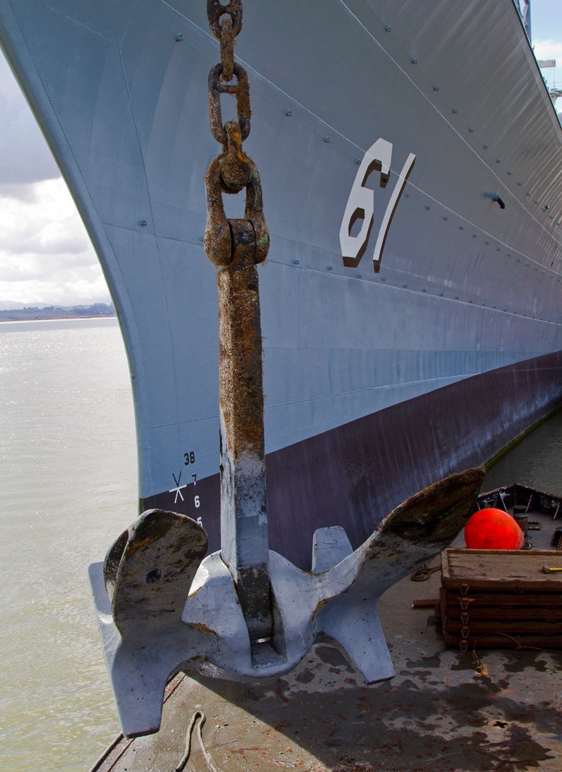

Say, does anyone have a clear shot of the kit's anchors?
I'm trying to work up some connections for my 3D printed chain to the anchor shackle, and a way to include the swivel in the chain... it would help if I could see what the kit provides in that area. TIA!
Also in the works... 1:200 chain stoppers... more later!
File comment: Anchor has its own shackle, then a short shackle attached to a "long link" (which allows the shackle to be inserted through).

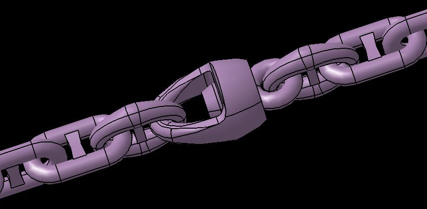

OK, I should have another small batch of 13.5 LPI x 15” bulk chain on my ebay listing tonight. Made a last-minute decision to travel to the Manitowoc show last weekend, which put quite a hitch in my “production process”!
Now, here’s a preview of a new design: Custom chain sets for the 1:200 Iowa Class. The images show CAD renderings for clarity, and actual initial samples.
The sets include:
2 runs of chain for the “anchor stowed” condition:
> 13.5 LPI chain links.
> Correct elongated link and bending shackle at outboard end. The bending shackle can be pinned to the anchor shackle with a bit of .020” (0.5mm) wire.
> Swivel link in the correct position (just aft of the middle chain stopper)
1 sprue with 6 + 2 extra chain stopper assemblies.
> Each stopper has a padeye, turnbuckle, pelican hook, and chain links. The upper jaw of the pelican hook is to be assembled onto the lower jaw, trapping the chain.
Using these stoppers will look better than the incorrect practice of simply using short runs of chain. Placing the pelicans under the chain (three places per side) will lift the chain off the deck locally, an effect which you can plainly see in any photos.
Questions:
> I have yet to see what Trumpeter provides for the anchor. I hope they include the anchor’s shackle?
> Not sure what Trumpeter provides for the padeyes on deck. Separate or molded on? Molded will require removal, and drilling of a 0.040” (1mm) hole for the provided chain stopper.
File comment: Elongated "bending link" and bending shackle, attach to anchor shackle.
File comment: Swivel at inboard end of "outboard swivel shot". From here, the first full 90 foot shot starts.

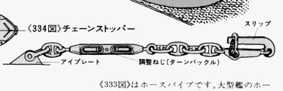

PostPosted: Sat May 24, 2014 9:36 am
Joined: Tue Jan 03, 2006 8:31 pm
Posts: 62
Hey Pat
Is the stopper assembly links movable? I will need to add 4 links toward the U shaped piece.
Bob

Moveable and removeable are 2 different things. I'm working on improving the articulation. Adding links would require a modified design. ..
