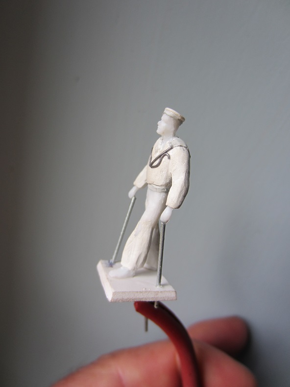

Another feature noticeable on the old photos of RN sailors was the lanyard around the sailors necks. I'm pretty sure they usually had a clasp knife on the end of these, and they were all tucked into their breast pocket. I modeled the lanyard using very fine lead wire. This is very useful stuff available from the fishing tackle shop and normally used for making fishing flies. It's easy to manipulate and sticks well with CA.
The figure at this stage is "getting there" but still needs some fine sanding before being sprayed with primer. This fills the remaining fine scratches, but I had to be careful as too many coats will fill up the detail and take away any crisp edges. As with other work I found the red coloured primer made it easier to see blemishes and errors.
You are probably asking why all the figures have walking sticks! No my models are not going to be crewed by aged sailors. I had previously decided to use these figures as masters to cast figures for some of my other models so the "walking sticks" are to allow air bubbles to escape from the silicon rubber moulds during the casting process. That's the plan anyway we shall have to see if it works in practice.
File comment: The lanyard around the sailors neck has been added using fine lead wire. The "walking stick" is to aid air escape when the figure is cast in resin.
File comment: The figure has been mounted on a plastic card base with sloping edges.
File comment: The figure has been sprayed with primer. This fills the fine surface scratches and gives a good surface to form a mould on. This figure will eventually hold a boat hook.
File comment: Secondary cuts had been made into the mould to meet the out stretched arms and "walking sticks".
File comment: The two mould halves fitted very neatly back together and were secured with three rubber bands.

Hi all
Here you can see the secondary incisions into to RTV mould (at 90 degrees), which make it possible to extract the figures with out-stretched arms and "walking sticks". Next I pour resin.
File comment: The secondary incisions into the mould.

Hi all
Well this is the moment of truth. You never really know how well these moulds work until you try them out.
I poured the resin and increased the pressure pot internal pressure to 50 psi.
Not bad results in the end. OK so it's not exactly "Games Workshop" quality but for home produced figures they are not too bad. There was a small amount of very thin, and thus easily removed, flash along the mould seam. The "walking sticks were very easily removed with small side cutters. These served their purpose very well and there was no loss of limbs.
Beards and chins are a slight problem with small air bubbles trapped under the figures chins on some de moulds. A fine incision in the RTV mould,vertically under the chin allowed the bubble out. The resulting "web" under the chin was easily removed on the de moulded figure.
File comment: The first figures out of the mould.
File comment: Some fine flash was left along the mould seam.
File comment: The "walking sticks" served their purpose.
File comment: The "walking sticks" were removed with small side cutter.
