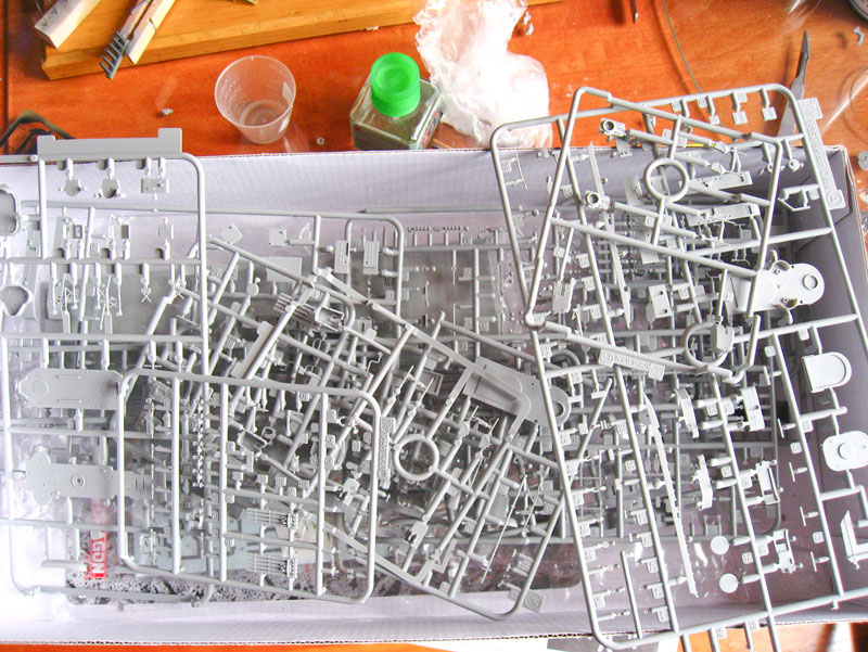

File comment: There are a TON of parts in the box (and this is with the hull and main deck sections already removed)

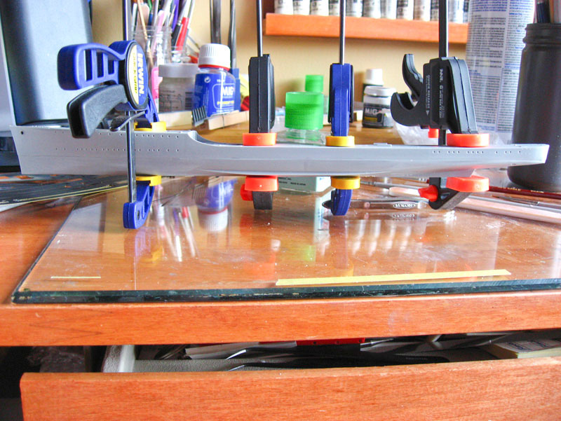

File comment: Everything glued and clamped together. I took a little finesse here and there to minimize seams between upper and lower hull, and around the main deck edge, but doing so results in very little putty being required when fill-and-sand time comes.

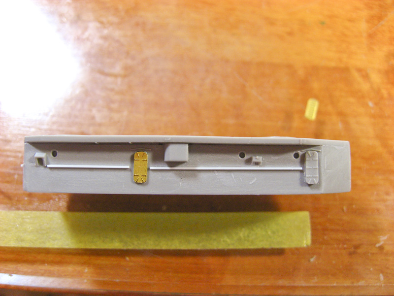

As I predicted, I ended up sanding off the molded in hand rails. They just didn't have enough of a 3D look to them. I'm using some .5mm round styrene strip to replace them. It's tricky work getting the strips lined up and then putting on enough glue to hold them in place, what not putting on too much that'll run, puddle, or warp the fine strip.
As far as the doors go, I'm stuck. The one on the right is the molded styrene version, which snaps wonderfully right into the opening. The problem is they stick out a bit too far and are overscale.
The provided PE doors look good, but they're just a hair too small. It takes a good two minutes to line each one up in place (try taking that much time with even a slow drying glue like Gator Glue), and then they don't quite cover everything. In the photo you can see there's a slight gap at the top.
My third option is to try aftermarket PE doors, but as luck would have it, from the literal dozens and dozens of envelopes of 1/350th scale WWII photo etch I have in the house, not ONE is a door set.

Actually, one more photo tonight. After walking away and coming back with fresh eyes, the styrene door doesn't look that bad. A little thick, but under that overhang, with railings and other details between it and the viewer... Plus,using them will save me literally hours of work. The brass door is thinner, but not by leaps and bounds, and I'm not one to use PE just for the sake of it.
I'll sleep on it, look again in the morning.
