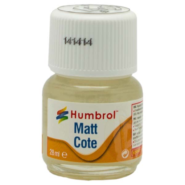

Attaching vertical lines to horizontal antennas should only be done using Matt varnish as an adhesive-otherwise the longitudinal will melt and snap if poly cement is used..
Jim when you say a Matt Varnish are you referring to a type that would be used for wood or matt clear for plastic? Thks kevin

I use Humbrol ' Matt Cote ' ( the one in the glass jar ) ( image below )
thinned with white spirit ( less aggressive than Humbrol Thinners )
==> high grab, quick dry
allows a little bit of adjustment as well.
