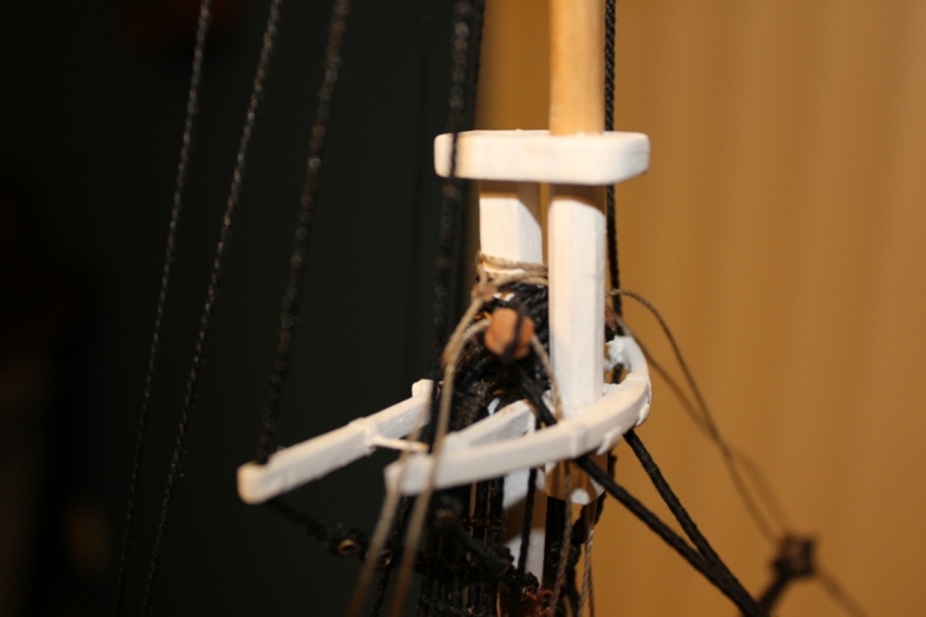

These are photos of the "bow like cross trees". I do not know how to attach shrouds from the cross trees at the top of the photo to the bow structure, or even if there are any. Lee's book does not say.

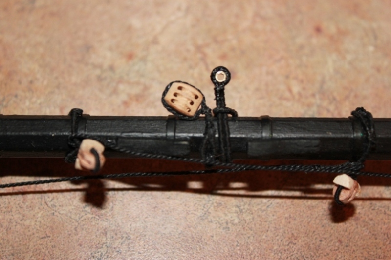

I have been working on the yards a lot lately. There is a lot more to do than I remember from my Victory Model 30 years ago. I am trying to get as many blocks as I can on the yards before installing them. As this ship will not have sails, I do not need the leech or bunt line blocks, so I will be leaving those off. Everything attached to the yards needs to be served, and attached primarily with rose lashings (or a close approximation). I made the slings as you can see, and I am making the trusses now (no photos of those yet). I am also putting on shrouds at the top gallant to royal yards tressel tree. I will post photos of how I attached them later. I also made and sort of installed the spanker and gaff booms.
I apologize for the messy deck, I will vacuum it clean when I finish installing the yards. Once the yards are done, I think all that is left is the anchor assemblies, the davits, and the ships boats???

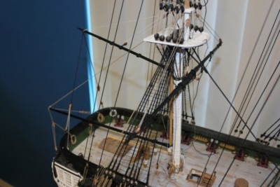

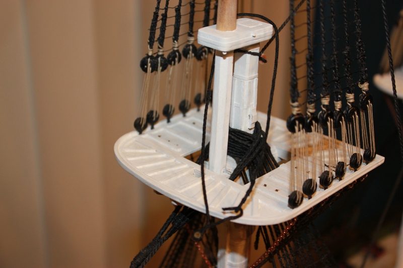

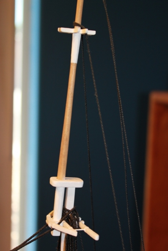

Thought I'd post a few more photos. It completely slipped my mind that I had not rigged the topgallent to royal rat lines on one side!! How do you forget things like that? At least one photo shows parts broken away, I had to do that in order to make the rigging to the fife rails easier. Also I should have done the ratlines I mentioned BEFORE I put up the yards, but, I was itching to get them up after so long, so I hope I can be forgiven? If you look at the photo of the fore mast as apposed to the main and mizzen, you can see where it would have be MUCH easier to do the ratlines earlier. Now, I have to work around the yards and the rigging. Ah, well, live and learn, right?
