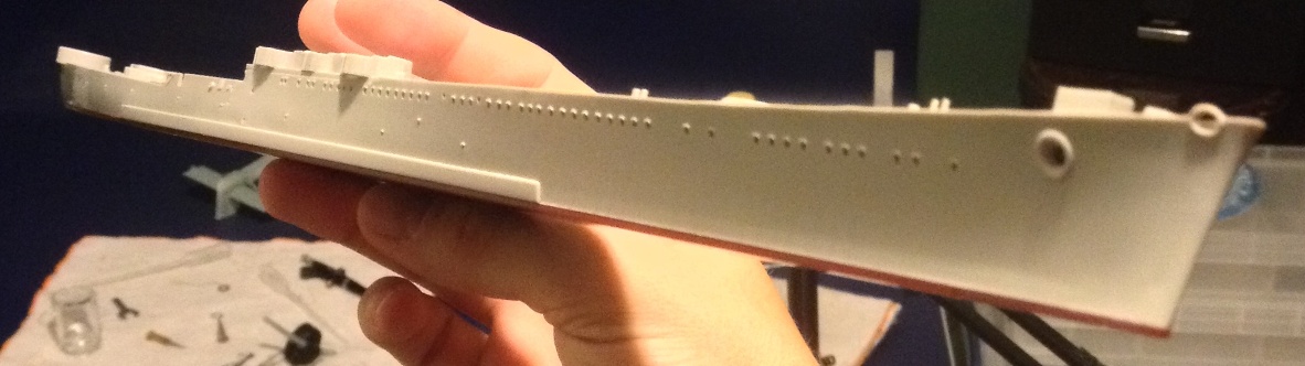

I removed the horrible propeller guards, chocks, molded on anchor chain and leadsman platforms. I also drilled out the hawsehole, the tow rings, and a very tricky angled drilling for the anchor chain on the fo'c'sle which broke one of my drill bits in the process.
Everything you see has been glued on. In order to make the decks flush to the top of the hull I could not use the placing lip inside the hull, but I managed it alright I think.

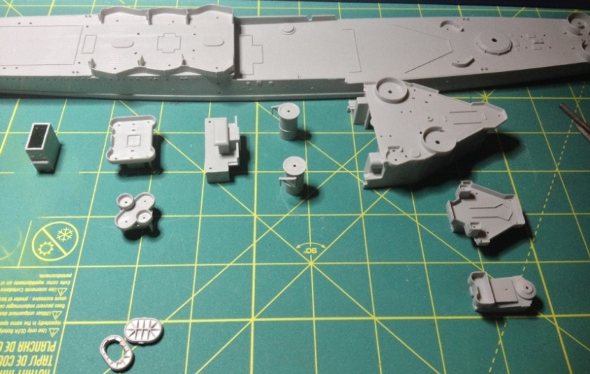

Posts: 1381

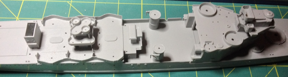

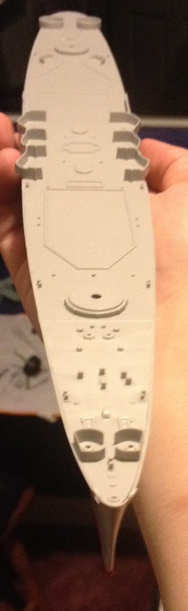

Finally have some updates to show on her. Just doing sub assemblies right now. Seam filling still needs to be done still and I am starting to work in corrections that need to be done to the kit.
File comment: All the sub assemblies so far
File comment: Dry fitting them to the hull

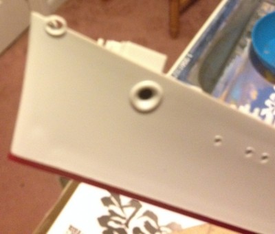

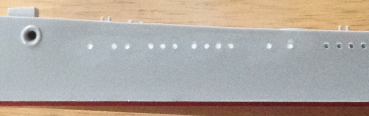

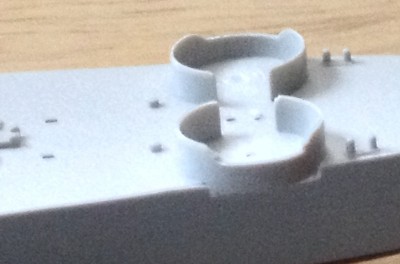

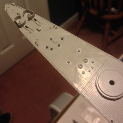

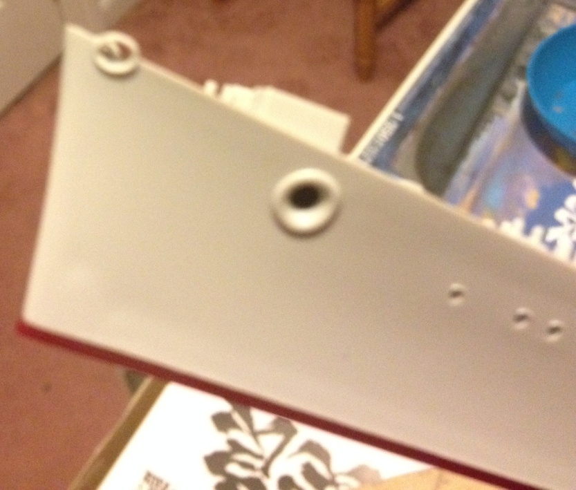

I am going through and cleaning up seams and correcting some minor inaccuracies in the kit now before progressing further.
File comment: Filled the forward portholes as they should have been plated over.

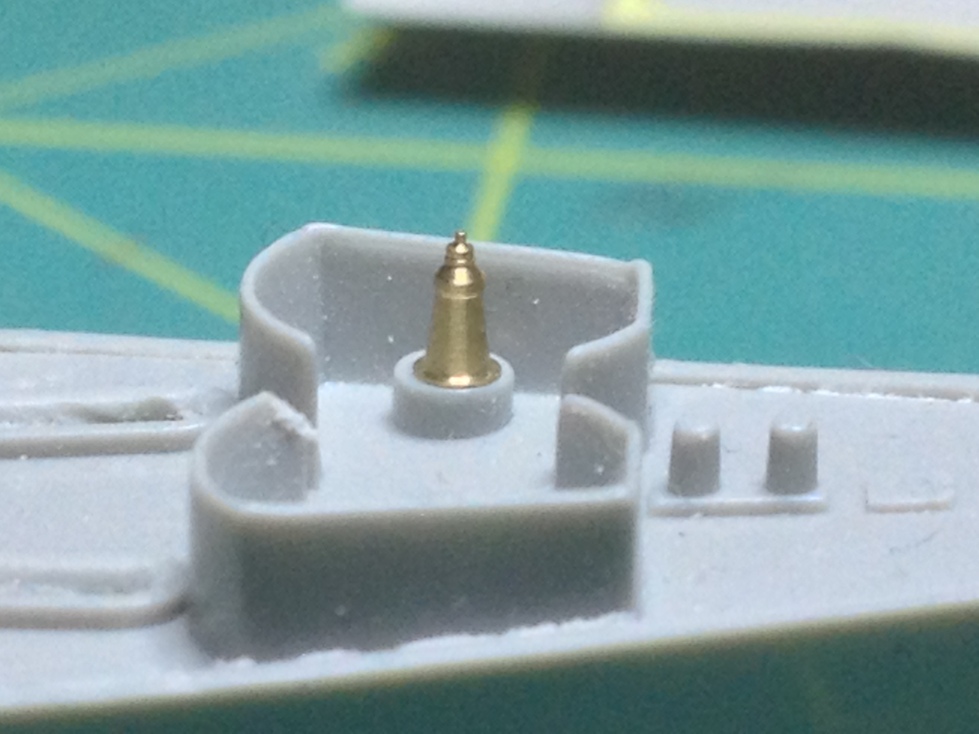

File comment: Looking at the photos and using the Veteran Quad 40mm replacement guns I realized the molded on riser for the aft gun tubs was way to high. I ended up having to remove them all together and lower the splinter shield itself for the dip you see that faces outboard.

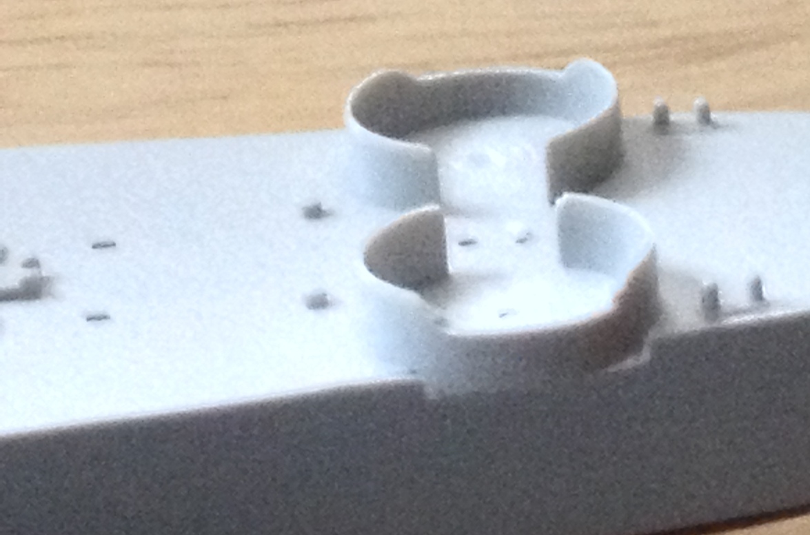

File comment: The seam that is between the portholes and the splinter shields for the 5"/25 guns has been a challenge. More to come as I get this cleaned up.
File comment: The plastic section under the 20mm base (Master Models) has to large a circumference, but the hight might be close. I will check other photos on this. The nick in the splinter shield is because I remember seeing a photo that showed that side rounded down on her in '44. Now I cannot locate the photo again to verify. If anyone has information either way please let me know.

Gabriel,
Can't find any photo showing the 20mm tubs on the bow that really show that area clearly. You also have to be careful as these were not always matching from ship to ship. I am now slightly convinced that they were not symmetrical mirror images of one another. There are two up close shots in the CW pictorial 5, one right after they were installed and then another that is almost identical taken in November of 44(this one is on Navsource). They appear to be almost identical except the starboard one appears to have an additional facet on the forward inboard side that angles inboard. You can see in the 11/44 shot that they had the riser step for the gunner around the base of the gun, but they are absent in the 2/43 shot. Possible they were not installed until 11/44 when the tripod mount was installed in those tubs. You made the 40mm tubs look good, only issue is I believe that to be a 11/44 refit addition as well. The kit tub appears to better match her initial 2/43 refit that she operated with until overhaul in November of 44. That seam might benefit from some MR. Dissolved Putty. I like using this where seams are hard to sand, often after a few thin applications and some smoothing with a Q-tip will do the trick. Plus a slight seam may give some tooth to some weathering there especially disappearing under her very dark MS21 paint scheme for this time period. Glad to see you back at work on her, looking forward to seeing further updates.
