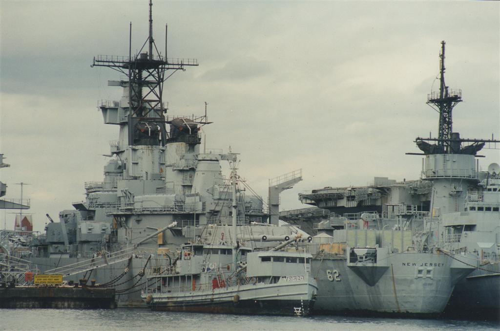

Looking good!!! Here is a shot of NEW JERSEY's port fantail tub in 1999 (In Reserve, Philadelphia):
Don't know if this will help you or not! Perhaps you can copy it and blow up the tub area.
