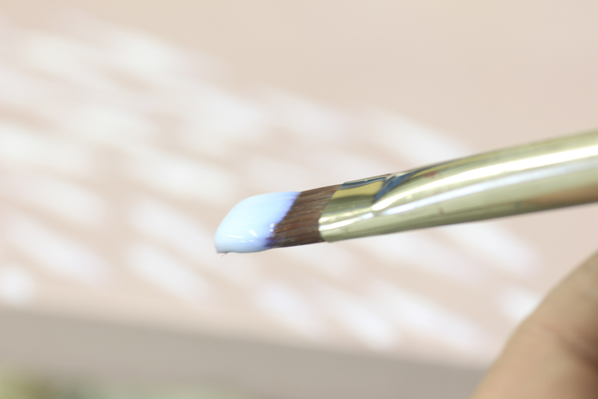

To create the wavelets, I used the following technique:
Artist's acrylic gloss medium has a unique viscosity and behavior to it that makes it perfect for making calm, undulating wavelets. The consistency is somewhat like white glue, but a little more runny. You don't want it running like water, but it has to hold it's bulbous form after you apply it. It self levels, but holds it's shape in a rounded way. This is what you want. I recommend using a high quality gloss medium; either Golden or Liquitex. A cheaper brand might dry with slight wrinkles or splits. Test first.
I use a flat synthetic brush that is about as wide as my finger to do this.

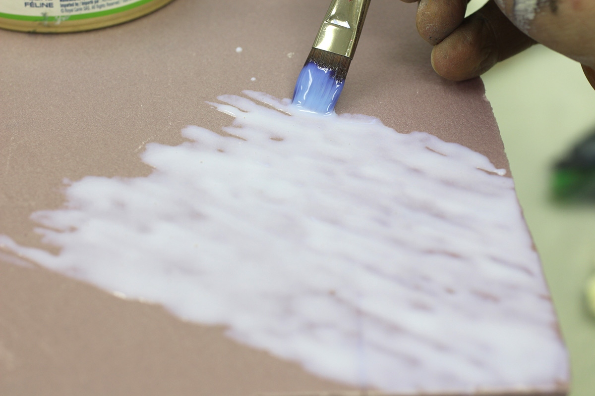

I load up the brush with a fair amount of medium. It has to form a blob when you put it down. The medium will shrink a fair bit once it dries. Make good, mounding blobs. Don't attempt to accelerate the drying process by using a fan or hairdryer. The blobs will split and ugly things will happen. Also, don't fiddle with the blobs once they start setting. Scabbing and other unwanted skin-like things will happen. they're hard to get rid of later.
You are now going to create a series of eye-shaped blobs onto your flat ocean surface. Each end of the eye-shape should trail off. Ensure that they are running parallel to each other. You might draft out some pencil lines to keep things more or less square before starting. At this point, the eye-shapes must not touch! keep them about a half an inch from each other.
In theory, this is all fine and perfect, but in real life, your blobs will sometimes deform over time as they sit due to gravity and flow. Monitor your blobs at all times and make little corrections to them. One thing that does happens is that a part of the blob will flatten out into a round bulbous circle in the middle or end of your eye shape making a tadpole shape. This is something to be avoided as it just doesn't look water-like in the end. It's a simple matter to just brush on either side directionally with the other waves to smear off the offending bulges.
You are not trying to cover the whole sea, just put down as many as you can without having them touch. Note that the medium will spread out a bit so allow space for this spreading. Again, they must not touch.
Once these are dry, you are going to add more eye-shapes in-between the ones you put down. It doesn't matter if these touch the dry ones.
