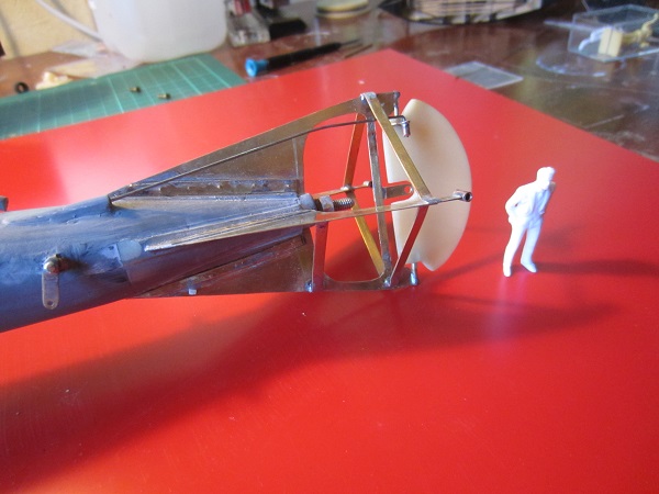

Photos of these C vessels show a series of �eye ring� bolts along the deck edge. These seem to be for securing mooring lines and other cables and ropes to avoid them breaking free and fouling the prop (a constant worry on these and any subs). These �eye rings� were made up from 0.5mm brass wire wrapped in the usual way around the shank of a 0.5mm drill bit. Side cutters remove the surplus wire. Soldering them closed is a good move particularly if they secure rigging or cables which are pulled taught.
The activating arms for the aft diving planes were made up from 0.4mm brass. These will eventually be brass PE components. They were then tinned and fitted onto the already installed shaft protruding from the aft of the hull. A large soldering iron was used to QUICKLY solder these in place. I did not want heat to travel into the hull and de solder any internal connections. The surplus brass rod was then carefully trimmed off and filed smooth. You will see that the two activating arms each point in different directions, up and down, just like the prototype. They will eventually have connecting rods joining them to the diving planes.

The fins, rudder and aft diving planes were a little complicated to work out, but not beyond me. I had to cut out the fins from 0.4mm sheet brass using a jewellery saw, carefully referring to the plans and photographs available. I already had the rudder and diving planes as cast resin fittings. These brass fins were then measured and drawn out to be eventually part of the proposed brass PE set.
The fins were strengthened, at the point where they meet the hull, with brass strips. These strips were placed on a piece of hardwood and gently punched on the reverse side to create the rivets seen on the real vessel. These matched up with the line of rivets and mounting strip cast into the resin tail piece. These reinforcing strips were then soft soldered in place. The completed fin was then glued in place with its locating pins inserted into the holes previously drilled in the resin tail piece.
A note here on soldering.
I cleaned each component with emery cloth. Flux was painted just where it was needed using a small paintbrush. Soft, fine, wire, electricians solder was used throughout. A large soldering iron is essential, the idea is to heat only a small area of the brass component (enough to get the solder to run) but not let the heat travel, so you have to have the components clamped in place, and you have to be quick. Small metal crocodile clips are very good for holding small components in place while soldering. Try and tin at least one of the surfaces before dry assembly. If you are working next to previously soldered joints or resin components you have to work very quickly before the heat de-solders the other joints or damages the resin fitting.
Hi all

Just aft of the prop is a vertical post joining the top and bottom fin and carrying the centre of the hinged diving planes. This was also made of 0.4mm brass. The ends were bent to have a slight kink so that it would align with the fins. A centre support was then soldered in place to carry the diving planes. The hole was intentionally drilled slightly too large to make the later installation of the diving planes easier. The pictures show this vertical post and its final installation. The picture also shows the strengthening struts which tie the fins together. There are four of these and two smaller ones beneath each of the horizontal fins.
Small bore copper tube has been soldered to the end of the two horizontal fins. This will be the end bearings for the aft diving planes.
The brass prop in the picture was the right shape but slightly too large at 35mm diameter. A 30mm one is on order to replace it. Pictures and plans confirm the vessel used a four blade prop.

The cast resin rudder was now "offered up" to the stern fins and associated frame. The resin rudder had to be "fettled" slightly to get it to fit. The cut out to allow it to clear the diving planes had to be filed out and slightly enlarged.
The rudder was then drilled carefully out top and bottom to accept two brass pins, each had a large flat filed onto it. These flats will be soldered to the tip of the fins and the pins will act as the hinges, the rudder swivelling on them. The control horn on the port side of the rudder was cut from brass sheet and drilled to take the 0.5mm piano wire control rod. A thin cut was made in the rudder casting and the brass control horn was glued into the slot. A small slice of plastic tube (from inside a biro!) was pushed over the lower pin to act as a thrust bearing.

Anyway Hi all
The rather complicated stern fin section of the sub is coming together. The aft diving planes are next. These are also resin cast fittings. A certain amount of re carving was required particularly around where they come close to the rudder. The resin is easy to carve with a craft knife and file. I had to ensure they didn�t foul the rudder and visa versa. At least they were slightly too large rather than the other way around!
Like the rudder the planes were carefully drilled (on their outer edges) to tale 0.5mm brass pins to act as hinged. On their inner edge, the single brass pin travels through the hole in the stern frame pillar.
Slots were also cut in both planes to take small brass control horns. These were again made from 0.4mm brass and were pushed into the slot, where they were glued in place. A small piece of 0.25mm styrene card was pushed into the slot behind each one, indicated with a blue arrow. Remember the control horns have to point up on the starboard and down on the port side to match the control arms . This styrene was trimmed and filed smooth when the glue had set.
After dry assembly and checking that it all worked, the two planes were glued onto the centre brass pin after threading it through the stern frame pillar. The two remaining brass pins were inserted through the small copper tubes and carefully glued in place to complete the hinge mechanism.
So far so good. Everything moves freely.
Anyway Hi all
