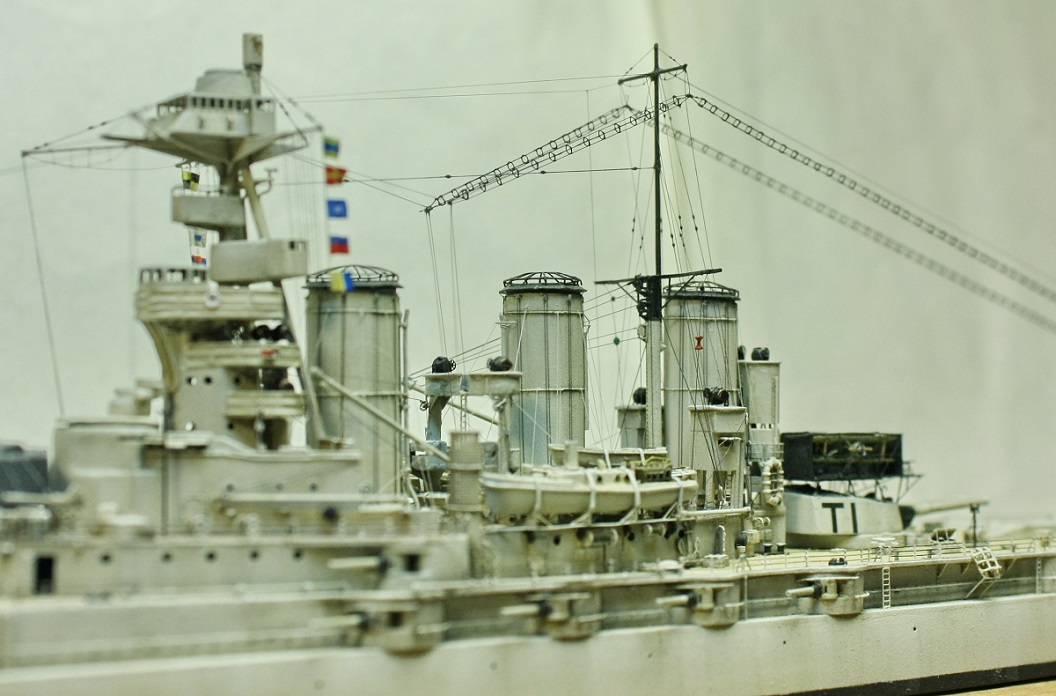

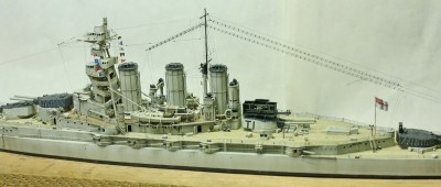

Then came the though part: cage aerials.
I tried my best to make them subtle and have to say that I failed.
David Griffith calles them the Holy Grail of modelmaking and advises to use lycra for the longitudinals.
I found it impossible to do in this build as the cage aerials are not continuous between two hard points and lycra needs to be pulled thight. I used stretched sprue instead and not the finest I could pull because a simple jig was utilesed to fabricate the aerials and even this way they were slightly damaged during handling (the longer aerial is 8 cm long!).
Tiger had late-war type, small diameter aerials in the period depicted and this fact didn't make my job easier at all.

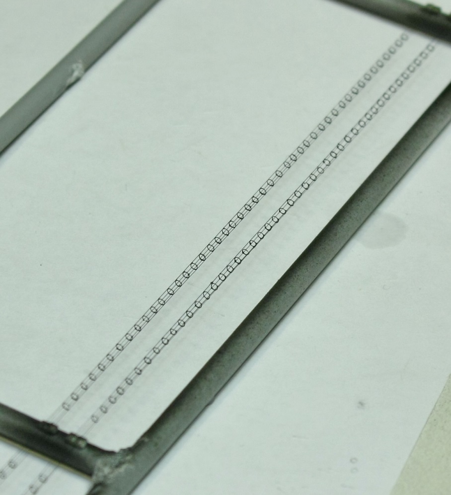

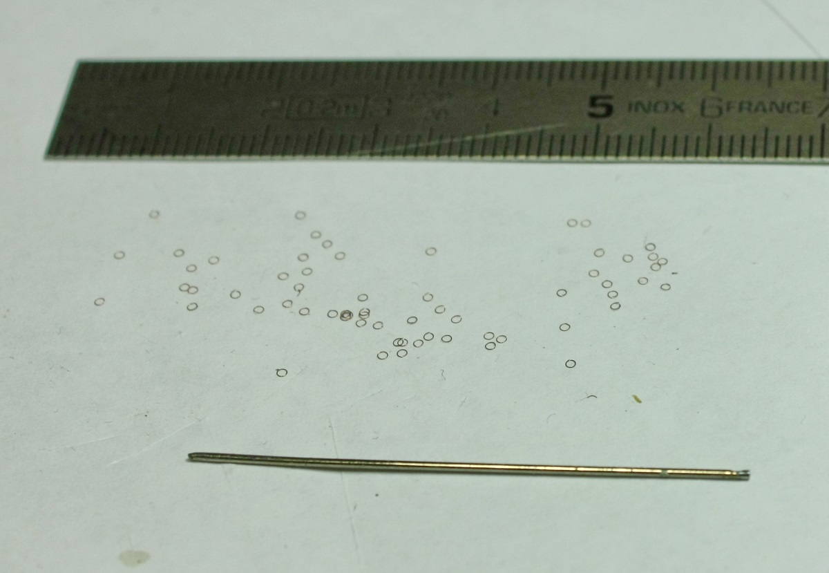

First, really fine wire had to be used for the spacers and there's a lot of them.
A picture helps to understand why I have opted for scratchbuilding the spacers instead of using ones of the WEM set:
(Here the contruction method can be seen: the spacer rings had been glued to two lines of stretched sprue,
then blocks have been attached to the jig and two more lines placed above them completed the assembly)
Second, the small diameter and big number of spacers made the aerial look "dense" despite my effort to produce something really fine.
Third, the spacers had to be painted black which thickened the whole assembly further.

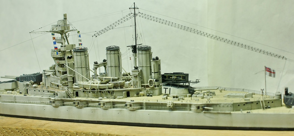

While still on the jig I pulled three of the lines together to form a cone - this is how the cage aerials end.
It was a real pain to attach the aerials - their positioning means that this job is not for beginners.
(note how they are attached to the yard)
To align both sides and fix the after aerial was another test of my dexterity.
In all, I am quite dissatisfied with how they turned out: too evident, too thick and grossly oversize.
I'm sure Jim Baumann would agree. I just could not leave them out and still cheated with their diameter
(one with the right diameter would have looked even denser with the lines being closer together).
I guess at present this is as the best I can do :(

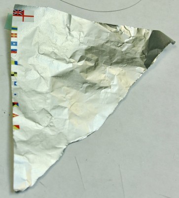

At first I attached the flag decals to a piece of aluminum foil to facilitate folding to shape.

PostPosted: Mon Sep 28, 2015 4:04 pm
Posts: 5588
George !!
Thank you for thinking me as a rigging enthusiast! :wave_1:
I have pondered your photos most of the day whilst at work, eating, driving and now in front of PC with a cup of tea !
and have also pondered if I ought to say anything...
Your methodology of producing the cage aerials most excellent.
The consistency and sharpness is very very good indeed-- as I would have be expected from you..! :cool_2:
BUT... ( here goes! )
in my opinion- and ...please disregard it as my biased view if you wish... :big_grin:
is that possibly your dissatisfaction with the end look is that you think they look heavy-
I think this is less so because of the yarn/line gauge,
--but more so due to the frequency of the spreaders...-- in 1/700 I think...' less is more '
--even if it does not equate to scale distances
and possibly because you used PE spreader rings --
==> which will always look heavier than home-made circles of very fine wire
( try using stainless steel or tungsten wire 0.04 mm ( ( available from little cars.com ) ) - coloured with an indelible marker pen
( I think David Griffith made his own rings also for his Cumberland model )
link http://www.modelshipgallery.com/gallery ... index.html
My reason that you could ignore all my thoughts on this ..is ...
that though I made cage aerials back in 1999 on my Dreadnought model - in Lycra ( they were however 1/350 )
to my shame I cannot pretend to have made them in 1/700

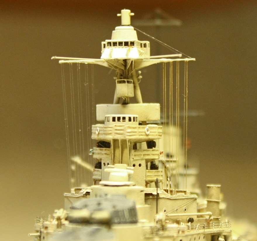

Apropos Lycra..
I took the excess tension out of Lycra thread when rigging and for making cage aerials by colouring it FIRST--using Indelible marker pen and wrapping it on small cardboard tubes- ( toilet roll centres) - the marker pen reduced the elasticity by around 75% and made handling much more predictable...
and ten making the aerials
but see below a quick snap from this evening--through the glass case of my old Dreadnought model...
The frequency of spreaders is perhaps- in retrospect- somewhat tooooo minimalistic...(!) ha!
but the overall effect does look " LIGHTER" ...
waddayathink...?
JIM B

Hi All,
'Long time, no post'... But I've been here, lurking in the background.
Fabulous work on Tiger... Exceptional. I too struggled with cage aerials... my main issue was getting the tension right without damaging masts and yards (which didn't really solve) and getting the 'lightness' right, which I think I did to a degree... Here is my post from 2010 (if it works!)...
Bill Livingston wrote:
Made another four or five cage aerials but could only use two of them. The frustrating thing is, all were quicker to do than the first one, but, as they were longer, it was much more difficult to get the same tension in each mono line. They also needed to be stretched quite hard in order to take up the correct shape. Because I had opted to mount them as they are in the real ship.. i.e. not directly to the upper yard arm but on a downline attached to the yard, the tension required to get everything in the right place has resulted in the upper yard bending quite dramatically. I have only managed to mount two of the required four... so when I do the other side I can even up the mainmast again... but I will still have to tackle the amount of force on the upper yard arm. There are two lines supporting the yard and If I put a bit of tension on that it will straighten a little... but there is a LOT of force on all the aerials in this model.. so it going to be a bit of a gamble that they will not pull the mast apart eventually.... The lines are considerably stronger than you would think looking at them. Anyway... despite the negative points they look really good and I have got as close to 'in scale' as I can get. Damn difficult to do though!!!
EDIT: Here is a picture of the last of the four cage aerials on the jig... As long as this doesnt collapse when I cut it free thats it... all over. I think the results so far have made me feel it was a worthwhile excercise but it was much harder than I thought to find a method that works and allows you to build something this small, consistently. I think I will avoid cage aerials in the future!!! :Mad_6:
The last of the four...
Three quarter view.
And another... side on...
I still have the downleads from the arrays to do and all of the other side... Hopefully I will get that finished tomorrow... Phew! And this was supposed to be an easy build to get me back into this!!! Great model from Combrig and its lovely to build.... but I think I have made it more of a chore than I should have done... Ah well... I have learnt a lot! :smallsmile:
Bill
I managed to finish it... eventually. You can find the whole thread on here... The cage aerials still look good five years on, but I really should replace that top yard one day... Anyway, here is a picture of the cage aerials complete... I'm still pleased with them... but at 700 scale they are not easy...!
Bill Livingston
Cambridge
PostPosted: Thu Oct 01, 2015 4:35 am
Posts: 2621
Fantastic work George!!! :worship_1: :worship_1: :worship_1:
With a model like this, I won't lose interest quickly... :)
Regarding the cage aireals, IMHO among the three models Bill might have found the best balance between realistic distance between spacers and lightness. But the regularity of the spacers and finesse of work on yours is simply amazing, so I would just leave it as it is.
Many thanks for the step-by-step by the way!
Almost ready to put the two ships in the water together? :)
Marijn
PostPosted: Thu Oct 01, 2015 5:05 pm
Posts: 625
Location: Budapest, Hungary
Nicolas, thank you much! I think your work is what's really exceptional.
Jose, I have limited space at home which was the main reason (besides many other causes) why I haven't built anything in 1:350 yet.
That (I mean the space available) might change however in the not-so-far future and then, who knows, I might tackle something bigger...
Bill, when I commenced this buid I have read your thread and stated that yours were the finest cage aerials I have seen in 1:700. I think this statement still holds true...
Marijn, thank you! First I need to provide the ship with a crew then I will put both in the water.
I hope I can show them at Telford.
