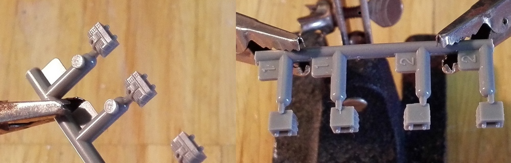

I wanted to share my findings about the Fujimi 1/700 Chokai kit that I am building right now, perhaps these might be of interest to someone. The kit overall is really nice but there are some quite surprising flaws - considering you would expect this to be the most state of the art kit of the ship on the market:
1. the aft funnel is shaped incorrectly, it´s back being molded straight while it should be curved – this would be quite difficult to correct but at the same time it will be probably not much noticeable on the completed kit. Funny enough, the Fujimi 1/700 Takao and Atago kits (that were released earlier) have this right!

2. the back side of 120mm AA mounts is molded flat with no detail of the gun - this can be scratch-built or the whole mounts can be replaced e.g. by those from the PitRoad IJN Vessel Equipment Set 3. It is really a shame as the mounts are really very nice from the front and sides!

3. torpedo tubes have no torpedo warhead detail, they are just flat - if you want to show them trained to the side you need to add detail or replace them e.g. by the corresponding Pit-Road set. Again a totally uncomprehendable error on otherwise a nicely detailed part :( BTW it is also problem of the Fujimi 1/700 Tone/Chikuma kits, but it is ok on the Yukikaze kit. Why can it be done right on some kits and not on all of them?
