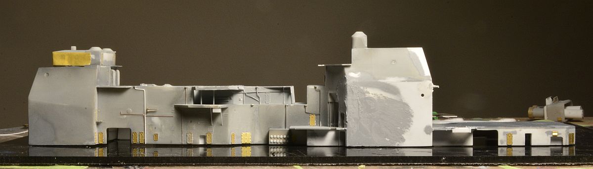

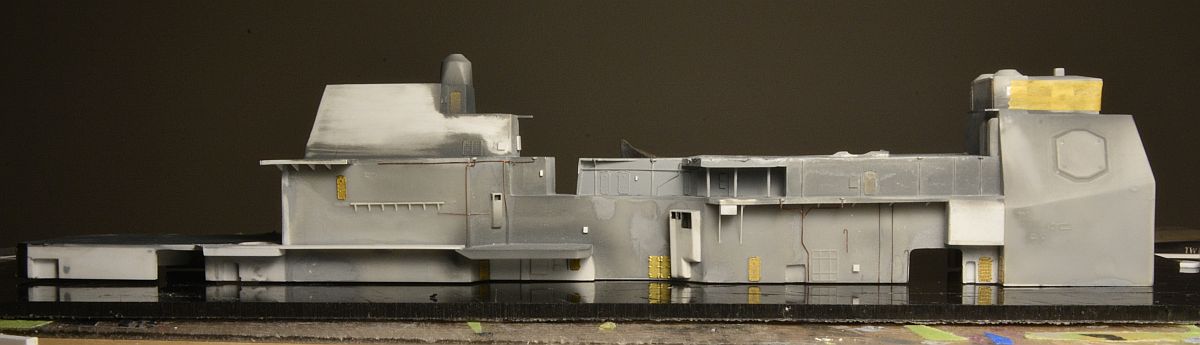

Hello everyone!! :wave_1: :wave_1:
It took me a bit of time to remove all the cobwebs off this post. It's been 5 years after all!!!! I do feel a bit ashamed, but that quickly fades because
- 1: I was busy building other Navy stuff in the meantime ( helos and jets)
- 2: I am staying thru to my word, and continuing this project until finished
I hope there are other CG fans out there, because based on the number of finished projects found by multiple Google searches doesn't paint a pretty picture. Let's post some more photos everyone. :smallsmile:

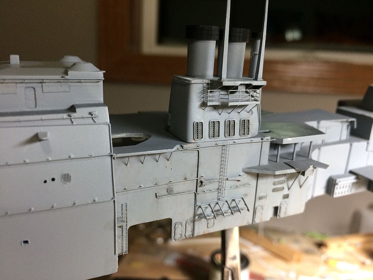

My take on the project is very complicated (what a shocker) and required numerous adjustments to parts I built 5 years ago... As more pictures of the real vessel come to light, the more I realize how off I was with some stuff. It's not just that these CG-s are almost all different from each other, each ship also goes thru upgrades and changes over its lifetime, so one really has to pay attention to the dates. Now it's decided finally: I am building my Vincennes as she looked in 1991. This move resulted in removing a bunch of platforms, carefully constructed previously....
I was FINALLY able to install the hangar ( one SH-60b is parked inside folded) , the superstructure is almost ready for paint, and got the funnels prepped for spraying too. Funnels: They looks so much more realistic if one adds more piping into the funnel housing to extend the overall length, and it pays to grind away those thick edges around the top of the stacks.
These ships have very extensive network of pipes, sprinkles and drains, which fact is often overlooked by most modelers. I intend to replicate just about every individual pipe. They add soooo much to the overall appearance!
all right-all right, enough droning on, here are some illustrations :heh:
Happy modelling: Laci

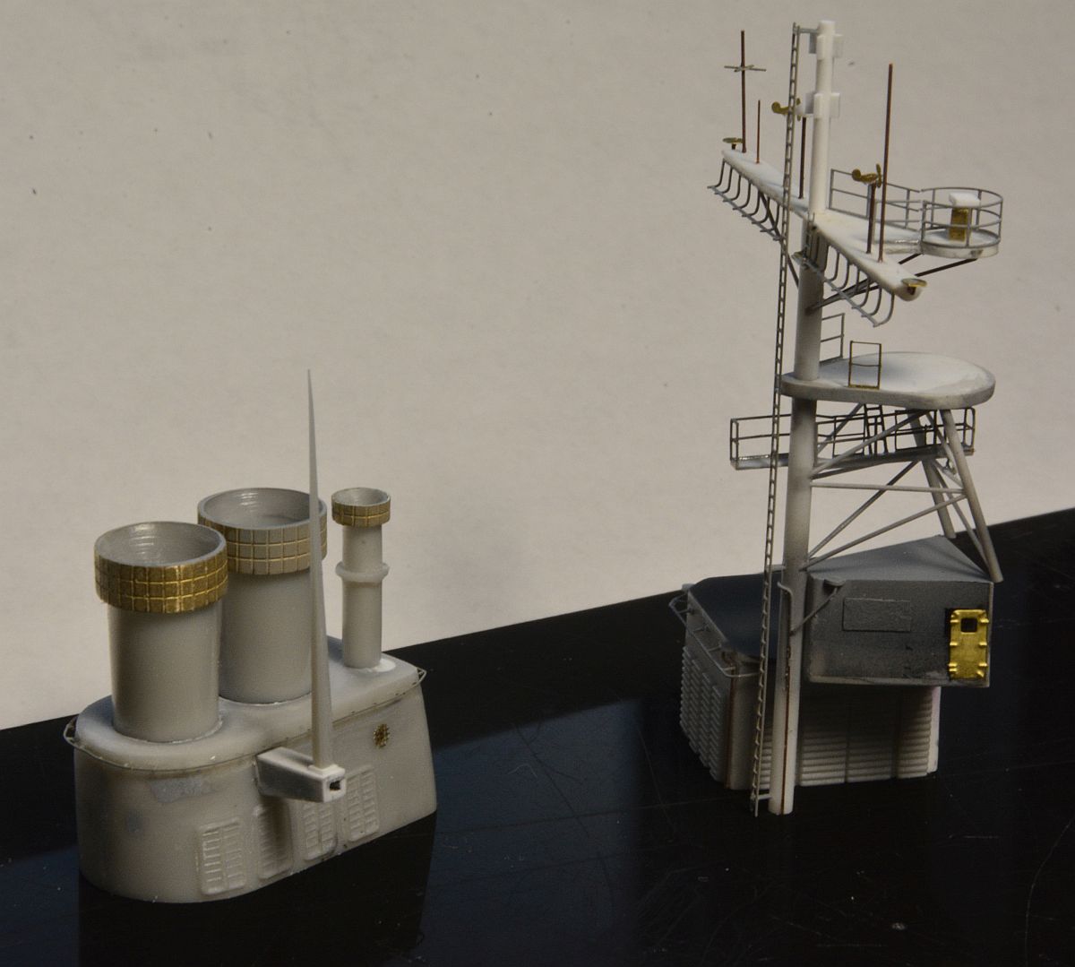

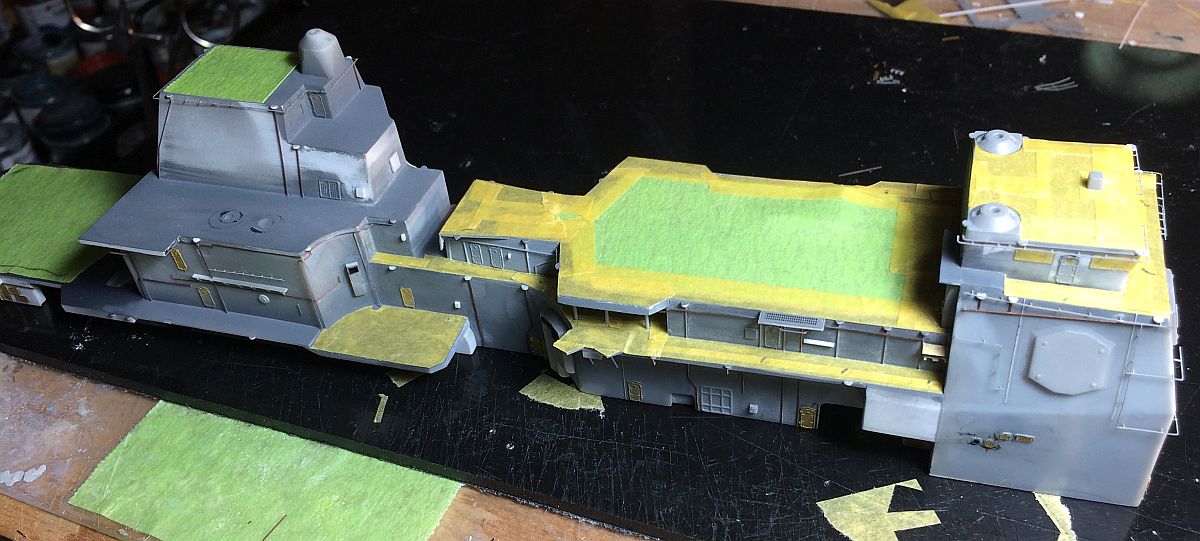

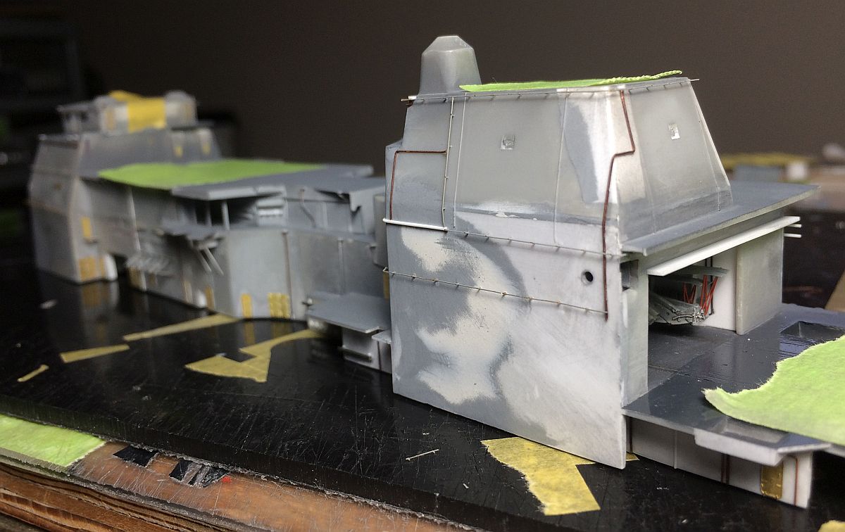

Alright! Here is the reason why I haven't posted anything in a while: I was busy trying to represent all those pipes and sprinklers on the superstructure. It was painful, and it's not even as nice as it could be, but I do want to finish this ship in this lifetime. ( and a few others) I do like the results, but it could always be better.
A lot of the details still can't be installed until the superstructure is secured to the hull, so there is a lot more plumbing coming!
I used different gauges of wire, and trimmed down railings to make the piping.
I also started masking, that's gonna take a lot of time too. But once it's all sprayed grey, I can finally start adding a lot of cool stuff!
Cheers: Laci

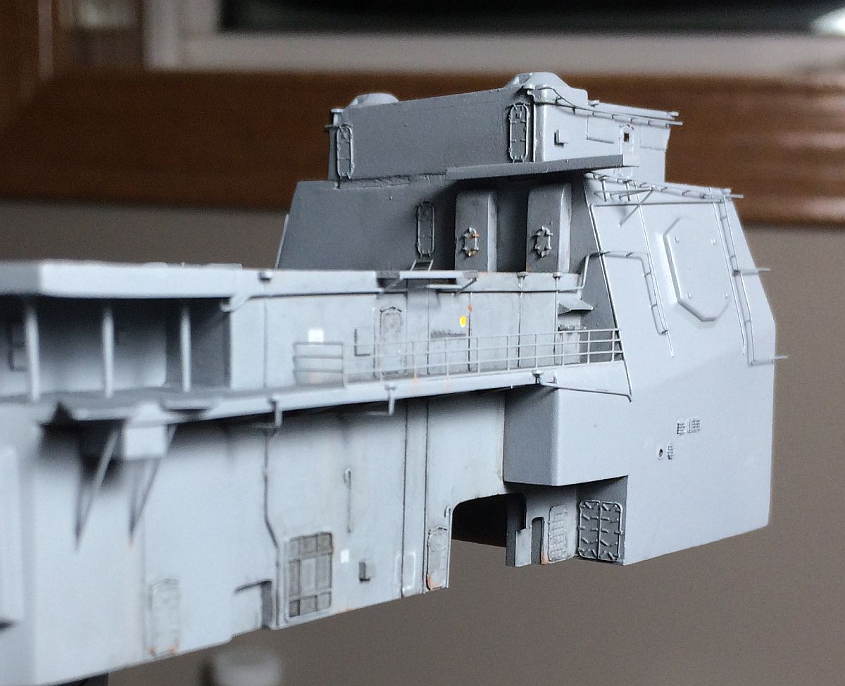

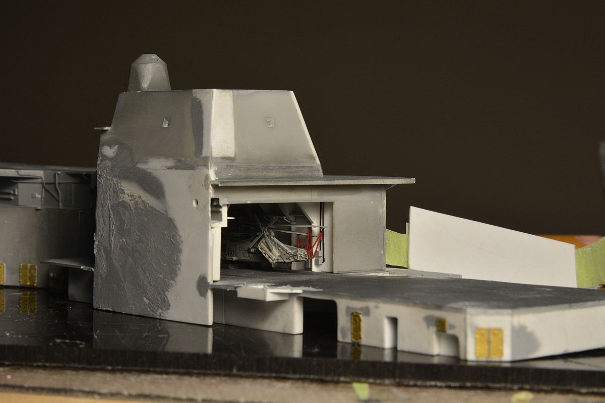

Finally, some more progress. Not much though. This is a tough ship to model correctly. And this goes for the whole class of course.
I painted the superstructure. After that I thought it's just piling the fun bits on, but no. The White Ensign photo etch set is horribly inaccurate in a lot of ways. The right decals are also hard to find. Either the quality or the content leaves much to be desired...
Some decals will be going on soon though.
I am focusing on the forward section of the starboard for now. I did add some fun stuff. Like that platform extending from the bridge level. It turned out that the "floor" here is NOT perforated, but a solid plate. Something to cover up later.... :doh_1:
Not much to say for now, hopefully the pictures tell more...
Laci

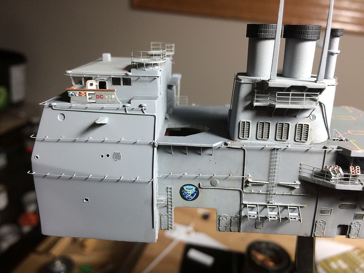

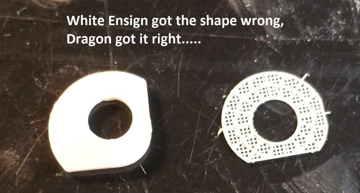

Well, This ship is a little cursed... Can't move ahead with just pure progress, there just HAS to be some destruction as well, for some reason. I think it is just getting too delicate to handle. Which is too bad, since there is soo much to go yet!
But it is taking shape, and it will look like a decent Missile Cruiser!
I feel like this class is not getting enough publicity, or drawing much interest. Maybe it's just me?! :lol_3: So I won't be listing every-single-thing I found with the kit and accessories to be out of shape , or inaccurate or missing entirely, like I did it with my other ship, because that's a lot of work, and I'd like the ship to eat up that time then. But I hope the pictures will get more people building these CGs, AND posting their work.
Happy modelling , and don't feed the " carpet-monster", like I have been..... :wacko:

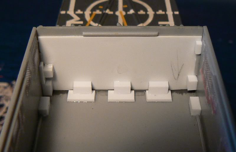

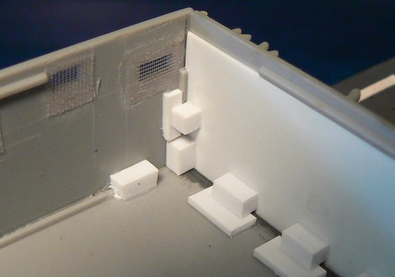

Devin, you have made the point of these shoebox-like structures, but this Dragon-or-whatever model should not be a problem, or at least not a bigger problem than Lee´s Perry-class FFG. I built one in the past, and I solved the problem attaching one bulkhead at a time, using square blocks to reinforce the welding. This:
Something I would never do is detailing before the superstructures are definitely in place, but I presume this is a personal option.
