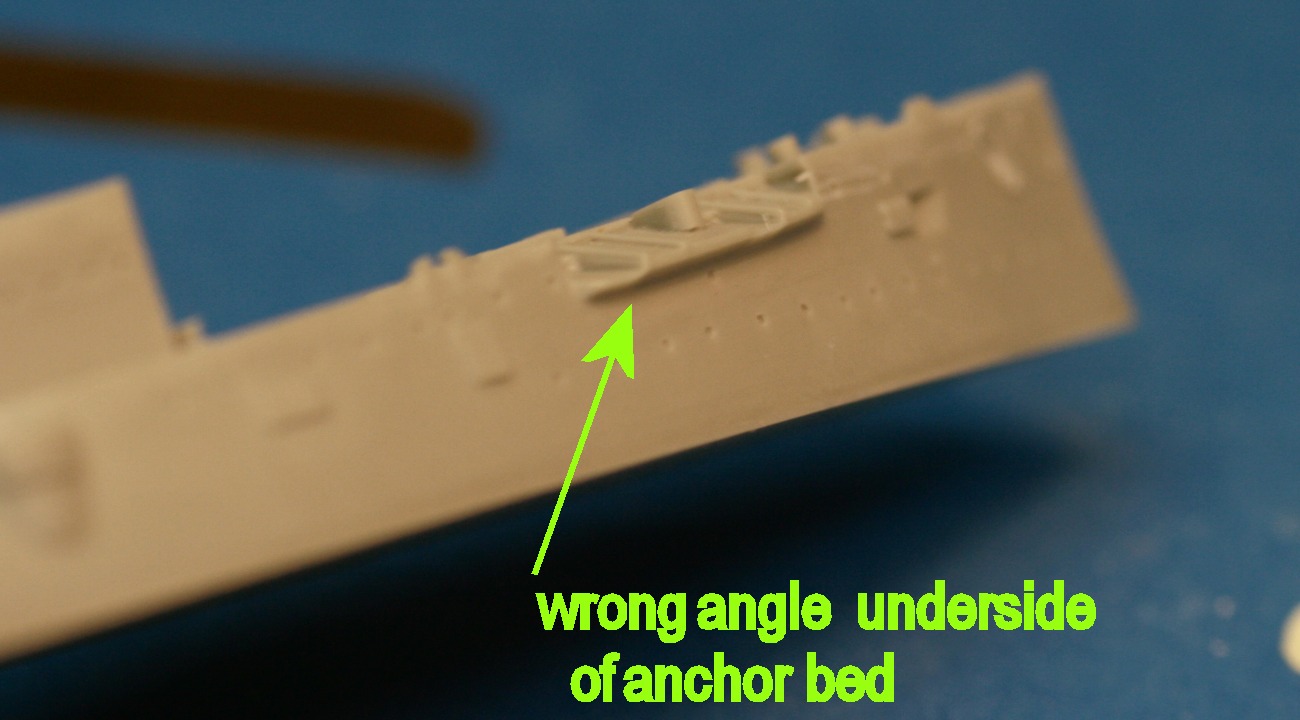

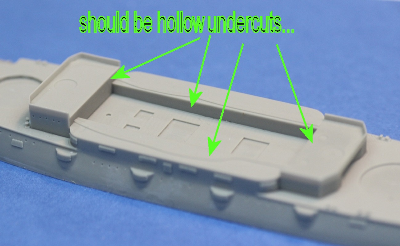

At the outset I realised I would be removing a lot of things before the build proper would begin.( and any hope of a quick build evaporated! )
The boat deck/well-deck should have undercuts in all directions-
On the kit this was cast solid-
==> ( this is an example where I would be very happy to pay substantially more
for a high quality multi-media kit with brass decks etc )
anyhow--the deck enclosed by solid boxes looked wrong--and is wrong--an easy mistake to make when viewing the overhead views-
-less so when looking at the cross-section in the WARSHIP Volume...

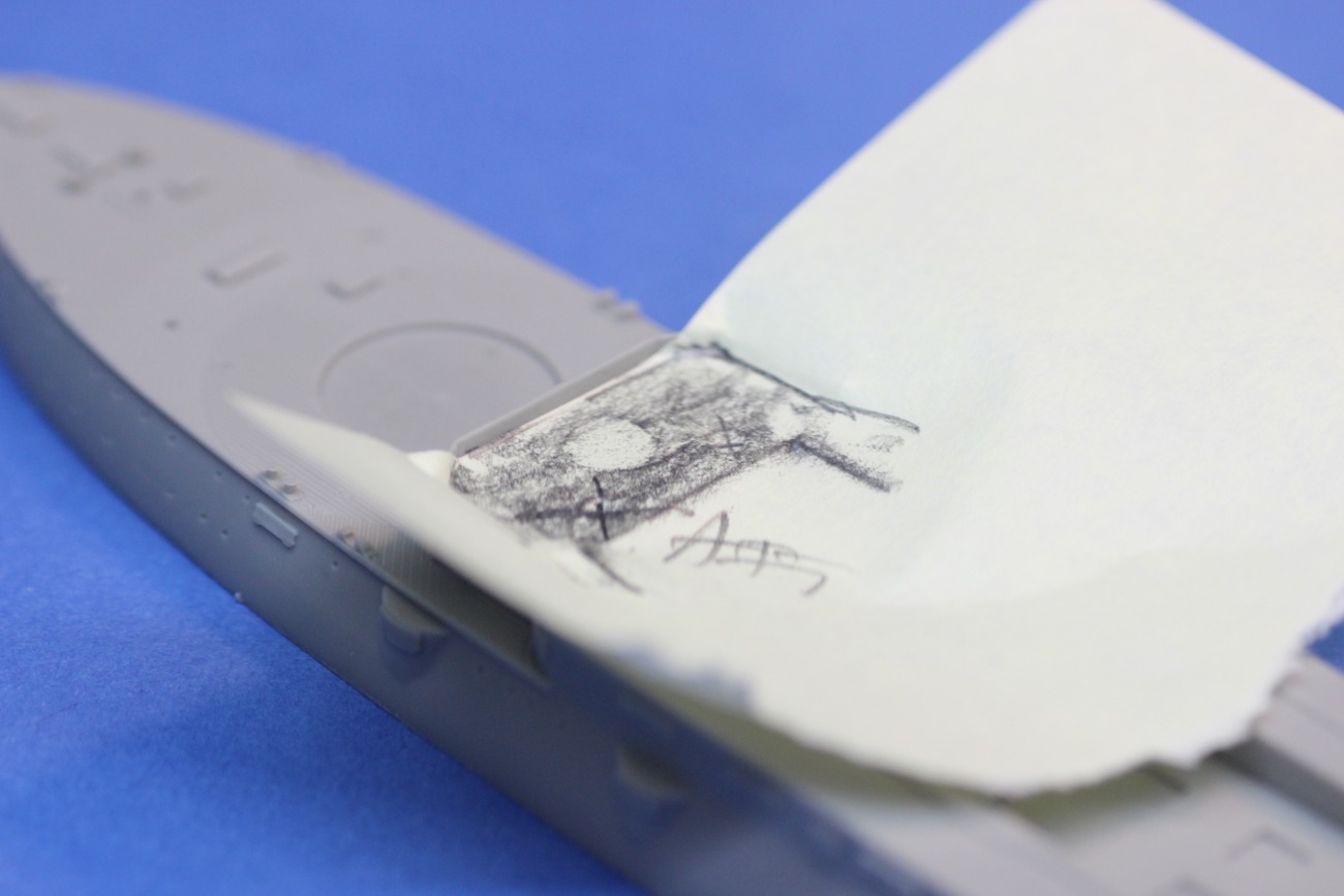

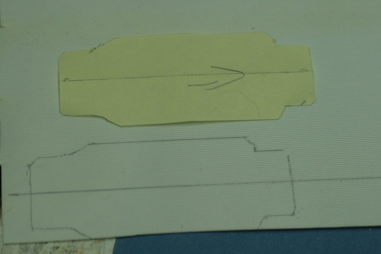

so the first thing to do was to make some templates of the basically good shapes

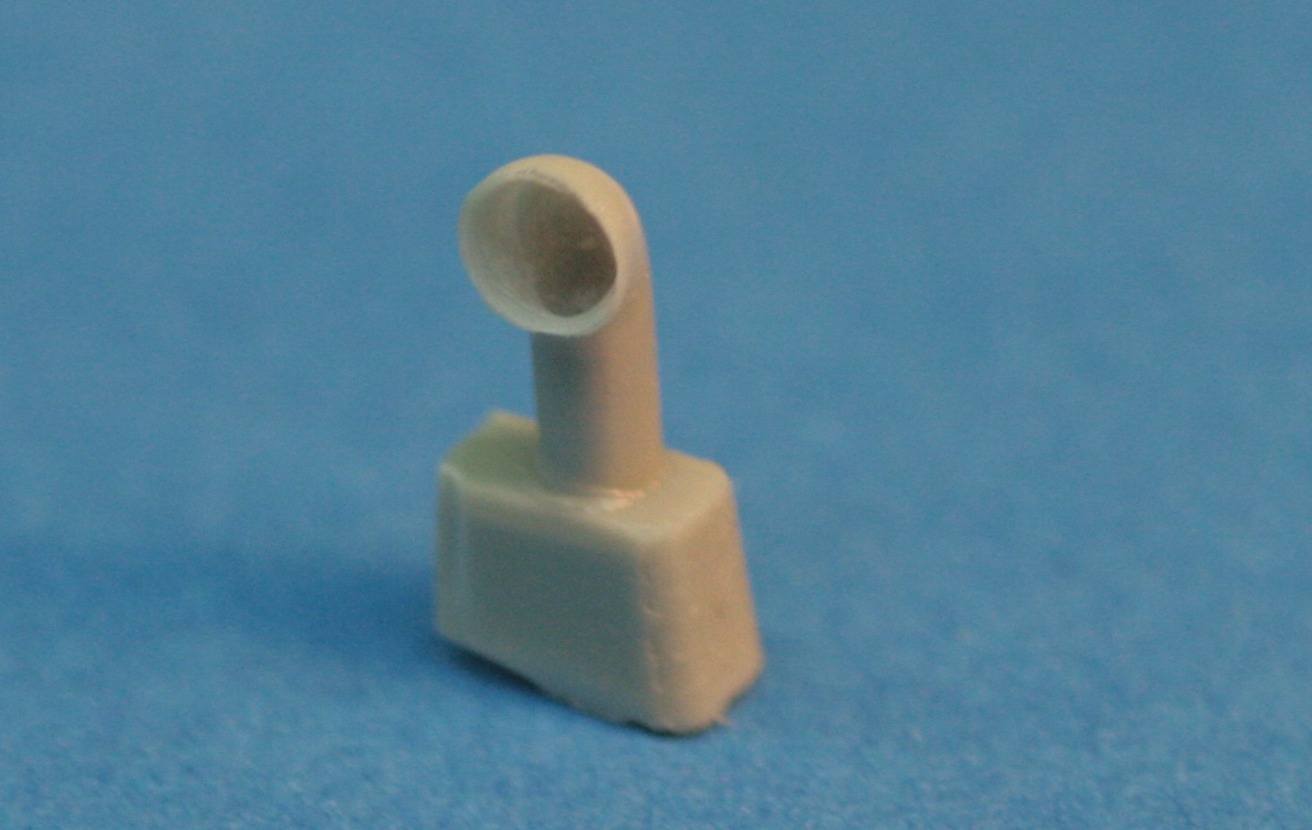

I made a start on the numerous cowl vents festooned all over the ship.
The kit items were about the right shape--if a bit clumsy looking on the rim of the cowl mouth.
In real life these are thin metal constructions--with a deep and visible throat aperture
I decided to try and refine the cast pieces to emulate the real thing!
Delicate touch is required--as it can easily go wrong with too much material removed...!
Tools used:

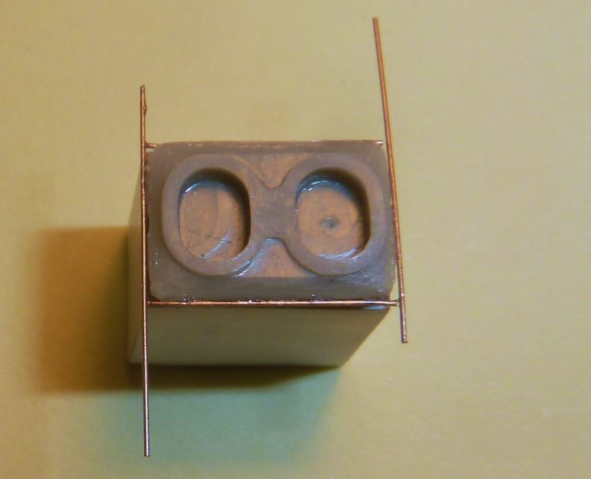

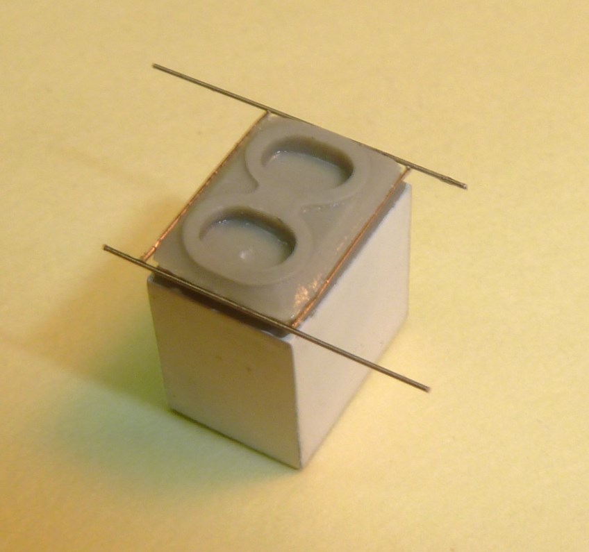

The funnel base was of the correct shape and size; however the cowl edges and corners were damaged ( see photo below )and in any case the cowl was also a bit undersized....
The cowl was enlarged by means of the the application of thin copper wire using CA glue, snipped off in situ to the correct size with a blade onto a small metal block for a really clean corner
Once the wire had been cut and filed, the gaps were infilled with CA glue in a couple of coats
and paint has been applied and left to setttle it all started to look more promising !

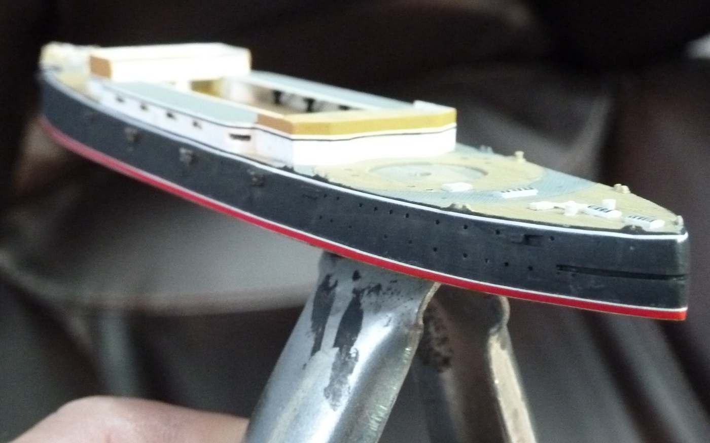

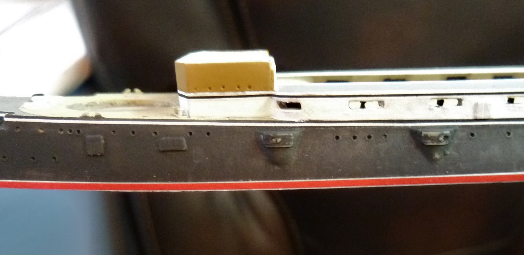

Demarcation of fine lines in 1/700 ... alas I am not a patient masker or sprayer...
and my masking efforts in this scale to date have always been indifferent and unsatisfactory...
I wanted and needed to keep it sharp and well defined, so I went back to my favoured and well tried and tested TL decals striping in various colours
https://tl-modellbau.de/TL-Decals_1
I sharpened up the demarcation twixt the buff and the white all round... adding black and white striping decals where appropriate to gain straight lines .
Once the first runs of stripes were hard and dry I added the black stripe ( according to Burt and the painting on my wall at home :cool_2: ) though blue according to Brian King (?)
...thereafter I added a broader white stripe at the waterline
The entire hull top- sides of the ship were now varnished with matt clear varnish to give an inter-face 'twixt the various layers, so as to inhibit damage in handling and also to prevent softening of existing decals when the next layer went on to represent the underwater red

my chum Bill Livingstone has far more skill and patience than I with an airbrush
though it probably took him five times longer :wave_1: :big_grin: :big_grin: :wave_1:

I have also used the wider strips very effectivly for the clean and sharp demarcation of the buff/white on the
funnel sub-structures and also the cowl vents ´-
But the wider strips give not just simply a demaraction line,
but aso fill in most effectively the entire block in a verz satisfactory smooth and dense finish white all in one piece
More photos soon once back in the UK and at mz modelbench!
