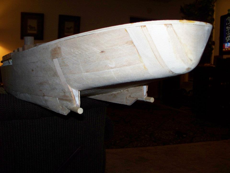

Sort of a jump now in the hull construction. I have covered the framing with two layers of 1/8 balsa sheet. bow and stern are shaped with solid balsa block. I used body filler for final shaping.

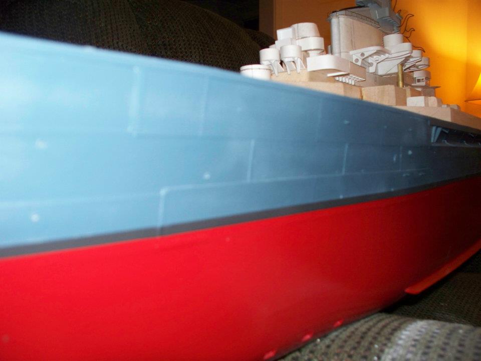

Here is the hull now covered in the card stock to simulate the hull plating. Some superstructure parts going up as well. Basic profile of the ship taking shape.

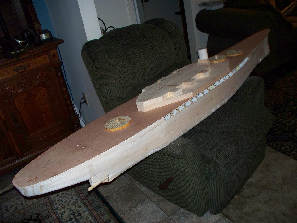

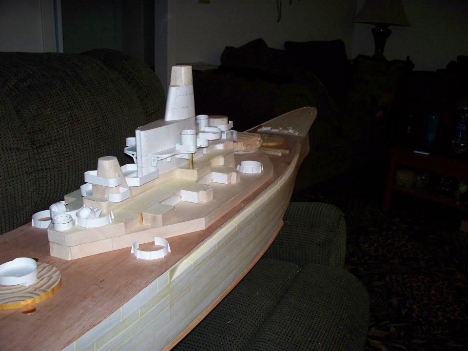

Now on to some early superstructure construction. I used 1 inch thick balsa planks for the dack levels. Again used card stock for plating and fabrication.

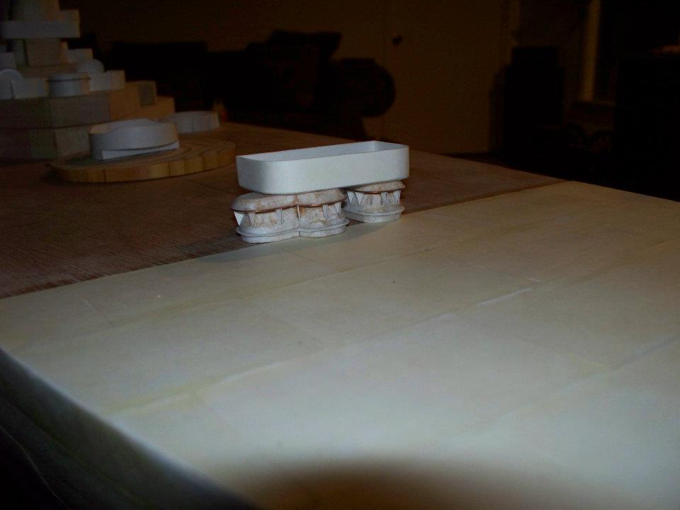

The 5 inch guns. I made a master and cast these myself from resin. The barrels are from B&D barrels. Ladder rungs were made from staples.
File comment: The master

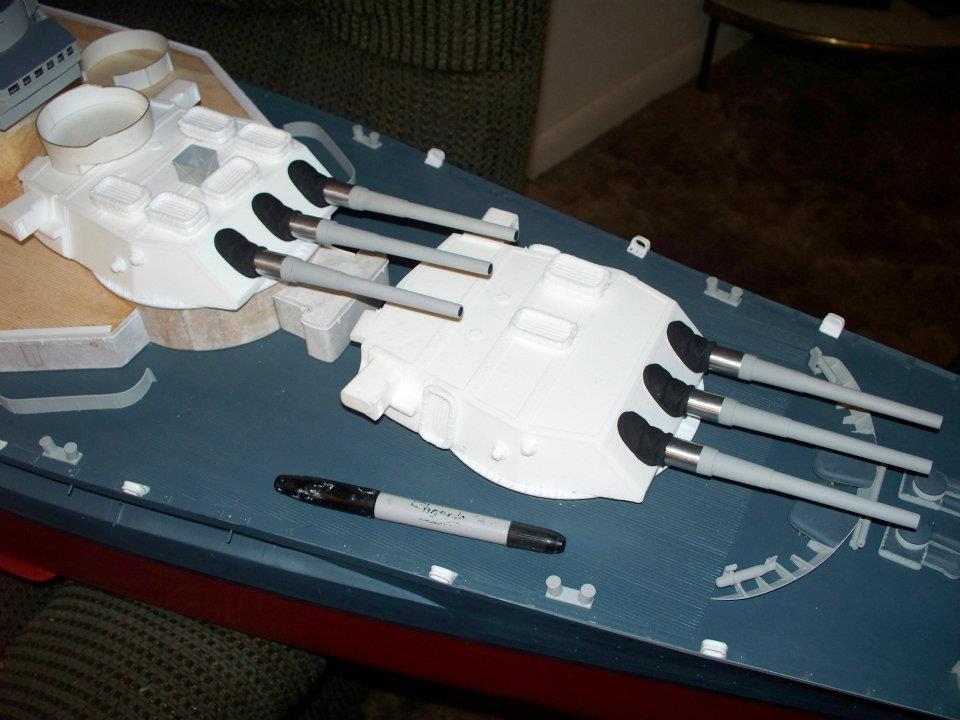

The main guns. Like the 5 inch turrets I made a master and cast these myself, Each one took 16 ounces of resin to cast.

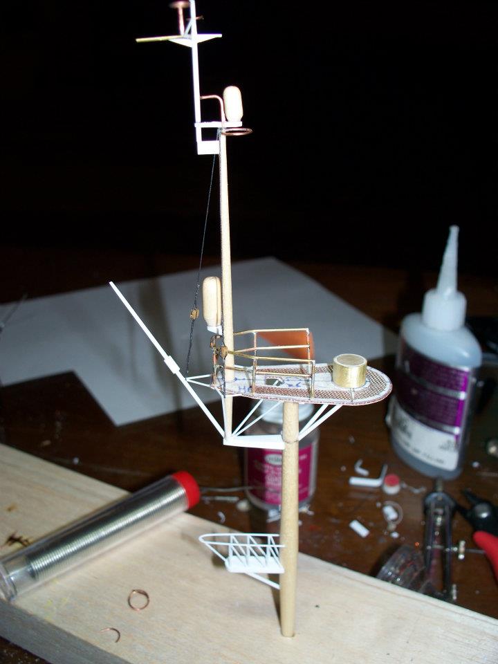

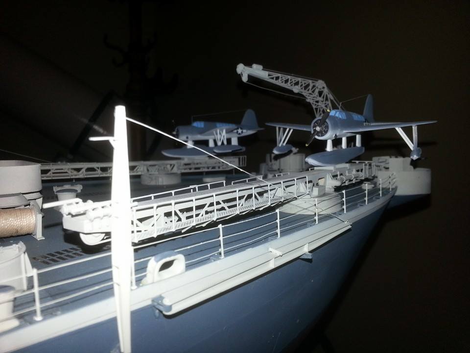

Now just some oddball small items.
File comment: Aircraft crane made from soldered brass wire.
File comment: Forward radar mast

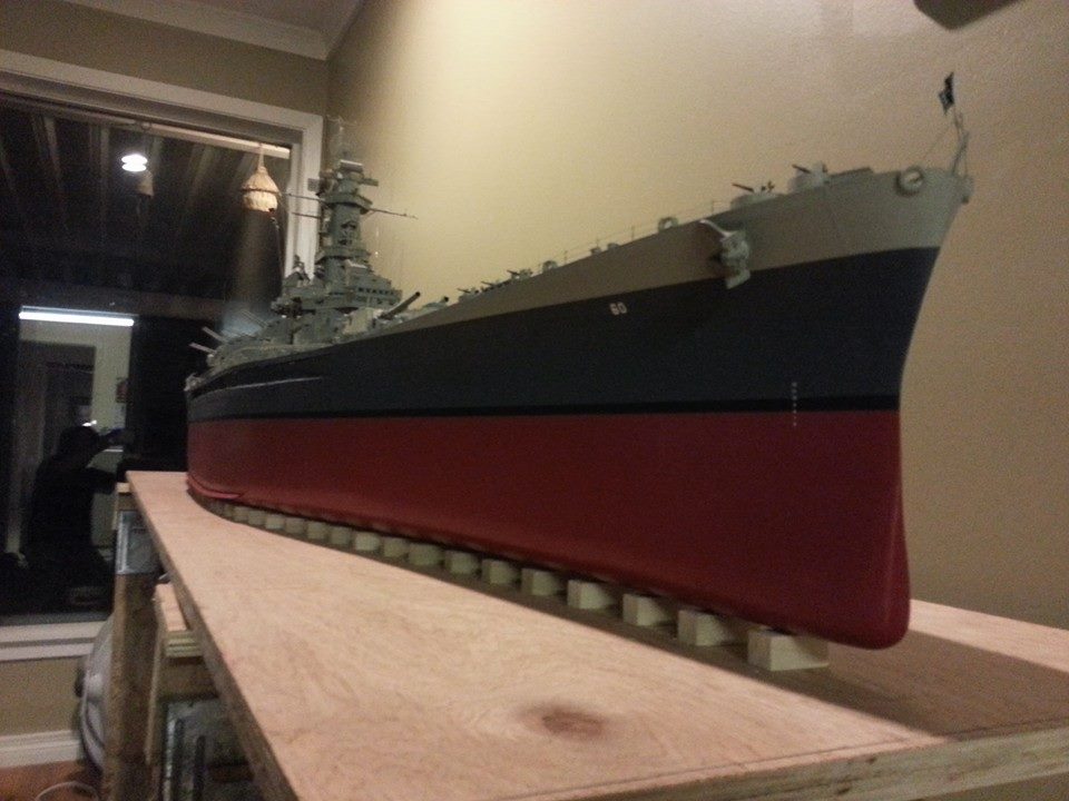

Joined: Thu Dec 10, 2009 7:54 pm
Posts: 31
Moving back to the superstructure construction and detailing now.
