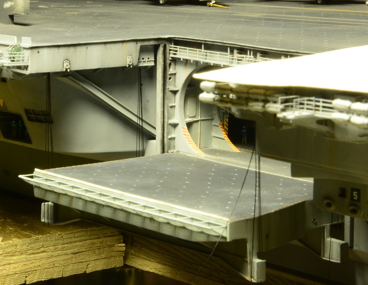

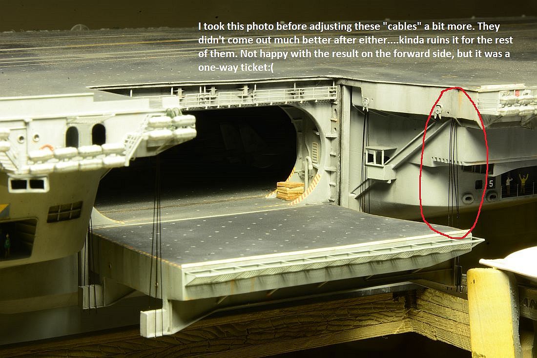

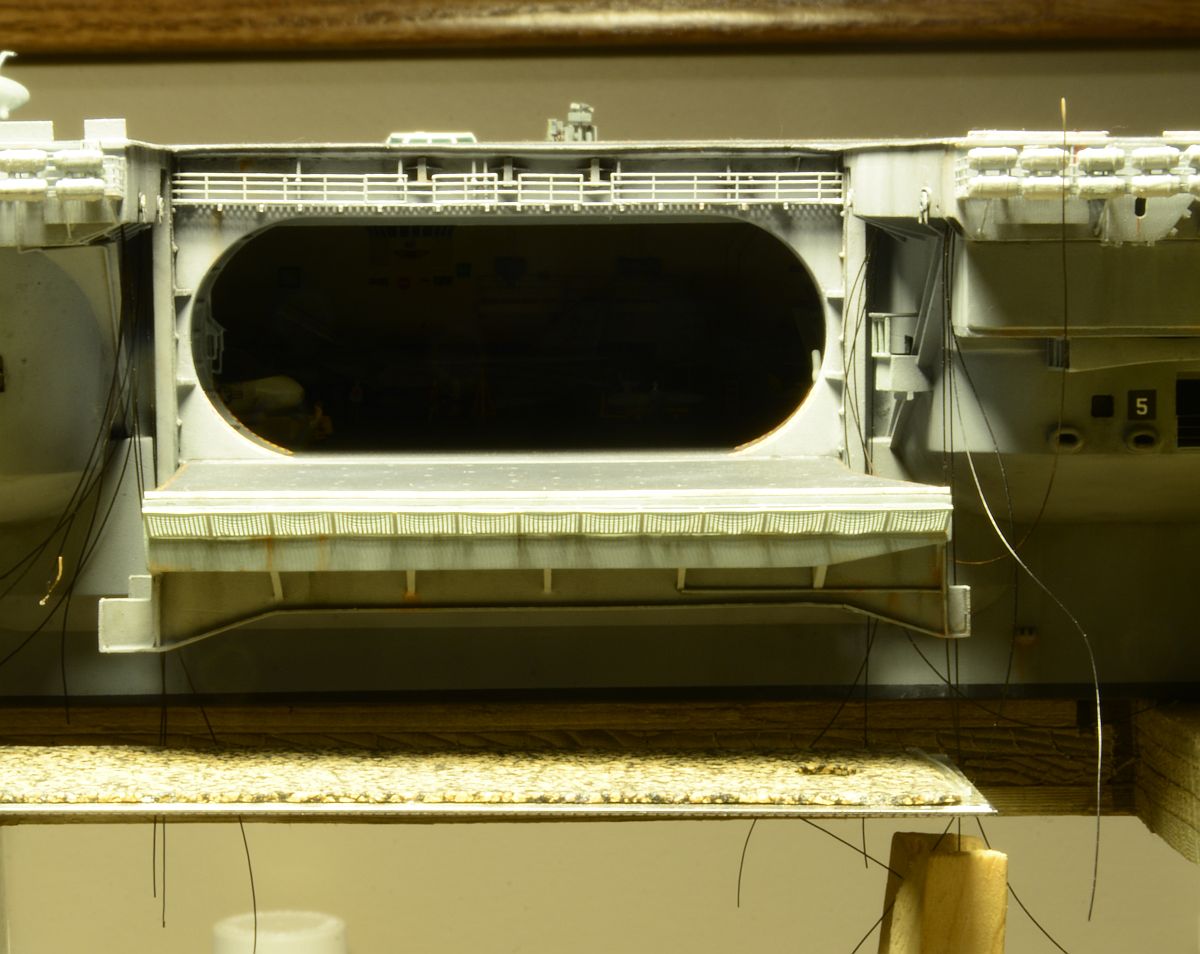

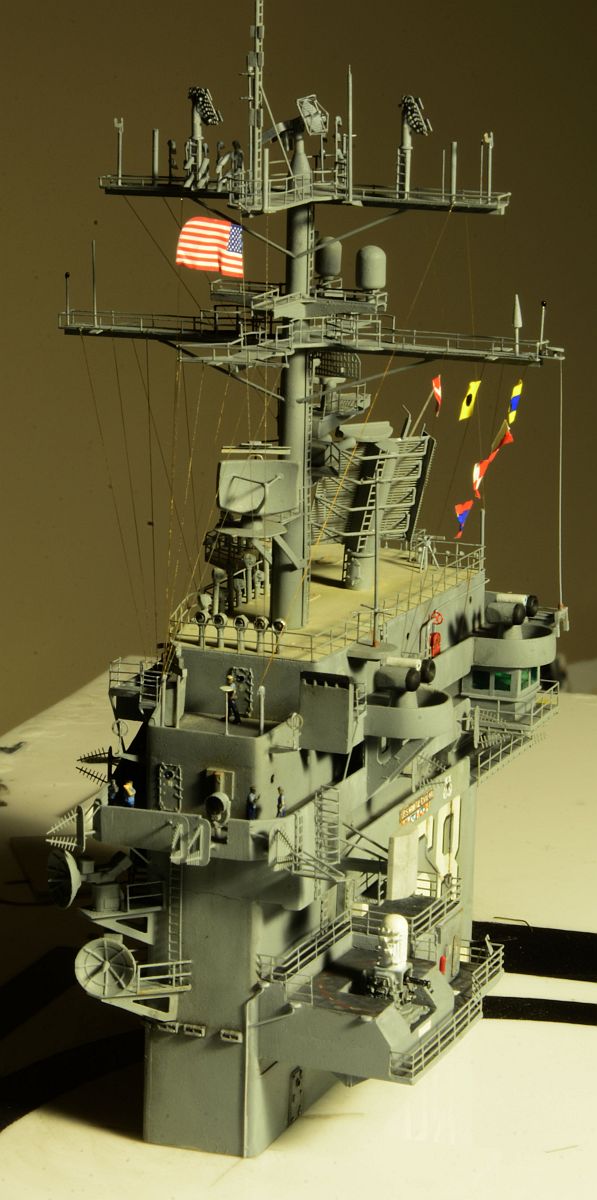

Well, thanks to all the support and the endless amount of spare-time I had thrown at me in the last 10 days, I made more progress on this seemingly never ending fiasco... Unfortunately it looks like I slipped into year 7... just like the real thing..haha. Well, I am not 10000 people working 3 shifts 365 days a year... but still: I didn't start this yesterday. And now it feels GREAT to see parts completely complete, and in place for the first time since 2009!!!!
Like I said: The island is complete! It's only missing parts are the ones linking it to the rest of the ship: a set of stairs and a drainpipe!!!
The rigging was a nerve-wrecking experience. I have seen and heard a lot of different materials used, but years ago I used human hair in a test, and found it perfect! It's strong, but has enough give that if you touch it accidentally, it wont break or bend! And the best thing about it: my wife has thin enough hair, that looks perfectly scaled down for 1/350! So she is part of my hobby too!
Her hair was also perfect for the arrester cables! In this scale I think they should never be any thicker. ON a 1/700 scale ship I probably wouldn't even install them.
The #2 elevator is complete as well!!!!
Modeling the elevator cables troubled me for a long time. The PE parts were out of question since the beginning( of time, haha). Stretched sprue also didn't seem great because if it breaks off, you are hooped, and it's very frail.
Copper (or any other metal) wire wouldn't have worked for me either for if I hit them, they easily bend..... so I needed hair again! But I was torn between really thick human hair-no, not pubic hair!!!!- or horse-hair. If it's good enough for fiddlers, why not modelers? The elevator cables are very thick, and they stand out on photos taken from a distance away too... so I got some horse mane strands from a friend of mine, and put it to test.
Now that it's done, I can say it was a mistake.... It is too thick, and I think it's better to have things under-scaled, than over-scaled. It's the less evil of the 2. This hair is very strong and doesn't have much give. Although they came out just fine on the end towards the stern, I am simply disgusted with the outcome on the side towards the bow.... Here I could only attach the cables to the ship on an angle, and that angle never went away, giving these "cables" a bent look, which is impossible under the 100000 pounds the elevator weighs.... looks very stupid, but there is nothing I can do to fix it. But you guys can: LOOK AWAY :nod_1:
Overall I don't really care anymore, because I really need to get this thing shelved, and start something different. (Or finish Vincennes). But on the other hand I still want to keep butcher- and chainsaw-work to a minimum. :big_grin:
Plus, mostly all my other ideas worked out, it was time to lose a battle or 2...
I hope we all learnt something:)
thanks for checking in, and happy modeling

Oh, I almost forgot: the arrester-cables! What do you guys think: Is hair OK? I personally think it sounds ridiculous, but I love how thin and straight and strong it is!
Laci

I would use wire for the arrester-cables. Altough I saw only photos, but they seemed tighter than elevator cables. I'm not sure the hair can be strained that much. On the other hand your wife will not be bald :big_grin:

Hair !. :cool_1: I did use hair once rigging the Revell Eastwind after a long custom job on her. I still had long hair when i built her. I sold the model and regretted that. However many years later I got a call from the owner and he damaged the model. It needed a new mast etc.
Funny thing was by then I went bald and shaved my head but I wasn't done. Also by then i had a daughter who had long enough hair so she became the next donor for model repair.
Go ahead and use your hair,
