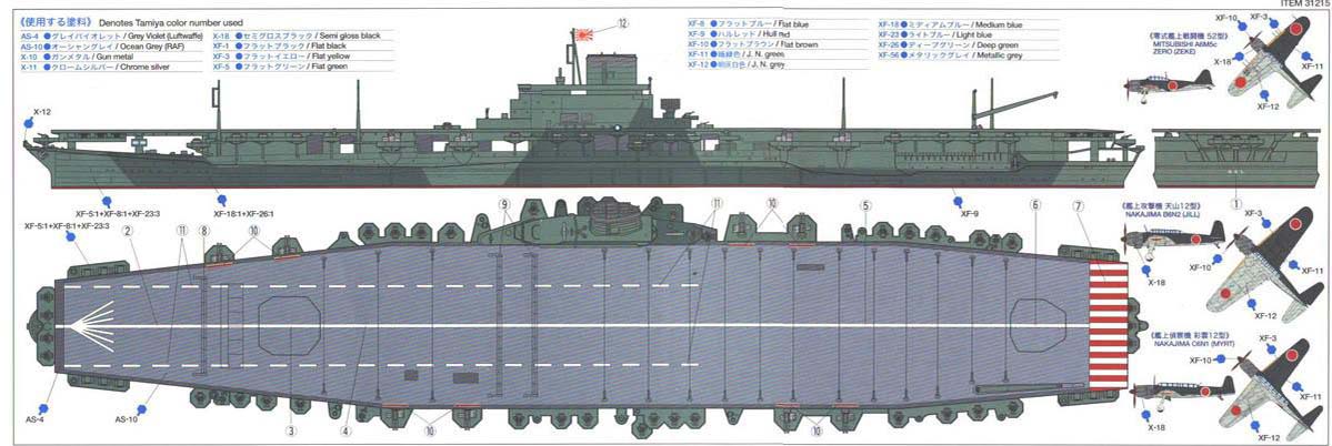

These illustrations might help show the differences
