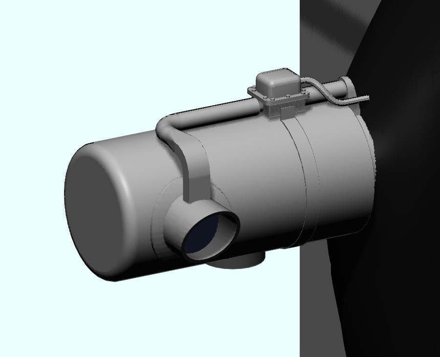

I was looking back over pictures of the Mk 37 director and noticed a detail that I had missed.
On the optical range finder arms there is a bit of plumbing. In some pictures it looks like solid pipes and in others I can see what appears to be sections of pipe joined by pieces of rubber hose with hose clamps. In the middle is what appears to be a solenoid valve.
My guess is that is is compressed air piping with an electrical valve. Perhaps it was used to blow water/dust off the lens, or maybe it was used to blow off the caps that normally were fitted over the lens tube when the director wasn't being used.
Does anyone know for sure what this was for?
The Mk 37 instruction manual says the optical rangefinder operator should remove the lens caps, but it doesn't say how. He could climb out on the side ladder and pull them off by hand, but the compressed air "ejector" could be operated from inside much quicker.
Note: The lens caps were attached to the structure with short chains (not shown) so they wouldn't be lost when they were removed.
This piping was not installed on the directors in 1941, but appears to have been common in late 1942.

PostPosted: Fri Sep 02, 2016 6:48 pm
Posts: 307
Location: Austin
I think I remember reading somewhere that this was an anti-fog and de-icing measure, but can't be sure.

Here is the flagstaff on the stern again! I have found very few photos of the flagstaff and most were fuzzy pictures shot at a distance. None showed the area where the staff attached to the base. I had to guess how the mechanism worked for swinging the flagstaff horizontal to clear the helo pad for operations.
I was looking through a ship's cruise book and found a photo of the stern lookout. In the corner of the photo was the image of the hinge mechanism. Maybe this will be the final iteration!
