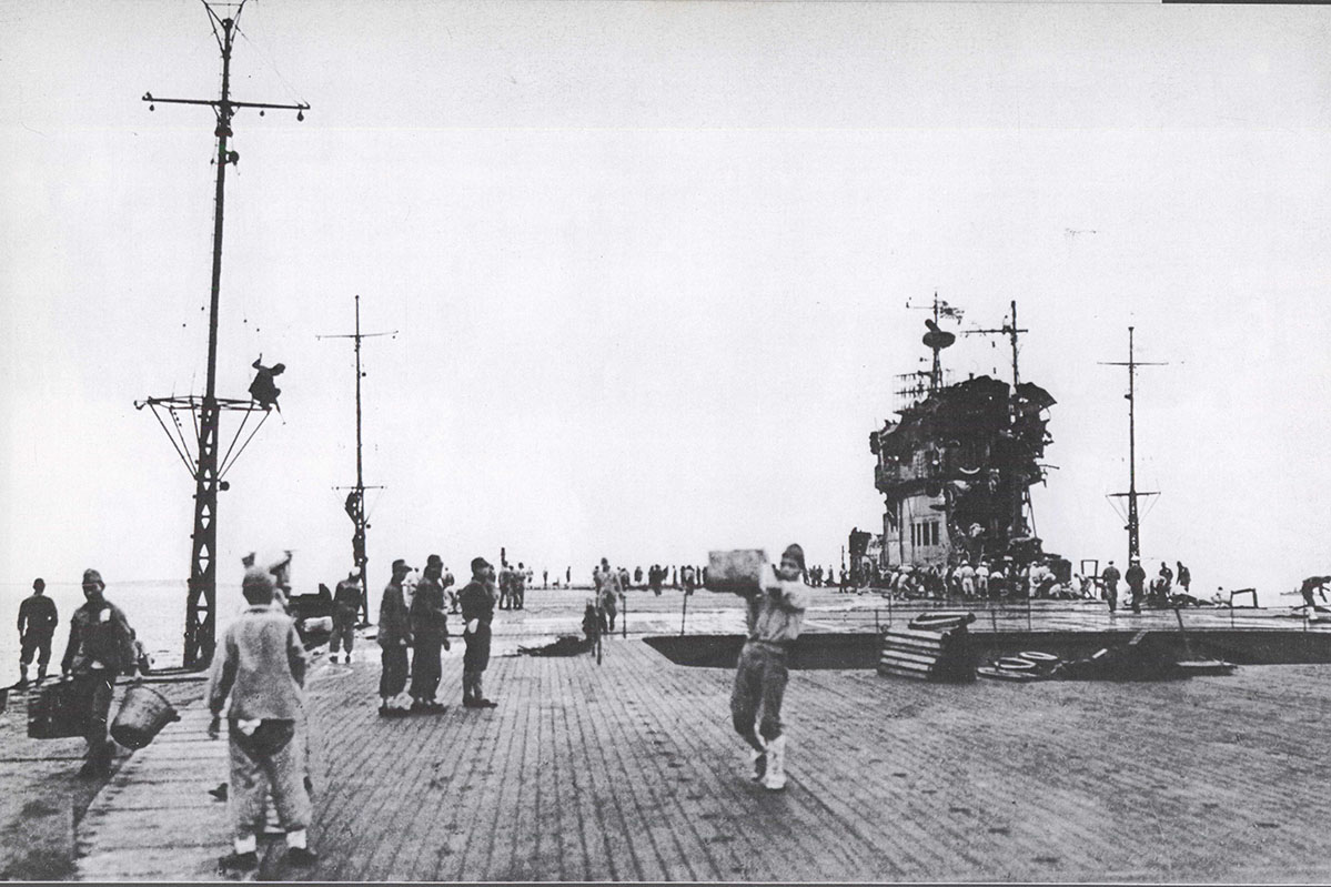

Quote:
How much better is Hasegawa's planking compared to Fujimi?
The short version is: MUCH better. Both companies get kudos for replicating the flight deck planking with recessed lines for seams instead of raised lines.
Fujimi's problems are: 1) plank width is seriously overscale, maybe 10 to 14" in width when it should be 6 to 8" wide ; 2) their seams are overscale as well, almost a scale 7"; & 3) their planking pattern is incorrect, alternating every other plank when it should be every 5th plank. The result is a deck with overt details that appears far too uniform. BTW, this applies to not only their CVs, but also their BBs. And, also to most of the aftermarket wood deck replacements.)
Hasegawa's rendition is far superior in every respect: narrower widths and seams, and a more random placement of the planking pattern. (I'll take comparative measurements again tonight, also some photos.)
This is detail that few folks aside from myself really care much about, which I understand completely. After all, if one is going to spray the flight deck with a deck tan and leave it at that, or use a wooden deck, or paint the deck in the late war camouflage scheme, then further attention to the deck probably doesn’t matter that much more to that modeler. Which is absolutely fine.
On the other hand, personally, I find the flight deck one of the most prominent things you see on an aircraft carrier model, and I believe it deserves a bit more attention. So, I prefer to use a wash on the deck, to bring out detail, to break up the monotony of the expanse, and to make it seem a little more realistic. And, when you go in for a bit more realism, then the scale of the details becomes a bit more important.
What I find really annoying is that the information to render it correctly is out there; witness Hasegawa's efforts. Fujimi has chosen to ignore that information with each new release, and I can't fathom why. It takes just as much effort to create a new kit each time regardless of which information one uses.
Incidentally, I believe that Fujimi, or whomever did the initial research, based the planking pattern on the deck of the museum ship Mikasa. Which may be fine for Mikasa. Definitely not for the others.

 Post subject: Re: Hasegawa 1/350 Junyo
PostPosted: Wed Aug 24, 2016 1:57 pm
Posts: 10454
Location: EG48
Given Mikasa's restoration, it's very possible her planking isn't to the original pattern either.
PostPosted: Wed Aug 24, 2016 4:09 pm
Posts: 8577
My thought, exactly.

A couple of views of Junyo's actual deck, to see how the planking really looked. In reality, perhaps the plank ends are overstated even in 1/350, which is why I always thought the continuous plank look seemed best. The overhead deck views are only 35' to 50' away from the decking closest to the camera. Again, judge for yourself, along with the actual plank width.
