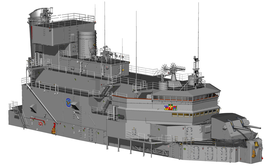

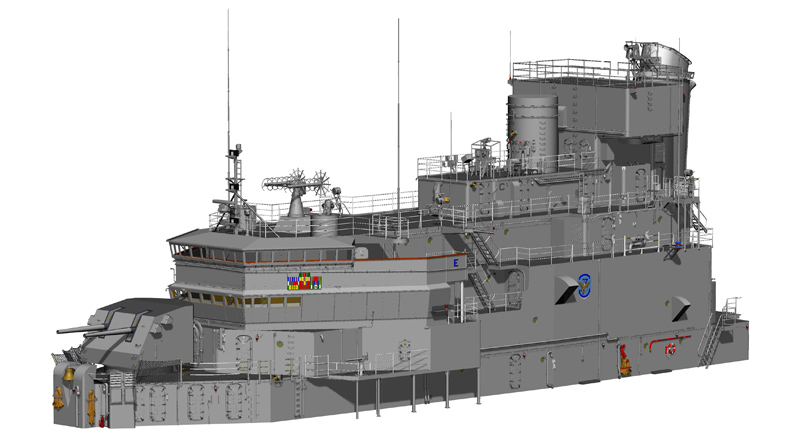

PostPosted: Tue Jun 07, 2016 12:03 am
Posts: 1645
Making slow progress. May was incredibly busy - don't think I had time to do any work on the model. Less hectic now.
I have (almost) finished detailing the lower starboard side and detailed the lower port side. 470,000 entities in the drawing, with 3.7 million points. 325 megabytes - It is getting cumbersome to work with.
Still need to work on the O2 and O3 levels, and details at the aft end of the deck house. Lots of mooring line reels, more searchlights, binoculars and refueling stations. Then I will work on the details of the bridge wings and pilot house. Next will be adding the Mk37 director and a dozen or so life rafts. Finally the forward radar tower will be added, and the wire antennas, ship's flags and pennants will be rigged.

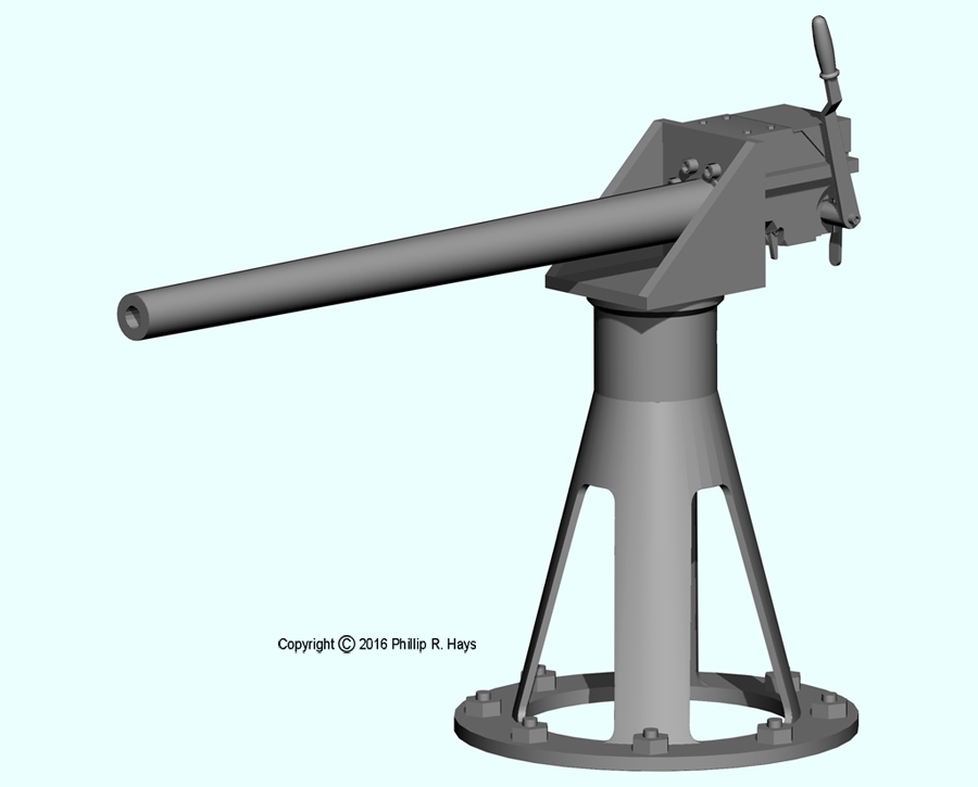

PostPosted: Thu Jun 23, 2016 10:15 pm
Posts: 1645
Here is another detail for the forward superstructure. This is the 40mm saluting gun. The OK City was a flagship and we visited a lot of ports and hosted many dignitaries - all calling for salutes.
The saluting guns were an oddity on the CLGs - they were positioned at different places on most of the ships. On the OK City and the USS Little Rock they were on small outboard platforms at the O1 level, but some ships had them on the O4 level.
I have never found plans for these guns, but photos from WWII ships and modern era ships show they were essentially the same over the years. I concocted this design from many ship photos and even a publicity photo for a movie. It is pretty much a "Heinz 57" variety.
If anyone has plans for the real thing - or good close-up photos - I would appreciate having them.

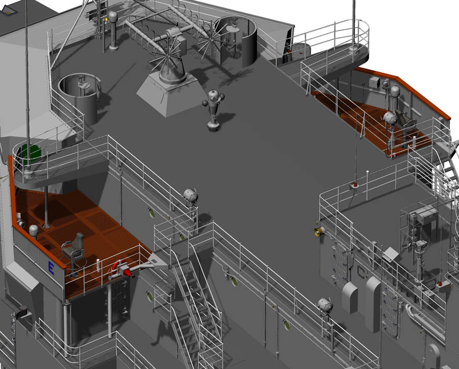

PostPosted: Mon Aug 08, 2016 3:54 pm
Posts: 1645
More progress on the forward superstructure. I think I have finished all of the nit-picking details like water washdown piping, lights, switches, wiring, etc. But there still may be a fire plug and hose on the port O3 level - I just don't have clear photos of that area.
Next I need to detail the open bridge wings - Captain's chair, wood gratings, pelorus, etc. Someday I will detail the enclosed navigation bridge and pilot house.
There are two more searchlights to do, and I need to add the big binoculars and the Mk 37 director. The last details to add will be about a dozen life rafts. That will increase the file size quite a bit and slow things down even more than they are now.
After that I will add the huge forward radar tower to finish it off - that will bring the file up to about 280 Mbytes. Then working with it will be very slow!
I ran into a snag a couple of weeks ago. When I started the forward superstructure several years back I mistakenly read a blurry dimension from a blueprint. Instead of setting a point 12 inches forward of a frame I put it 18 inches forward. After that I occasionally found things that just didn't fit right. Well, I found the error just as I thought I was about finished with the navigation bridge, and had to redraw most of the navigation bridge and flag bridge! But now things fit together nicely.
That was the whole point in creating the CAD model in the first place - to be sure the parts fit together before I start cutting material and spending time on the real 1:96 model.

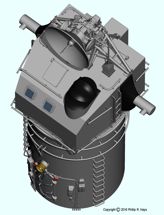

PostPosted: Tue Aug 23, 2016 2:07 pm

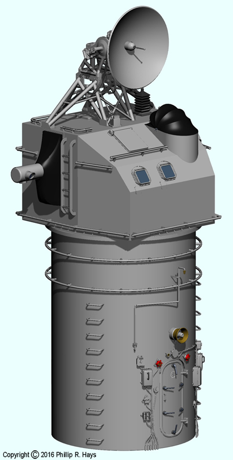

Posts: 1645
The Mk 37 director needed a little rework from the file I created eight years ago. Minor detail changes, but I did manage to reduce the file size by 20%.
This is the Mk 37 with the Mk 25 radar. The ship originally (early 1960s) had a screened parabolic dish antenna for the Mk 25. But by 1967 this had been replaced by the solid parabolic dish shown here.
The original Mk 37s did not have radar and used optical sights. During WWII the Mk 12 radars were installed and then replaced with the newer Mk 22 radar. Mk 25s were introduced in 1945 with the screened dish antenna. The optical sights were still used to make fine adjustments to bearing and elevation.
Mk 37s were found on auxiliaries, destroyers, cruisers, battleships and aircraft carriers. They all looked alike, more or less. But the shields were of different thickness armor plate to reduce topside weight on smaller ships.

The original directors had three windows in front. They did not have the Director Officer's cockpit with the open seat and the black canvas folding cover shown here - it must have been hot inside! I stood Director Officer's watch part of the time I was on the OK City, and that open cockpit was the highest manned station on the ship. The view was great and it was a good place to get a tan! Off Vietnam, where it was very warm, when we weren't shooting at something the director crew opened all the hatches and sat on top to catch rays. The best seat in the house!
The OK City used the Mk 37 to direct both the 6"/47 main battery and the 5"/38 secondary battery. All CLGs retained the original Cleveland Mk 34 director for the 6" battery, but this was removed from the Oklahoma City (and only the Okieboat) in the mid 60s to reduce topside weight. This is an easy way to distinguish the Oklahoma City from the other CLGs.
Note: Edited to correct mistakes pointed out by Rick 23 Aug.

PostPosted: Tue Aug 23, 2016 6:26 pm
Posts: 3825
Phil,
Your history/nomenclature for Mk 37 director radars is a little off. My tutorial is focused on USN destroyers, but the Fire Control Radars used on Mk 37 directors on any USN ship were the same (different Mods maybe).
The Mk 37 director true enough didn't have radar when first introduced on the SIMS class destroyers. But, the first radars installed on destroyer Mk 37 directors were in September 1941 with the first being the FD (Mk 4) radar. The Mk 4 radars were improved with various mods until replaced with the Mk 12 radar in 1944 on new construction.
The Mk 12 radar was intended to be paired with the Mk 22 "orange-peel" radar to improve low altitude performance and better height angle determination on the "Square-Backed" Mk 37 directors. The Mk 22 radar development lagged behind the Mk 12 by a few months, so some destroyers (unsure about cruisers, etc) went into service without the Mk 22. Most however had the Mk 22 added during Post-Shakedown. The Mk 12/22 radar pairing was common on most USN ships with Mk 37 directors by the end of WWII.
The late war replacement for the Mk 12/22 radars was the Mk 25 radar, not the Mk 28. The Mk 28 radar was a smaller radar (with a smaller dish antenna) intended to be installed on the destroyers with the older "Taper-back" Mk 37 director that couldn't accommodate the Mk 12/22. The Mk 28 was installed on SIMS-BENSON-GLEAVES class destroyers and GLEAVES class DMS units and some older destroyers with earlier directors.

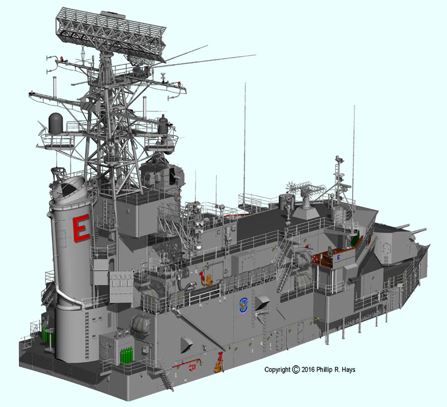

PostPosted: Wed Aug 24, 2016 5:57 pm
Posts: 1645
Finally, after nine months the forward superstructure is (almost) done. I say almost because there are a few details I am not certain about and I need to decide what signal flags will be flying and add two wire antennas.
315 Mbytes, 6,460,977 points and 847,080 entities in the drawing!
The majority of the work is done on the model - I'd estimate 95%. There are some details to add to the main deck on the hull - lifelines and such, and a bunch of nets around the flight deck. Then I can put it all together.
I want to create a set of 2D drawings from the model and that will take quite a while to finish.

I was looking through a ship's cruise book and found a photo of the stern lookout. In the corner of the photo was the image of the hinge mechanism. Maybe this will be the final iteration!
