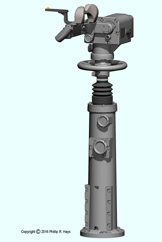

I have questions about "target designators" and "target designation transmitters" (TDTs) - are they the same thing?
Looking at the blueprints for the USS Cleveland CL-55 I find the following:
Main battery designator - O4 level P&S Frame 57 - Main Battery Fire Control station
Main battery target designator - O3 level P&S ~8" aft Frame 91 - After Main Battery Fire Control station
Secondary battery designator - O5 level P&S ~Frame 61 -Air Defense Forward station
Secondary battery target designator - O4 level P&S Frame 91 - Air Defense Aft station
These target designators are separate from the gun directors (main, secondary and 40mm) and the air lookout/sky lookout stations. No Mark/Mod is given for any of these but the drawing is different for the main battery and secondary battery target designators.
The CL-64 and CL-89 Book of General Plans show target designators at:
Main battery target designator periscope - 79'? ABL P&S Frame ~8" forward of Frame 57 - Forward Air defense station
Main battery target designator - 72' 9" ABL P&S Frame ~8" forward of Frame 57 - Forward Fire Control station
Main battery target designator periscope - 72' 1" ABL P&S ~Frame 92 1/2 - After Air Defense station
Main battery target designator? - 65' 3" ABL P&S ~Frame 92 1/2 - After Fire Control station
Secondary battery target designator - 79' 7" ABL P&S ~Frame 60 1/2 - Forward Air Defense station
Secondary battery target designator - 72' 1" ABL P&S Frame 90 - After Air Defense station
Again, the main and secondary battery designators are draw differently and no Mk/Mod number is given. The main battery designators are enclosed within armored shells with the periscope coming out of the top. This is shown in the outboard profile views.
I have seen pictures of a Mk 1 Target Designator and photos of the superstructure of battleships about 1940 that show a Mk 1 Target Designator (attached photo) and another type of target designator on a heavy cruiser.
A book of shipboard electronics from 1953 lists a Mk 11 Target Designator Transmitter .
The USS Little Rock CLG-4 had Mk 23 Mod 0 TDTs on the O5 level. I have attached a drawing of the Mk 23 and a photo of the name tag off of the Little Rock's TDT (thanks to Art Tilley). These were installed in 1959 or 1960.
I found a repair and maintenance manual for a Mk 24 TDT dated 1970 on Amazon Books.
I have found two references saying that "lookouts" could supply target information to the gunfire control system (GFCS). Another reference said "lookouts" used the TDTs. Another reference said TDTs could provide target information directly to the GFCS.
I suspect that the lookout would look through binoculars attached to the TDT and align the target into the view by rotating the TDT about the vertical axis to set the bearing and raising the arm carrying the binoculars about the horizontal axis to set the elevation. Then he pushed a button on the hand grip to send the information to the GFCS computer.
Then I suspect that a director would be slewed to the bearing and elevation to find the target for the guns.
To complicate things some references talk about a "target designator" within the GFCS below decks in gun plot. This target designator was a console with a radar display and a joystick to allow the operator to place a circle around a target blip and press a button to assign that target to a director. Diagrams show this traget designator could recieve target information from a director or from a "lookout."
Further confusing the issue, I found a photo of a "target designator" that was a box on the bulkhead in CIC that had bearing and elevation readouts.
So the term "target designator" is pretty ambiguous.
Does anyone have more information about "target designators" or "target designation transmitters" and how they were used? Any corrections to what I posted above?
