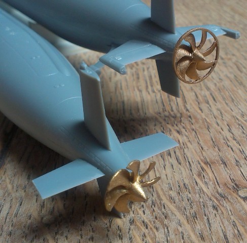

Hi guys,
There are screws available in 1:350 scale that may stand some scrutiny I believe. These are available from Naval Models in the Netherlands, you best write an email to Michiel Woort (the owner) at info@navalmodels.com. I think these screws are not advertized (yet) in their webshop.
Below I show these on two HobbyBoss LA 688 models, the right of course a Flight III 688i with the anhedrals repositioned to the correct 20 degrees below the horizontal.
Roger Whittaker +9/13/2023
