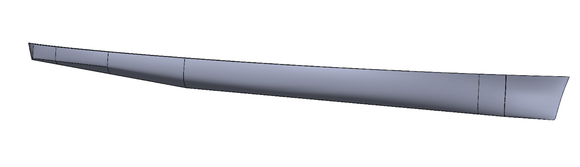

sure its not a real closeup due to the length but you can def see the knuckle in the rear and the nice transom ill get better later. I have abt 70 sheets from a Balao class sub I been wanting to do at 1/32 scale radio control that and a german type VIID but the offsets for the Balao over half are really illegible I guessed on some on the frame 70-137 sheet which wasnt too bead but the 1-70 sheet is just aweful. I want to do a radio control sub and like 1/6 scale Pibber MK II vietnam era patrol boat but couldnt find the pibber lines. it actually had come from a cabin cruiser hull originally and I was going to use waterjet motors on it like the original

I also wont be doing a thread on the Fletcher as it will be too slow with work and grandkids etc it may take 20 yrs to complete rofl However I am about to start a thread on the Higgins LCVP Landing craft I have drawings for. I am sorta lost on the TOO they show but you can look there and maybe answer my dumb question lol.
I will build a large maybe 6th scale Radio controlled one once I get the Hull figured out. it will be a good first all CGI boat for me as it isnt too complicated and so i can use the KISS method
