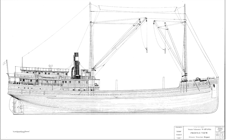

hey guys I finally came across some awesome drawings and the cool part is they have already been corrected of errors by the team that was going to restore one of the ships.
I am giving a link to all I have on the ship along with my excel sheet for the offsets and my curve files
here is my problem I got all the curves tested in solidworks and they indead have been fixed up however I am missing the info for a couple dimensions to enter into the curves for the stations to complete them.
I am missing the Half-Siding, the Deck Sheer and the Plank Sheer Dimensions to finish the curve files off properly
http://www.proflooney.net/Steamer-Schooner-Wapama.zip
it is The Steamer Schooner WAPAMA Circa 1915
above is zip file of everything I have its the drawings, an excell file I made of the offsets, and all the curve files I made for importing into Solidworks (unlike some other cad programs I have to make each curve file as a separate file
these are some really really nice plans and I want do do a good job on it as its one of the few sets of drawings where i can actually understand them as a newbie to ship modelling. I just am having some problems at the moment figuring out what those 3 missing dimensions come from so I can enter them in the proper space in my tables
thanks

PostPosted: Fri Dec 30, 2016 1:09 am
Posts: 1645
Joe,
This is really cool! I visited the Wapama back in the 1972 while I was at Treasure Island for discharge from the Navy. It was at the San Francisco Maritime Museum. It was a lumber "schooner" - the steam powered version of the original sail powered lumber schooners that carried timber from the northwest to California. It also had a few passenger cabins in the after superstructure. It was immaculate in the passenger section, with some of the most beautiful woodwork I have ever seen in the passenger salon, Captains quarters and the main staircase descending from the weather decks.
Unfortunately it rotted away and was finally scrapped in 2013. What a shame!

yes i thought it was really cool i dunno I came across site for it and said thats it I got to do it. the plans were redrawn to correct errors and everythings coming out great. the only problem I am having is with the stations.
the station offsets are Great they work fine.
however there are 3 dimensions for each station I cannot find or figure out where to get from. so my stations are incomplete.
one dimension is called a half-siding, the other 2 are the deck sheer and the plank sheer. if i can figure out where to get those 3 dimensions from ill be all set to go and start lofting up the hull
PostPosted: Fri Dec 30, 2016 5:33 pm
Posts: 1645
Drawing 00010a.tiff table of offsets has the deck sheer, plank sheer and half siding dimensions. Deck sheer and plank sheer are also shown in the drawings.
Half siding is the distance from the center line to the forward edge of the shell plating, or the distance from the center line to the bearding line.
The bearding line is the line of intersection of the plating and the stem or stern post.
Where did you get the drawings of the Wapama? They are some of the best ship drawings I have ever seen!
Are there more ship drawings there? I would love to get plans like these for the C. A. Thayer - one of the original west coast lumber schooner sailing ships. It was a predecessor of the Wapama, and was also in San Francisco at the Maritime Museum.

ok here are the dimensions
sheet 00006a i used for profile on the front plane and also for the stations on the right plane. I didnt cut the sheet I just used the wole sheet but the drawings are different scales thus the different szes.
for profile view:
Length: 3167.24720294in
Height: 2446.57474368in
For the Stations:
Length: 2111.33276274in
Height: 1630.92208528in
using those dimensions when you do the curve files in cad program with the offsets I have in the excel file they match up perfectly
