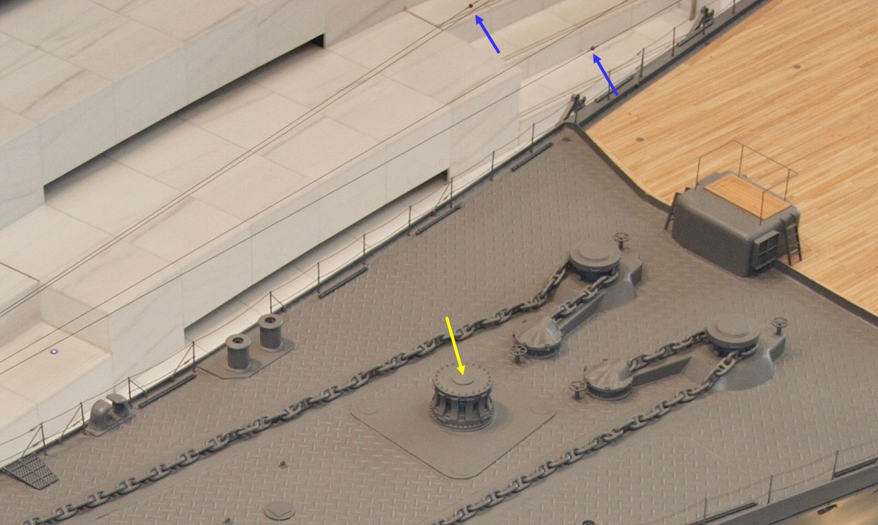

To refresh the memory :
The 4 Main Cables depart per pair from their 2 deck fittings nearby the Jackstaff. MC Nr 1&2 run over the left pulley and MC Nr 3&4 run over the right pulley of the Jackstaff towards the bridge. ( See previous rigging step 01.01.)
See Pic 001 : Use your zoom.
Light Blue Ovals : qty = 9 Brown Ball Insulators are installed on Port side Main Cable Nr 1 (MC1).
Yellow Ovals : qty = 9 Brown Ball Insulators are installed on Starboard side Main Cable Nr 4 (MC4).
The 10th Brown Ball Insulator (yellow oval) on Starboard side Main Cable Nr 4 is not visible in this picture. Keep in mind that MC Nr 1 is the mirror view of MC Nr 4.
Dark Blue Oval & Arrows: Brown Ball Insulator Nr 10 on MC 1, is flanked by 2 White Bar Insulators that are hanging on MC1. In Pic 001 you can not see much detail and therefore I introduced Pic 002.

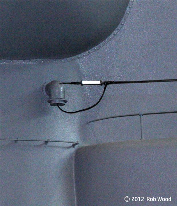

In Pic 002 you see :
dark blue oval : Brown Ball Insulator Nr 10 on MC1
dark blue arrows : 2 White Bar Insulators installed on MC1, leading 2 cables to the Front 155mm Gun Antenna. These 2 cables will be treated in a future rigging step.
Red arrow: White Bar Insulator installed on MC Nr 1 going to Bridge. This Insulator is part of todays rigging step.
Notice : from all the 4 Main Cables that travel above the Foreship, only MC 1& 4 carry Insulators. When you look close , you’ll see that Main Cables Nr 2 and Nr 3, which travel also over the foreship, have NO insulators installed.
So, where exactly is the first (front) Brown Ball Insulator installed on MC1& 4 ?
Picture 003, 004 gives you the exact location of Brown Ball Insulator Nr1 on Main Cables 1&4 versus their relative position on the Foreship.
Blue oval = location of Brown Ball Insulator Nr 1
Blue/ yellow arrow = location of Capstan on Deck
Blue/ Yellow line = vertical position of Brown Ball Insulator Nr 1 versus its Deck location
Picture 005 is a detailed view with the same subject.
Blue oval = location of Front Brown Ball Insulator
Blue arrow = location of Capstan on Deck
Blue line = vertical position of Brown Ball Insulator Nr 1 versus its relative Deck location.
Pic 006 is not a side view but gives you a better idea where the 2 Brown Ball Insulators on MC1&4 are located towards the position of the Capstan on the Foreship.
Blue arrows = location of the 2 Brown Ball Insulators Nr 1 on Main Cable Nr 1&4.
Yellow arrow = location of Capstan on Deck.

The port & starboard Perpendicular Tubes on the Front Bridge Side Structure
The least one can say is that these 2 cable-receptacles have a very unusual shape. See Pic 002-003-004-005-06-007-008.
Pic 004, 005 and 006 shows you the full package, from the Front 155 mm Antenna all the way to the port side perpendicular tube.
All those pictures give you different views from different angles at port and starboard side of the bridge, but for a real detailed view, I recommend everybody to look at the enlarged Pic 002.
The perpendicular tubes : one can describe them as big tubes, bent 90° downwards with near the free (flat) end, a reinforcement collar. A big collar is installed where the tube is attached to the Front Bridge Side Structure (wall).
And in the middle of the tube, right before it is tranformed into a perpendicular shape, a retaining flange is installed : see also Pic 001.
This “retaining” flange has a hole on the upper side where a cable can be inserted.
Let’s take a closer look at the different Cables & Stations, again in the enlarged Pic 002.
C = Cable coming from aft connector Nr 3 of White Bar Insulator
D = Cable coming from aft connector Nr 4 of White Bar Insulator
5 = front connector of the Aft White Bar Insulator
6 = aft conector of the Aft White Bar Insulator
F = attachment cable towards the Perpendicular Tube
7 = Cable attachment hole in the retaining flange on the Perpendicular Tube
8 = Cable hole in the flat surface underside of the Perpendicular Tube
G = Cable that emerges from the cable hole in station Nr 8 and returns to the front connector of the Aft WBI
Rigging Procedure (See Pic 002)
Cables D&C come from the antenna aft connectors Nr 3&4 to the Aft WBI front connector Nr 5. When looking close, you’ll see that both cables are attached with a loop to the Nr 5 front connector.
In the aft WBI connector, cable “F” is attached, also with a loop. But when you use the zoom function, you ‘ll notice that cable “F” is a double cable. It starts with a loop in aft connector Nr 6 , goes to the retaining flange in hole Nr 7 and returns to the aft connector
Nr 6 where it is attached with a second loop.
Very hard to see (because there are no clear pictures of it), but the flange with retaining hole Nr 7 bears the full weight and tension of cables C&D to the Aft WBI.
The outside of the Perpendicular tube makes no contact with Cables C&D because cable F is at the other (insulated)side of the Aft WBI.
But we still have cable “G” that comes out a hole in the flat surface underside of the Perpendicular Tube, so the contact with cables C&D is established. Cable G is attached with a loop in the Aft WBI front connector. Together with cables C&D, this is the 3rd loop that arrives in front connector Nr 5.
Notice : the 2 perpendicular tubes are installed with their flat surfaces downwards. I guess it ‘s done that way to avoid rain and seawater find their way into the tube. See Pic 002
The exact location of the tubes can be seen in many pictures but Pic 003 gives a nice overview : the tubes are installed slightly higher and behind the first Front Bridge Platform, on the Bridge Side Walls. Not the best place to be when you need to replace cable F or G, for instance….

Commenting on the statement:
"The left and right Front Bridge Brackets.
These 2 devices have a strange shape . See pic 05 -06 -08 -09.
You could describe them as big tubes , bent 90° downwards with near the end , a reinforcement collar, and an attachment collar on the contact surface with the bridge wall."What makes it so strange to these brackets is the opening for the 2 cables. It’s on top of the 90° bend, where you should not expect an opening at all"
After looking at these photos, I think there is no opening on the top of the tube, but rather a bracket to secure the two wires to the wall before entering. Similar to houses that have power cables running from the power pole to the house frame, the wire is secured with a steel cable and bolts to take the tension off of the wire, so it doesn't separate during stress. The wire is then spliced loosely ahead of the insulator and inserted through the bottom of the 90 degree tube to the wall and connected. The tube turned downwards helps keep rain out.
That's why the two wires look tight on top and you have a tube insulator on the end to ground the wire out, so the spliced looped lower wire can enter the ship from the bottom without tension on it. Otherwise the wire would swing around in the wind and tear itself off from the stress. These must be the most important wires to be treated this way.
If you zoom in really close, you can see in front of the reinforcement ring against the wall has another ring welded forward of that with a loop on it to attach the wires to. The single wire attached on the top of the tube is just a reinforcement wire attached to the insulator to complete the connection to the wall. If you noticed the two wires coming from the antenna are spliced together and then attached to the insulator, then a separate wire is soldiered to the splice which then enters the tube into the wall.
Anyone want to correct me, please feel free!
Jim
Last edited by baseballbrat on Sun Mar 19, 2017 12:23 pm, edited 2 times in total.
PostPosted: Sun Mar 19, 2017 12:12 pm
Joined: Sat Oct 15, 2016 1:24 am
Posts: 95
Thanks for this explanation , Baseballbrat.
Guess it makes sense what you tell Us. I found another picture , from Rob Wood , to get more detail of the tube upper side , where the cable comes in.
What I want to find is a picture that shows Us the front view of the tube(s) so we can see more about that loop.
But you definitely have a point on this one.
Thanks for the info.
greetz,
