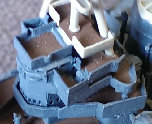

Right, here are the pictures as promised. Note the modifications to the two major bridge pieces in the Trumpeter kit.
On the upper piece (kit part F19), I drilled and sanded out the forward section to leave only the walls. I also filled the kit's ladder holes (these are incorrect) and added partial shields and a half-height ladder down to the compass platform level.
On the lower piece (kit part F13), the raised portion at the front becomes the "floor", level with the compass platform. I cut out a notch in this part to fit the half-height ladder up to this deck.
Excuse the rough paintwork on the final assembly shot, kit is still very much WIP at this point.

Cheers! I read the review of the turrets just after the last post on HMS Hood Association website and they felt that the turrets were a lot better on this kit vs 1/350 scale and I saw why. Still, your pics do show the new ones nicer. I am not so happy with the brass barrels included in Flyhawk set now that I see some other versions. So I might order those separartely with smaller caliber guns and the turrets
As for the painting - absolutely, I also noticed something was off right off the bat. Given how bad the seam joint was, I have lost the straight line division already - and will need to do the boot topping the old fashioned way anyway by putting a pencil around the whole thing. So I am aware for this, but your idea of proportioning it versus the hull height is a good one, thanks.
Are you hand brushing the whole thing or using an airbrush? What paints? You gotta have a WIP thread here, I cant find it, sorry for all the qs.

For what it's worth, the 3D printed barrels don't warp, have a good shape and a hollow muzzle. I expect brass is still better though.
I brush paint with Humbrol Acrylics and Xtracrylix but the colour on my Hood is my own mix so take it with a pinch of salt. I build fairly casually so I tend not to do WIPs unless I'm doing something weird I think others might like to see, like a big conversion project. I just photographed the Hood bridge fix because I thought someone might find it handy and you quickly proved me right!
Not sure on the degaussing cable to be honest, let's see if someone else chimes in on that.
