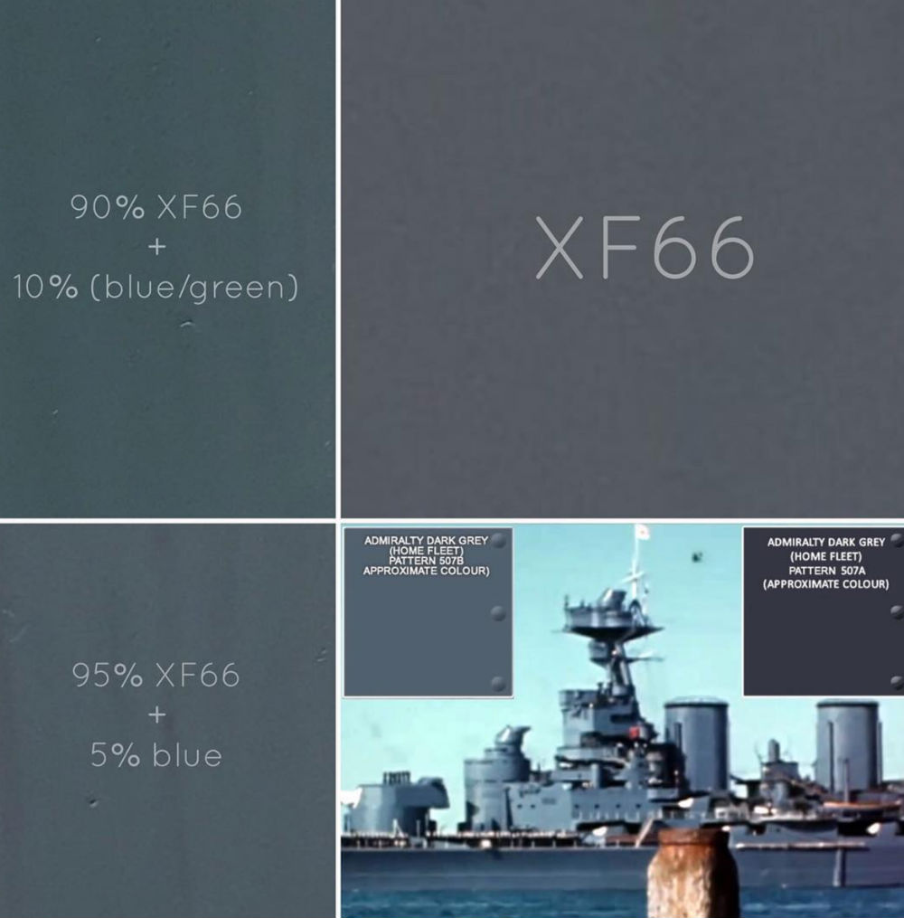

Do you have a pic of your proposed Hood 1941 paint, best you think of? To me it just would make sense it would be a darker shade of gray because 1) it would serve in Atlantic and 2) it is up north and 3) it is a camouflage that needs to blend the ship into the water as best as possible. So from all of these, a light gray makes no sense, a dark gray makes MORE sense and a shade of blue or green is only a result of reflections in different photos, film, etc and as such the hue is free to interpretation.
Here is where i am at right now after few test paints. Thoughts? The pic ofc is of Hood in 1939, but scheme stays I believe. Also, my favourite is the bottom left pic.
File comment: Using Tamiya XF66 as base paint...

No, I can't post any such image at this time. That's not to say I don't have a good idea what it looks like, but as a company in the business of selling model paints we claim to be the best quality going I can't publish anything until the research is complete.
It was a fairly dark grey with a blue, NOT a green quality. The pigments used were white, black and ultramarine blue only.

IF you look at the pic I posted - does the image at the bottom strike close or way off, in your opinion?

I think the square on the bottom left is a reasonable representation. HFG wasn't as light as S&S 507B but was lighter than their 507A. There's a lot of variance in photographs because of different types of films, different exposure times on the cameras and different lighting conditions.

Thanks! I am trying not to create too many problems for myself on this build and get too much into the weeds.
As it happens, I just purchased the 3D printed turrets that cost more than the kit, so yeah, now there is that too. :D :heh:

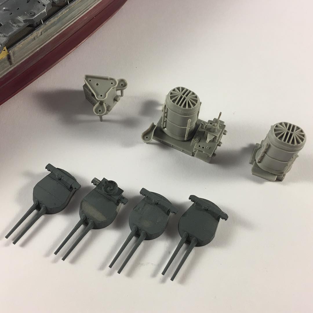

Progress - turrets arrived as well. Yes, worth the upgrade totally! Saves time on construction too and Im gonna compare - may be add those brass barrels. :) Time to set these into daylight and get them "cured".

Glad you like them :wave_1: have to point out though, you have A and B turrets the wrong way around in that picture :heh:
Well I wouldnt make that mistake when assembling :thumbs_up_1:

An update on the Hood. Few comments:
1) Turrets.
Ive received the turrets and tried to paint them. Paint doesnt stick too well, and I didnt know I had to scrape off attachment points, so that was my bad and hence you see scraped off sides of the turrets. The issue though is that it seems like the roof of the turret has a finger like texture on it and Im not sure how to properly remove it. Anyone has ideas?
2) General comment on Flyhawk as I go alone - I think it calls for the absolute top end modeller. I suspect Eduards PE set is going to be much better-stronger, even if brass is a bit thicker. I think longevity is important and I think Flyhawk is so thin you can break it by looking at it. SO thats why Im not doing cages on the funnel tops. Ill weather them best I can, and hope rigging above will distract.
3) Hood hull halves are an utter nightmare for me to merge, putty galore, etc. Im gonna do best I can and this is a hull with paint stripped from it from first try. Super annoyed but Im still hanging in there!
4) Trumpeter instructions are pound for pound worse than Revell and worse than Bismarck, and the order and logic of assembly, as well as part numbering is messed up. You just dont join A1, A2 with G3 roof and B2 rear wall to make a little box. Its like an alien came up with this system who is devoid of earth logic, but I digress.

Looking good! :thumbs_up_1:
For the turrets, did you follow all the preparation steps for 3D printed parts, cleaning, leaving them in sunlight and/or under a UV lamp for a bit, priming? If nothing else you absolutely need to prime the parts, ideally with something a bit stronger than hobby paint. I use acrylic car body primer, comes in rattle cans from my DIY store for doing paint touch ups on your car. Not sure what brand you have where you live but there's bound to be an equivalent.
What attachment points? I don't recall having to sand anything off on my turrets.
The texture is a result of the 3D printing process, it's basically the rows it prints in. It doesn't bother me that much. I've seen threads on this site where people go to great lengths to smooth it (there was talk of lightly sand blasting the parts) but for me a couple of layers of primer and then paint does the job of covering it very well.
