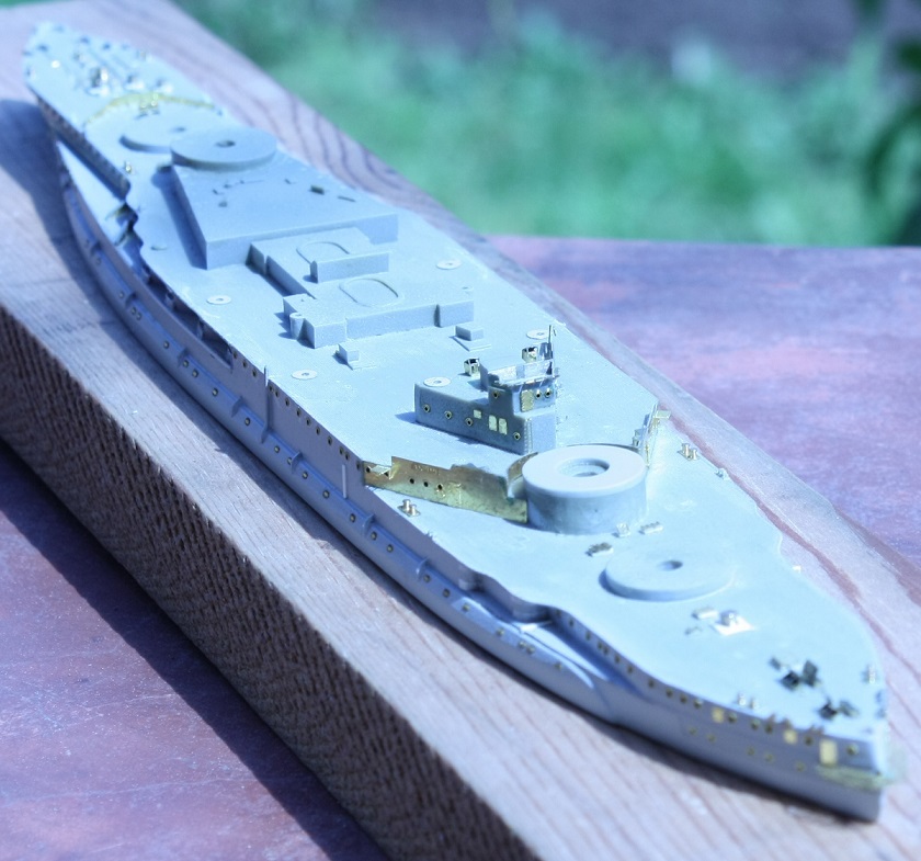

With the deck fittings ready for later painting I turned my attention to the superstructure. For some reason I decided to move from aft to fore, so the bulkhead on the after end of the forecastle came first. This I took from Artist Hobby’s excellent WWI Warspite set. When one side was glued to place I recognised that something was wrong. The bulwark of correct height was higher than barbette X. Measurements confirmed that the kit’s barbette is not high enough. I went on to correct this flaw by cutting a disc from the Trumpeter kit’s respective barbette, glueing it on top of the existing one and sanding the side flush, which was no easy business as the PE bulwark on one side was already in place.
After attaching the other bulwark I replaced the nameplate with one indicating „Barham” from another, really crazy set of Artist Hobby containing nameplates for most important British ships and more hundreds of individual letters.
Next I attached reinforcing ribs cut from aluminium sheet to the backside of the bulwark and a piece of sterched sprue on the top edge.

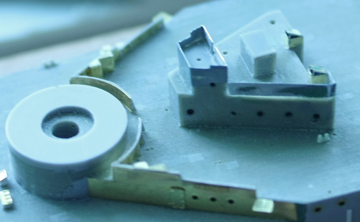

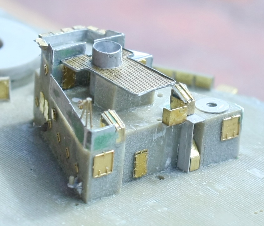

I went on to detail the after superstructure. In the Profile Morskie plan there is a structure on the aft end whose outline is not confirmed by any other source. Therefore I didn’t accept if and came to a solution which is mix-match of information from various sources and probably not correct at all, but I just couldn’t do any better from what I had. I cut off the bulwarks deeming them too thich and replaced them with aluminium sheet. Sanding them flush with the sides of the superstructure was tedious.
I embellished the superstructure walls with everything necessary

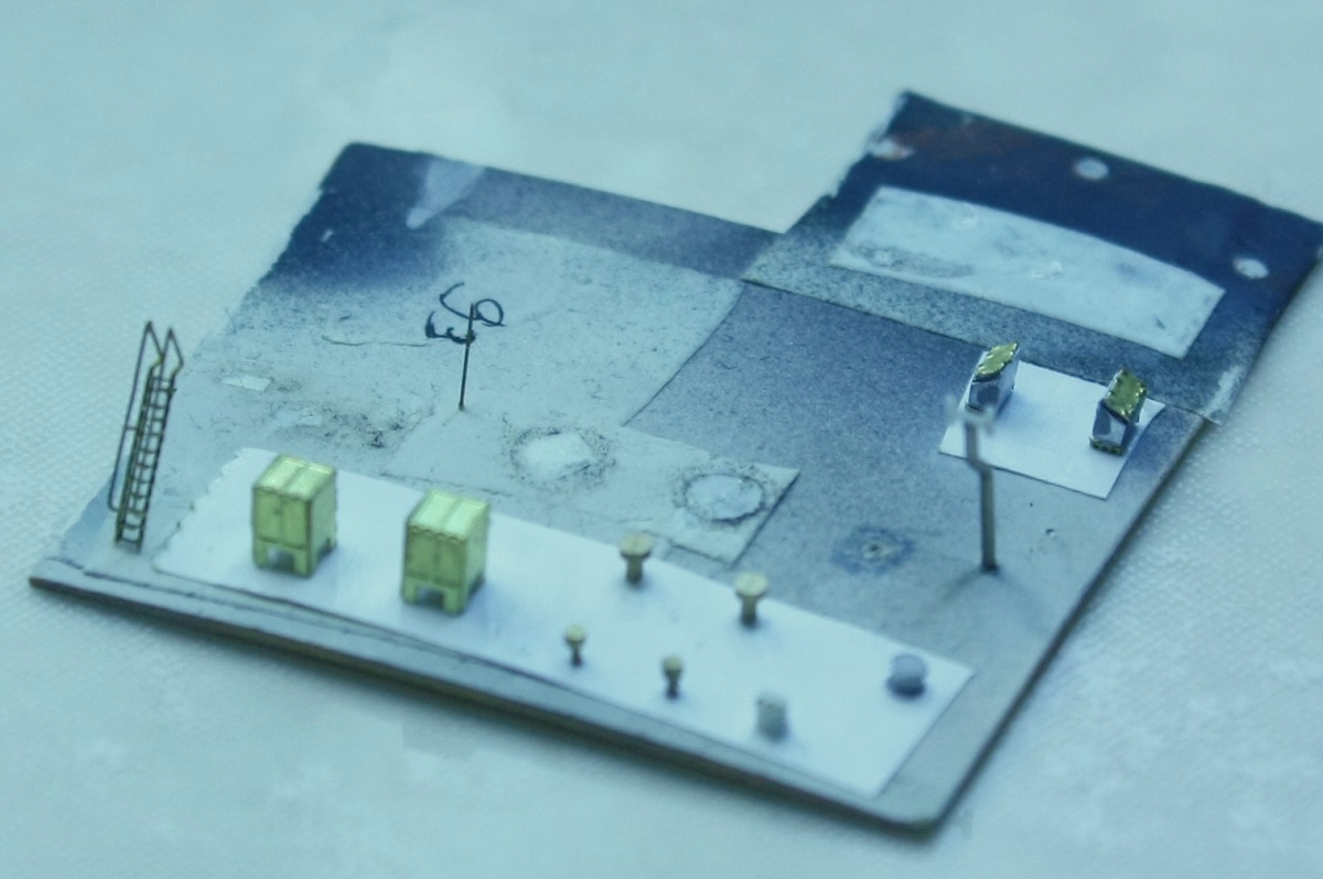

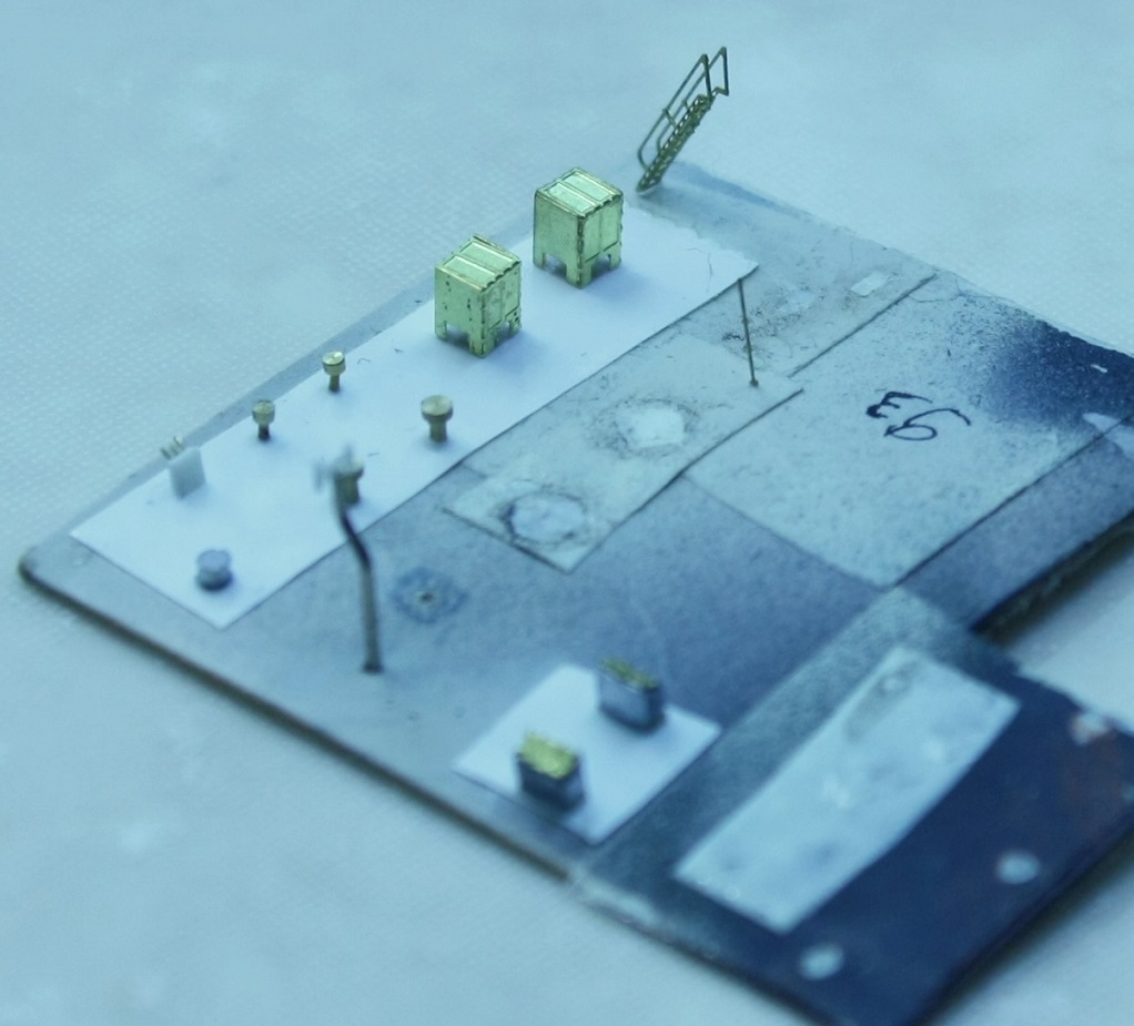

and glued other fittings like two beautiful fresh water tanks from Artist Hobby to a piece of cardboard dedicated to this deckhouse.
I used the ammo boxes for the 0,5’ quad AA mountings form the FlyHawk Warspite set despite these having some issues. First, there are only six of them and I will need eight. Second, their shape is rectangular cuboid which is incorrect. The top should be oblique. I cut one from the sheet, glued it to a piece of aluminium sheet, marked the outline, removed the PE part cut out and folded to get an additional box. I modified the PE part to alter its shape and attached a PE hatch on top.
This update has obviously become too long and detailed. I just wanted to show that not all time has been wasted in the past few months.

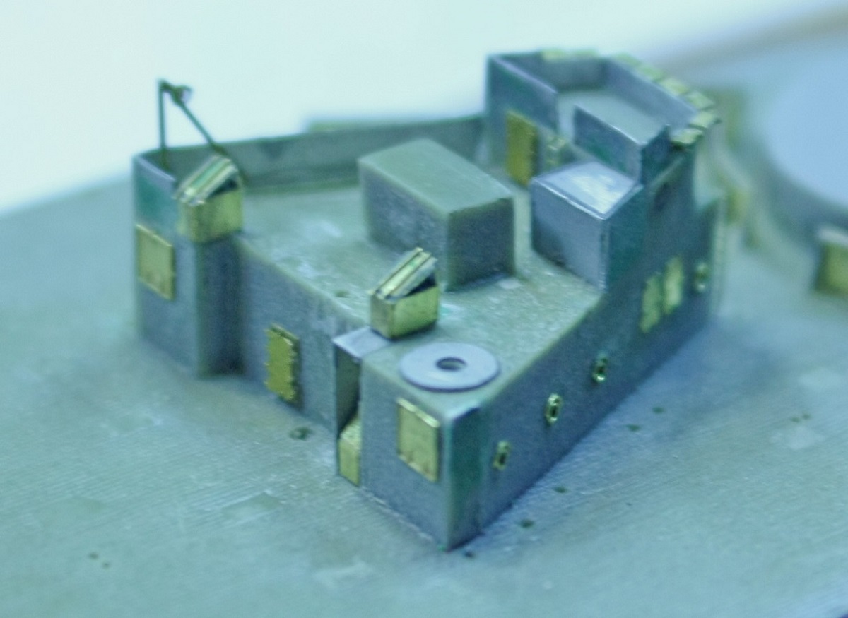

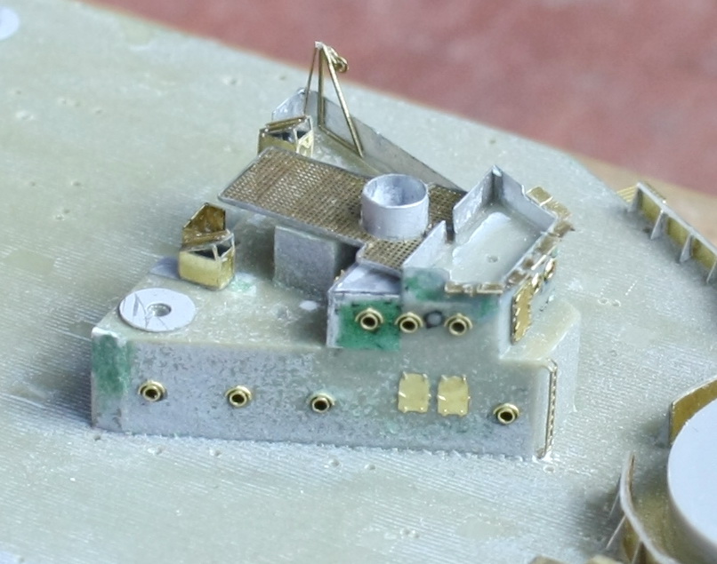

Sometimes it’s harder to proceed with a build if you get additional information during construction. We’ve been through several discussions with Richard Price who builds another, most spectacular Barham about the possible layout of the after superstructure. This led me to rebuild mine to a certain degree. I added a small extension to the port side of the AA platform made of aluminium sheet, then I changed the front face altering the position of the port side vent exhaust (a change possibly necessitated by the fitment of the aircraft handling crane). This was based on a picture found in the Raven-Roberts book about British battleships.
Next a light mesh platform was constructed the exact shape and size of which is not deducible from the available sources, one can only be sure that it was there.
I’m certain that this final configuration of the after superstructure isn’t 100% correct but I’m not willing to spend any more time on refining it. I think we (Richard and I) still did our research more thoroughly than the maunfacturers of existing kits of Barham.
