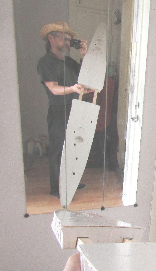

hi,all
Feeling urged to post something re. a new build of this class cruiser and by Dan´s recent suggestion,almost everything is in a slow-motion picture. Have so far managed to form the hull (in waterline, again!) with some difficulty as i had to make drawings by myself in 1/00 as a starting point. Firstly,the bread & butter in two sections,so i can have it seperated in case it needs to be transported in the future.
mucho,

PostPosted: Fri Nov 10, 2017 7:58 am
Posts: 8572
That. is. COOL.
Thx, Mucho!
