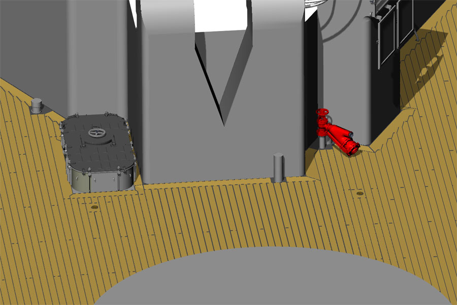

I have been very busy with other non-modeling projects but I have finally gotten back to work on the wood deck. It is tedious work.
I have been scrutinizing photographs to determine how the planks were laid. I know from the blueprints that the boards were no longer than 18 feet, and it looks like they were actually cut to increments of 4 feet, coinciding with the frame spacing on the ship.
However, this forward extension appears to have been made with some scraps, so the plank lengths are somewhat random, and not always laid down in a regular pattern. Most of the rest of the deck does appear to be in a pretty regular pattern except at midships where the original two level boat davits were replaced with a single davit set on the starboard, and no davits on the port. It looks like the planking in these places has a lot of patches.
The forward part shown here was not on the original Clevelands. It was added to some of the CLGs, but no two are alike.

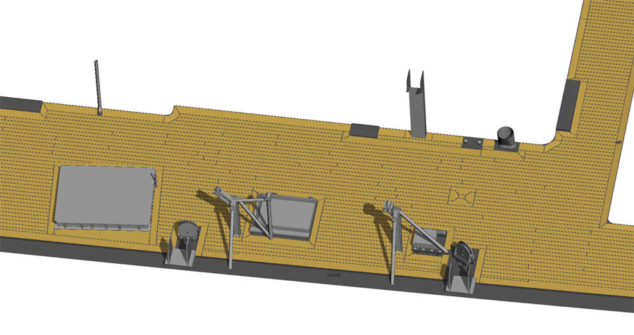

The wood deck is finished, all bazillion planks, margin boards and grout lines!
For most of the deck the pattern repeats every fourth plank, with the nominal plank length 16 feet (four frames). However, amidships the ship had a lot of modifications and the pattern is pretty scrambled. I used high resolution photos to determine where plank ends were positioned, but that didn't give me the entire pattern. This is my best guess.
There are a few finishing touches to do before I copy the deck from the working file and paste it into the full hull file. Then the hull will be almost finished (I need to add the trash chute at the stern).
Then the entire CAD model will be almost finished. I need to rework the AN/SPS-30 on the after radar tower, and maybe a few other small details. Then all I need to do is paste together the hull, forward, midships and after superstructures and it will be done!!!!
I don't know if I can actually do that. The resulting file will be about 1 gigabyte and will have about 2.7 million drawing entities and about 21 million points (these are the sums of the separate files, and there is a bit of overlap so the final numbers should be a bit smaller). I don't know if anyone has ever constructed a file that large with DesignCAD. There may be some variable(s) in the program left over from 32 bit days that just can't hold numbers that large.
Wish me luck!

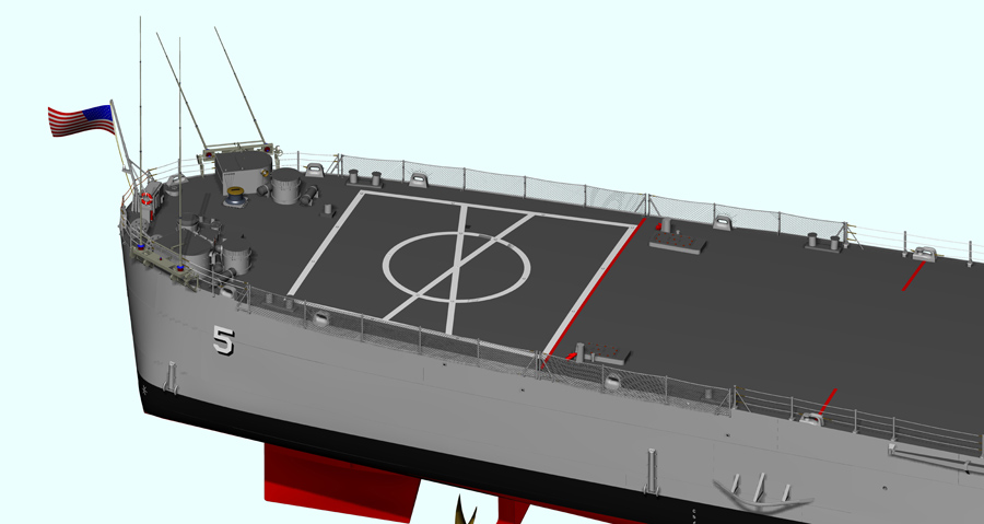

Here are some pictures of the completed hull!! Well, almost - I still need to add the trash chute at the stern.
The hull shell took quite a while - it is built up of individual plates just as shown in the Cleveland blueprints. It has about 480 plates in 15 strakes, with each plate shaped and curved to fit the hull frames.
The lifeline stanchions were another custom fit project. Each is mounted on a frame that spans a 15" waterway at the side of the main deck. The hull plating extends above deck edge at the waterway, and the height varies along the length of the ship, so each stanchion base is adapted to the height and angle of the shell plating. No two are alike, but fortunately most of the port side were the mirror image of the starboard stanchions.
The fold-down life nets around the flight deck were another tedious job. Again the two sides are mirror images so I only had to do one side and then duplicate and mirror it.
And then there is the wooden deck, with each plank and grout line done individually. Only a small part of the two sides were mirror images.
505,959 drawing entities with 4,159,420 points.

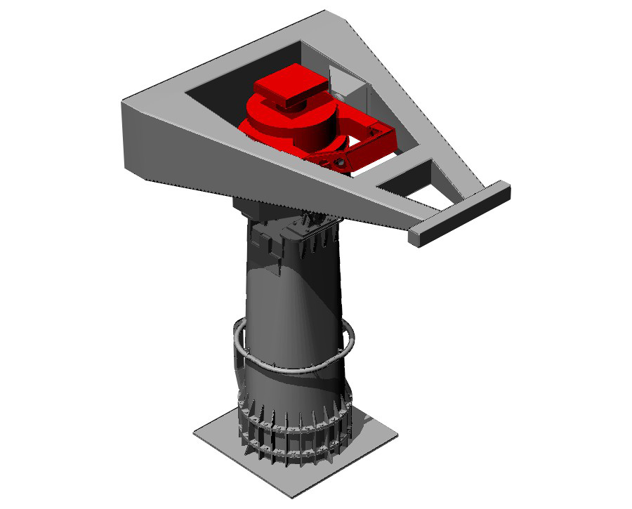

The base supported a roll platform that pivoted along the fore-aft axis on bearings on the base tower. This was driven by two motors (not modeled yet) that corrected for the ship's roll to keep the antenna horizontal port/starboard. Above this was the pitch platform that pivoted on the port/starboard axis on bearings supported by the roll platform. Again, two motors (not shown) corrected for the ship's pitch to keep the antenna horizontal fore/aft.
The red part is the rotation platform that supported the elevation platform and rotated 360 degrees around the vertical axis on bearings on the pitch platform. It was driven by a large motor (not shown) mounted on the rotation platform. It is red because I have not finished with the basic shapes.
The rectangular box at the top rotated with the rotation platform. It contained electrical slip rings for power and signals to the elevation platform. It also contained the rotating wave guide joint for the radar signals to and from the feed horn.
File comment: The elevation platform.
The elevation platform was a large box structure that pivoted on bearings in the rotation platform. A motor (not shown) on the back end of the rotation platform (where the holes are) pulled the cross member up and down to change the elevation of the antenna. The long feed horn and parabolic dish (not shown) attached to the front of the elevation platform.
File comment: The rotation platform and elevation platform.

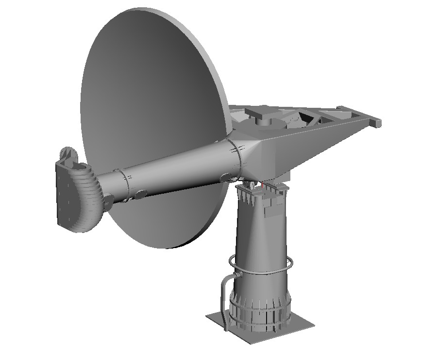

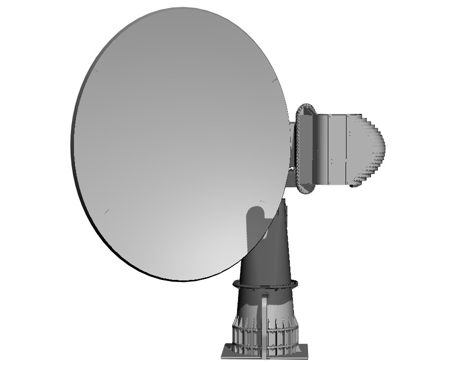

I haven't had a lot of time to work on the AS-1167/SPS-30 antenna, but I did get a bit more done.
I have added the support arm and scanner head, and I am working on the reflector dish.
The dish was a surprise. Originally I thought it was an ordinary circular parabolic reflector. But I have obtained drawings of the SPS-30 and the dish was actually elliptical, with the major axis vertical! That posed some interesting problems for modelling because the edge of the dish was curved both in the plane of the dish and perpendicular to it!
The "organ pipe" scanner head is interesting. To get rapid vertical height-finding scanning it has a rotary waveguide switch inside the cylindrical part that directs RF energy into one of twenty equal-length waveguides arranged circularly around the end of the cylinder. The waveguides then fan out into a parallel bunch that wraps around 180 degrees and then bends around to the feed horn. A RF transparent cover over the end of the feed horn allows the entire waveguide assembly to be pressurized with dry nitrogen to prevent internal arcing with the 2500 kW peak RF energy.
Because the feed horn ends are stacked vertically, each beam strikes the parabolic reflector at a different spot and is projected outward at a different narrow (1.2 degree) vertical angle. The vertical scanning rate was controlled by the rotating waveguide switch RPM from 240 to 2400 per minute. Pretty clever!
The entire reflector assembly could be tilted from 6 to 30 degrees above horizontal for coarse elevation control, and then the multiple waveguides provided fine elevation sweeping. The antenna could rotate around the vertical axis in a full circle at 1 to 10 RPM.
