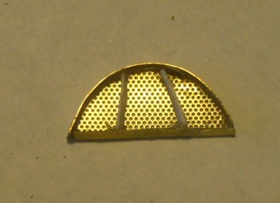

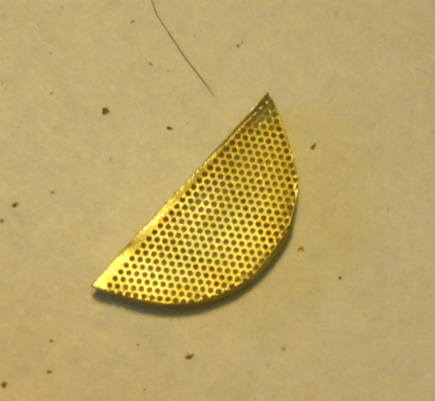

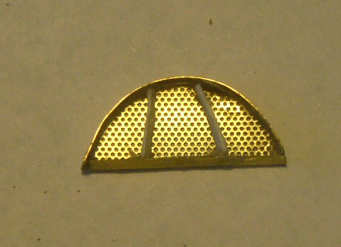

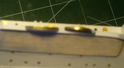

It's not that I haven't been working on the lady but that what I am trying to do has been so frustrating! Getting the grated deck to both form and scale is driving me nuts. Ok that's a short trip so no comments. I tried using styrene strip but couldn't get the curves to hold. I tried everything from candles to small torches. It was either too cool to make it hold or too hot and it shriveled like spaghetti. I finally settled on bras and that is another can of worms. I got strips cut from my sheet, formed, and decked over with the grating. The brass strip is too thick so now I'm starting with a thinner one. I still can't get it as thin as it should be but as with some things in scale you gotta go with what you CAN do. So I have all twelve platforms done but only one has the thinner strip. I now have to go back and change the other eleven. I cropped a photo from Squadron at Sea to show how thin these decks really were but it's kind of fuzzy. Same for the one where I show the two different ones side by side on the port forward sponson so you can see what I'm talking about. Will still have to do the supports and then the hinged support once they are in place.
My pics are a little fuzzy today. Camera? Photographer? Whatever they're fuzzy.

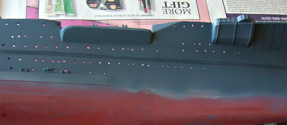

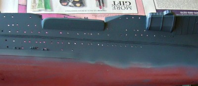

OK. I think I have found a way around my funk and have done some painting to get going. Broke out the airbrush and primered the hull. Noticed a few things that need attention but moved on to doing the gun forward pockets. First airbrushed the bulkheads and then brushed the decks.

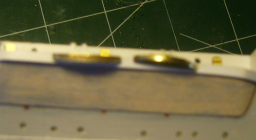

I had to enlarge the cutout on the underside of the flight deck and also painted them. At least now I can Get that glued back on.

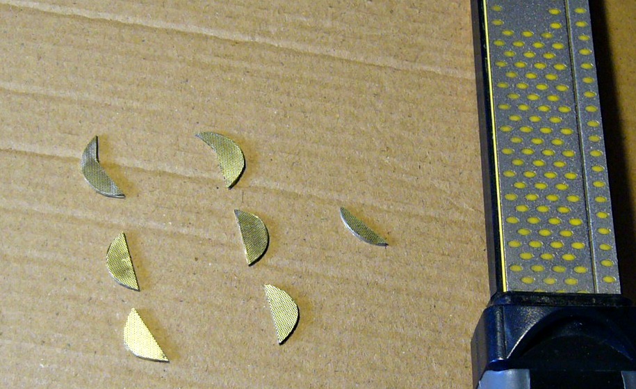

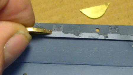

Now for those pesky fold up decks. I brought my fine/coarse diamond file in from the wood shop and patiently
filed them from a .85 thickness to .45. Could probably do a little more but not sure they would hold up. Its that what is feasible not what is the actual scale dilemma. So I have the six for the forward platforms now just need the six for the aft ones.
For some reason my photo editor was acting up this morning and I had to switch to a different one. Got the job done so that's what matters. Now to wait for some replies to my posting on the main forum and then move on.

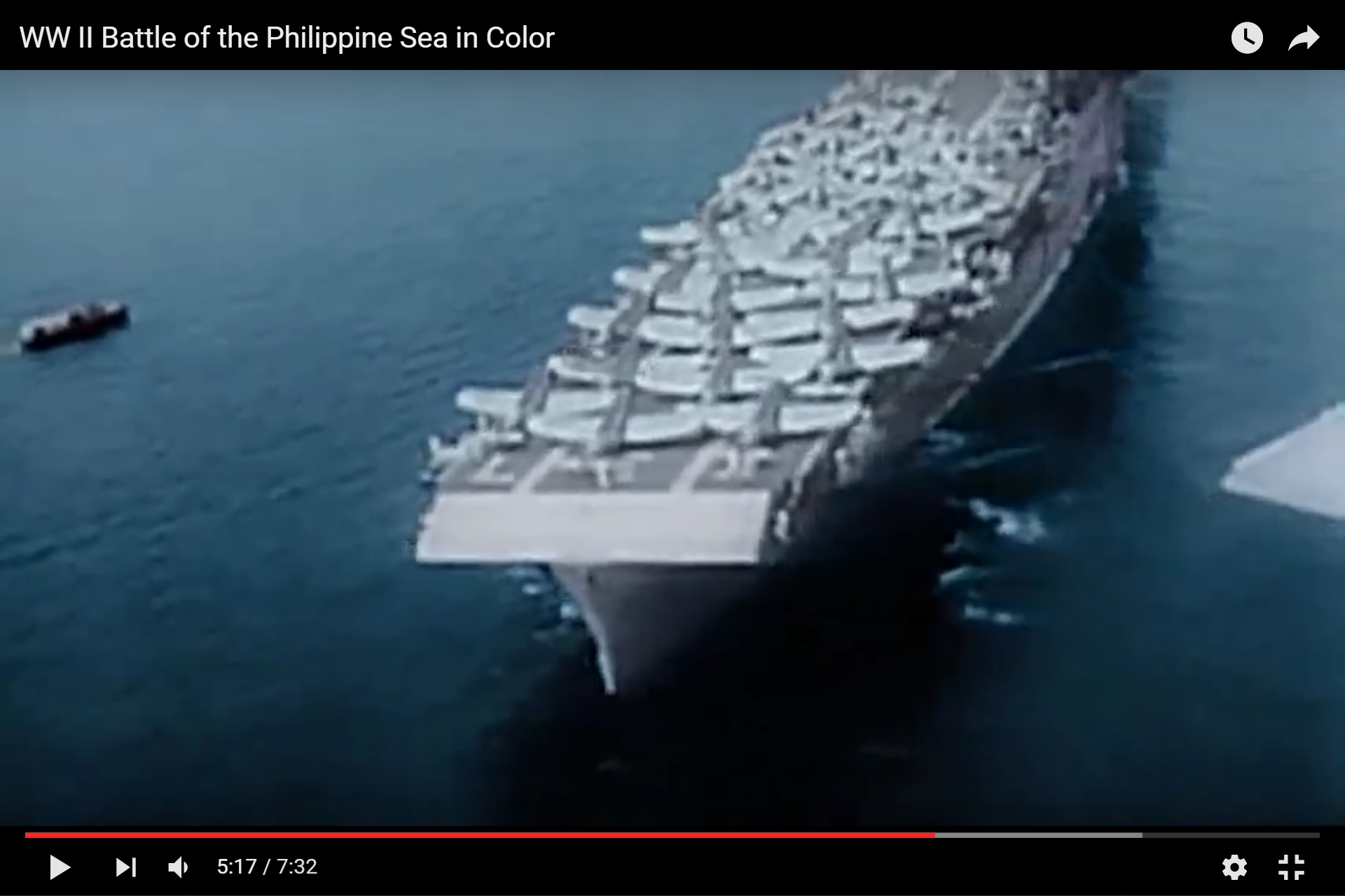

I just caught a glimpse of the Lexington last night, as I was browsing through one of the rare color videos from WWII.
Shortly after the 5:10 mark into this film on the Battle of the Philippine Sea, you see a brief shot of LEX CV-2.
https://www.youtube.com/watch?v=u5l6HEkKdjY
Now, I'm aware that she had already been sunk over 2 years prior to this battle, so her place in the film is a simple mistake.
But, of other interest is that the film is mostly in color. In this short glimpse, her flight deck appears to be an odd gray color, with lighter-colored lines and L E X markings.
Is it safe to say that this is a false-color modification, generated from a true black & white film?
The water is a realistic-looking blue, but I thought Lex's early flight deck was a darker brown with yellow markings. This would support the case of it being a false-color film.

In late 1941 her deck was a gray-blue with those light colored markings as you saw. I'm on my phone, otherwise I'd post links to the pictures and to my build log of Lexington (you can find it in picture post: works in progress, probably in the second page).

Here's a screenshot from the film posted by Jim - had no idea she still wore LEX at the stern when the deck was painted in war colours.

It's colorized and not original. The lack of the red dots in the national insignia and striped tails of the aircraft I feel say water colored but ship and aircraft not.
Just my $.02

Martin, thanks for the welcome.
Abram and Timmy thanks for that photo. I also think it was colorized but it's a great shot of the deck lines and LEX on the aft section. I had already decided that was how I was going to depict her when I got to the deck but now I feel confident instead of just "Well that's how I think it was".

Tail stripes didn't come until the end of 1941/beginning 1942. Check out my build log for pictures of the ship in this time period: 1/700 Lexington 1941. Sorry to hijack the thread for a little bit.taskforce48 wrote:It's colorized and not original. The lack of the red dots in the national insignia and striped tails of the aircraft I feel say water colored but ship and aircraft not.

Rudder stripes came into effect sometime in October 1941, if I recall correctly.
