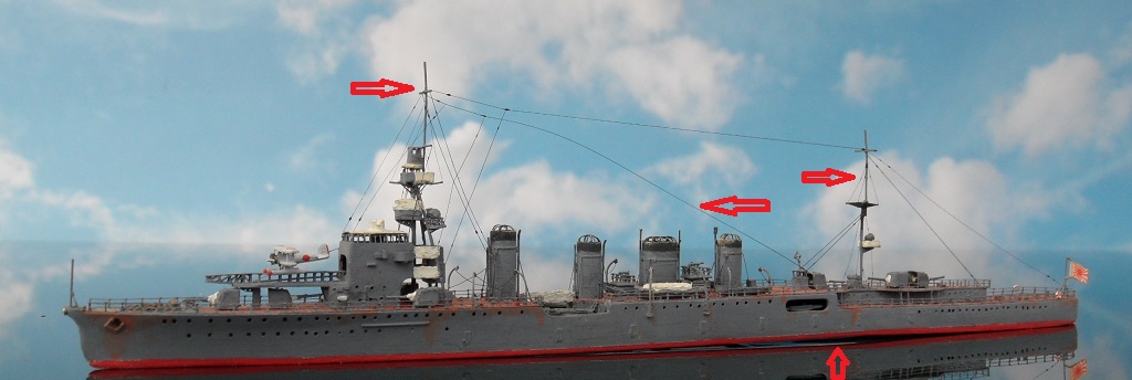

I build the Jintsu 1996…Unfortunately it is damaged (red arrow)

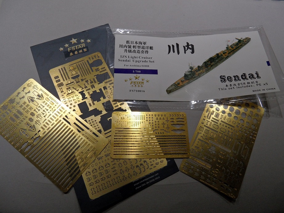

Last year i get the photoetched parts from Fivestar and I planing the build oft he Sendaiclass

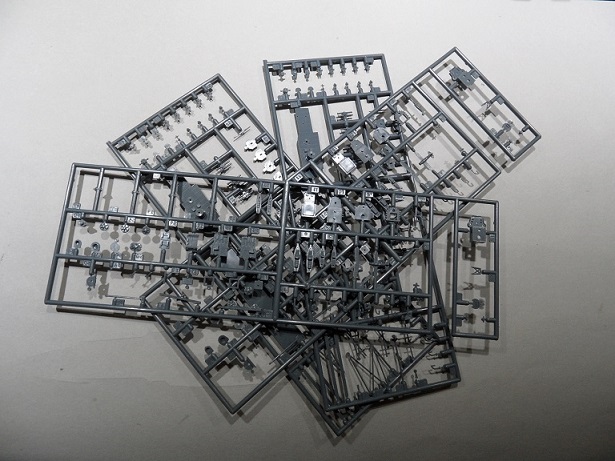

I use the hulls from the old Fujimi kits (bought in the year 1984) The rest from the kits are for recycling…

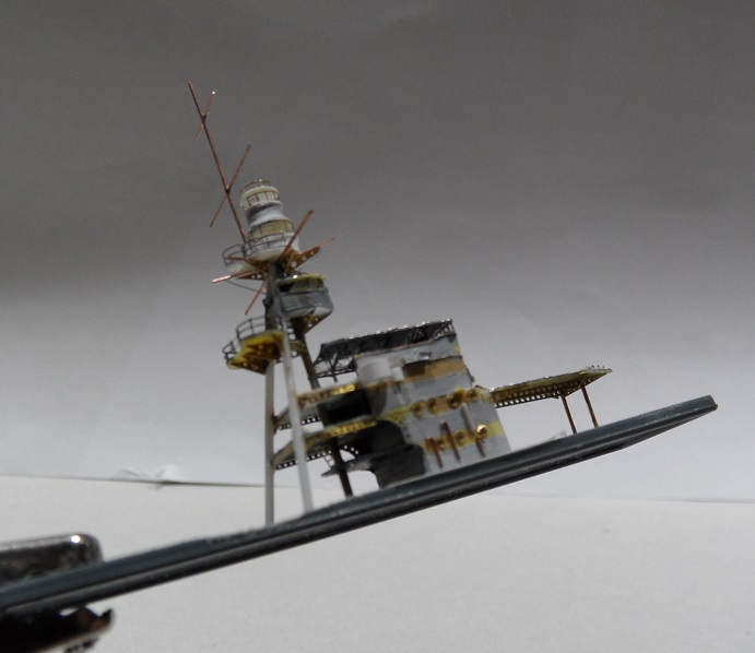

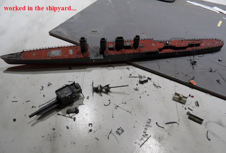

I would like the JintsuI to get something from the old building receive. but I want to optimize them

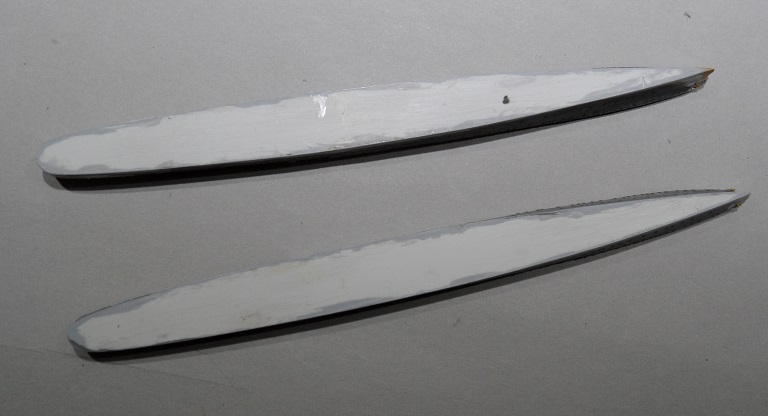

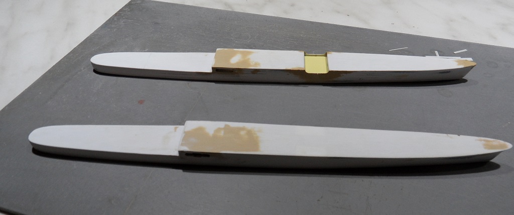

At first I start with the hull’s oft he Jintsu kits. I'll show you the pictures…

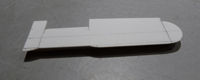

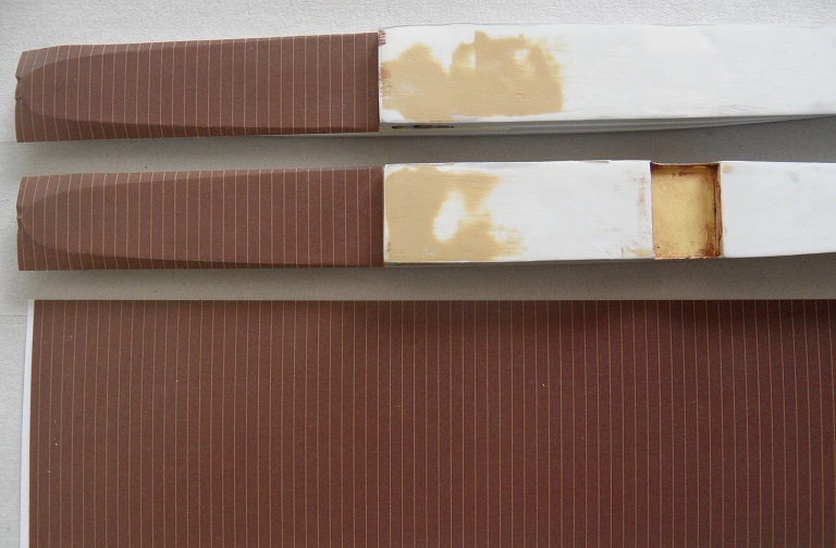

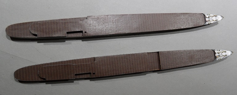

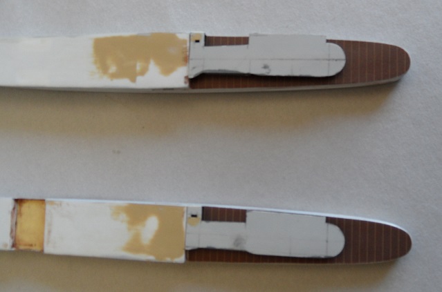

At next the rest oft he middlesection, but first I have to glue the linoleumstructure of the upperdeck.

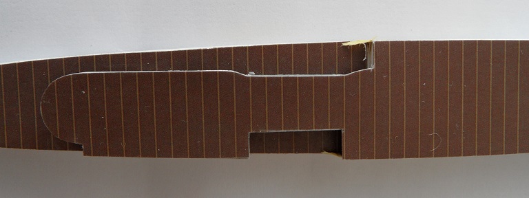

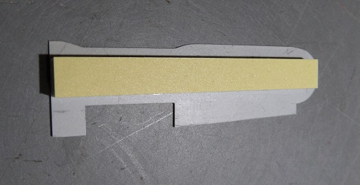

Linoleumstructure -the trick is simple.I make a copy from >basic linoleumstructure < and later I paint this sheet with matt 2k clear coat - the surface is protected

You know, with the proliferation of laser-cut wood decks out there, for all sorts of ship types and classes, for a long time I've been wondering when someone would come up with a similar system for Japanese linoleum decks. Especially considering how tiny the tie-down strips are in-scale in 1/350 and up.
Paper does seem like the proper medium, or possibly decals; linoleum itself is far too thick to do the trick in just about any scale.

Hasegawa makes a paper linoleum with glue backing.

the ship in the middle,is with Hasegawa Linoleum,the ohter Units with paper copy inkl. clear coat matt

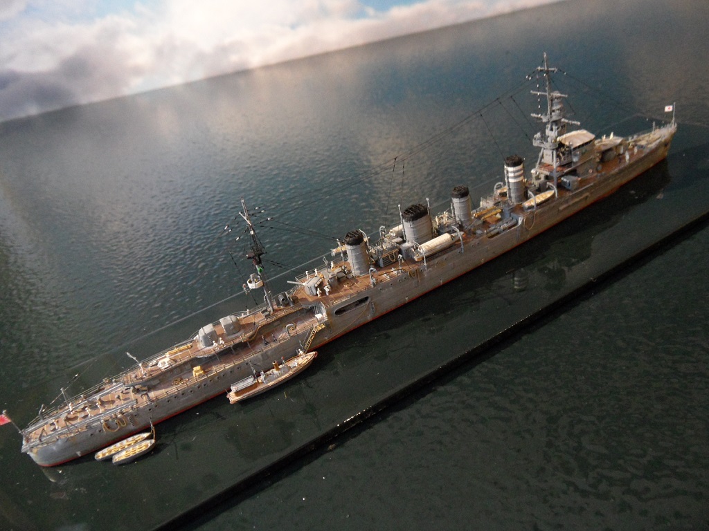

Hallo Gentleman,sorry my report is a bit slow...

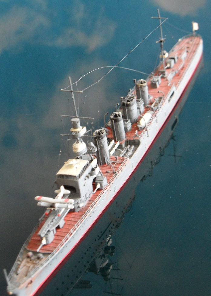

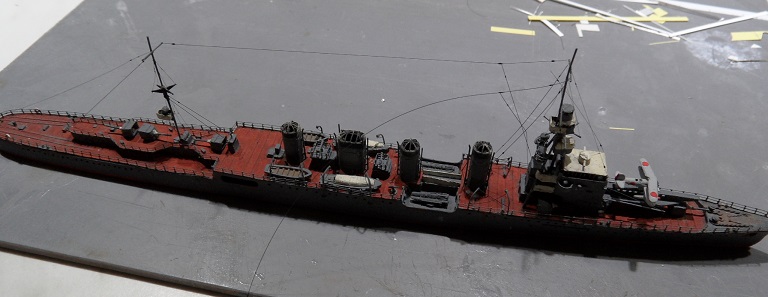

at first - here a Picture from the complete Jintsu in 1928

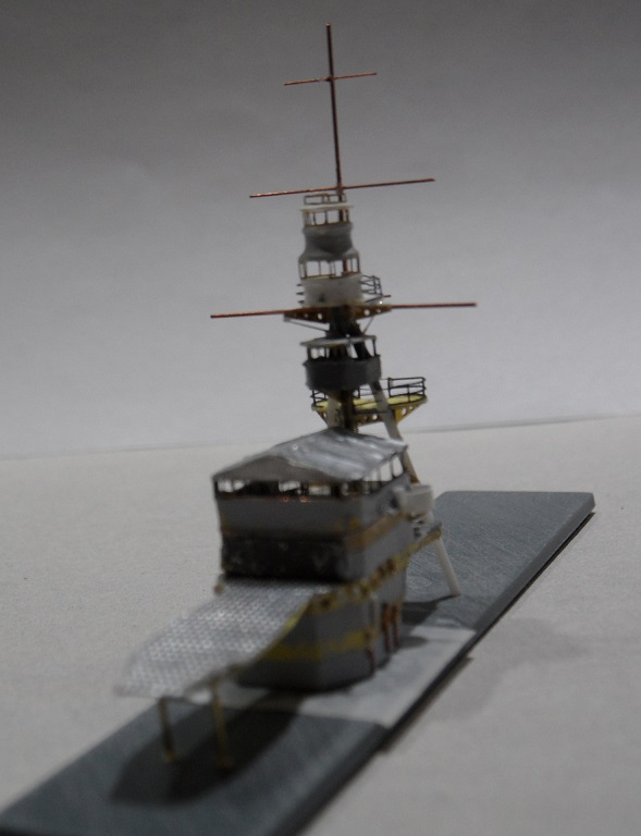

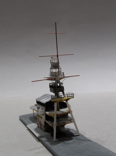

and here a lot of photos from the Bridge of Jintsu in 1928.
It's complete scratchbuild

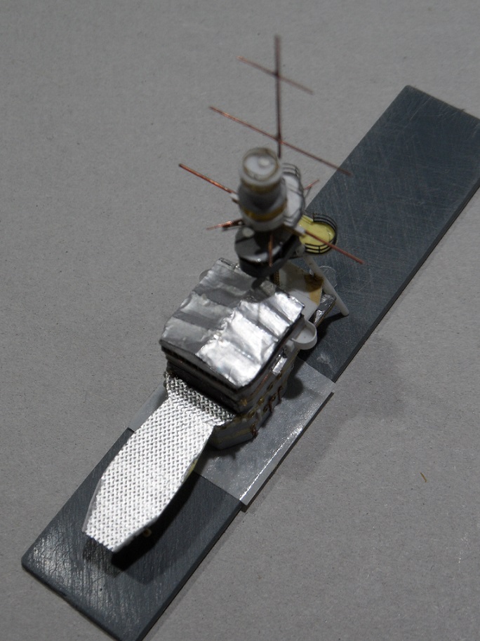

Love this! Where are you getting the pleated steel covering? That looks brilliant!
- Chris
1/700 Murdertorpedoboat Ooi
PostPosted: Mon Mar 26, 2018 12:51 pm
Joined: Sun Jun 21, 2009 12:26 pm
Posts: 67
Location: Deutschland
PetrolGator - It's very simple...
I show the procedure here :
http://modellboard.net/index.php?topic=33597.0
enjoy :-) do you have question,please
