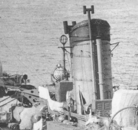

Then I started evaluating the PE deckhouses against plastic kit parts and photos. The aft deckhouse/gun platform looked fine to me and dimensions corelated with the kit, the only difference I noticed was that the small deckhouse on the gun deck appears to be hollow on the Kamikazes and Mutsukis! It can be seen clearly on the Hatakaze photo and many others, if examined carefully. The sides and roof of the deckhouse are rounded. So I cut this upper part off the PE and modified it accordingly. Agreed?
Searchlight deckhouse/RDF platform
Now we come to the searchlight/aft steering/RDF platform aft of the #2 funnel. Neither the PE part not the original kit parts match what I can see on the Kamikaze-class photos but in this case perhaps the kit parts may be a bit closer to reality for early-type Kamikazes (it seems the Mutsukis and perhaps late-type Kamikazes were more different there). (Edit: the PE part is 8,3mm long vs. plastic 6mm)
PitRoad vs Rainbow instructions searchlight platform.jpg [ 122.11 KiB | Viewed 3834 times ]
It appears the platform had two levels – higher and wider (edit: it looks wider on the Kamikaze but same width or even narrower on Yunagi, check photos below) for the searchlight; and a lower level where the open aux steering was originally and where a small box-like structure with the RDF aerial on top was placed later. Excellent reference here provides an IWM film showing (from approx. 8:20) Kamikaze in Singapore after surrender:
Kamikaze 1945 Singapore post-surrender from IWM film RDF platform2.JPG [ 55.33 KiB | Viewed 3834 times ]
In between the two platform levels there might have been an inclined ladder with its railing covered with canvas (just like the ones on both platform levels) – check the Yunagi 1936 photo.
I think there maybe was an additional difference between early and late-type Kamikazes – the film (Kamikaze herself) shows a noticeable gap between the RDF platform and the funnel (note the torpedo reload stowage was already removed here), while Asanagi (late-type Kamikaze) on the 1926 broadside photo shows the steering platform extending towards the funnel (above the torpedo reload stowage). What do you think?
“Perforated triangles”
Notable above are also perforated "wings" or "triangles" extending to the side behind the searchlight platform on both Yunagi and Asanagi photos. I only noticed them just now, I wonder what was their function?
Note also the vent shown on VAN´s drawing is missing in the film (Kamikaze) vs. both Yunagi and Asanagi photos show it clearly. This vent also appears narrower on late-type Kamikazes when compared to Mutsukis and the Rainbow PE.
Your comments on this part would be highly welcome!

I think the RDF platform as seen in the Yunagi and Kamikaze pics is probably correct. I found this late war photo of a damaged Harukaze showing pretty much the same thing. I'm looking for a better quality version, if I can only remember which Gakken volume that it's in.
HARUKAZE-stern-damage after torpedoing, Luzon Strait off Takao, November, 1944.jpg
HARUKAZE-stern-damage after torpedoing, Luzon Strait off Takao, November, 1944.jpg [ 264.48 KiB | Viewed 3774 times ]

Searchlight deckhouse/RDF platform (continued)
So what I now consider doing is cutting the PE part along the red line (of course also in the other plans). The blue area is where the vent will go. The upper edges of the vent are rounded on the photos, so I´d create it rather from a styrene sheet instead of using the relevant PE part. It´s hard to judge if the result will be correct from the overhead view but without any other reference there´s probably no help.
The photo of Mikazuki (Mutsuki class) under attack shows more details of the two levels and the RDF deckhouse. Here the searchlight platform overhangs further aft and the proportions of the two levels are different from Kamikazes though. There is a “perforated triangle” visible, but it may also be a support of the overhanging platform in this case, so no definitive answer yet for a late-type Kamikaze.
Any ideas/comments highly welcome!
