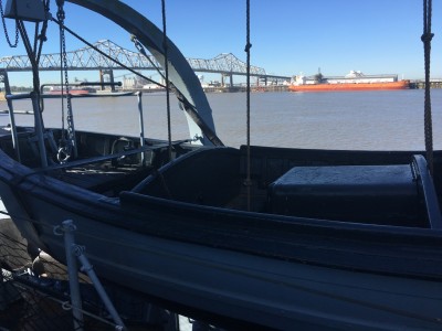

MartinJQuinn wrote:
Ok, I just went through this whole thread before asking this question...(I had a 2nd question answered by 2 hours of reading)
What colors were the boats carried by the Hornet? I'm guessing the hulls were 5-0 to match the bulkheads around them, but what about the rest of the boat, specifically the tops or insides?
Further bit on the boats. The anti-fouling was typically painted black. The top was painted the deck color and the hull and any thing sticking up was painted the relevant bulkhead color. If the bulkhead behind the boat had more than one color they typically matched (like splinter shields did). But in the case of the Hornet that was not an issue. Canvas tarps might have been or not have been painted depending on the case. These three pictures are from the USS Kidd (sorry about the quality of lighting, it was on my phone when I was in Baton Rouge). I know it is not the same paint measure but what I mention is still valid.
I will go through what I have on CV-8 and see what I can get you.

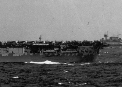

PostPosted: Wed Mar 28, 2018 8:27 am
Posts: 1381
Okay I have two more crops. These are of CV-8, but the clarity bumped in too much is not great. Given what I shared above you can likely make out what I was talking about. The painting was SLIGHTLY changed post Midway when they changed her radar and AA loadout.
Pre Midway
Santa Cruise
Gabriel

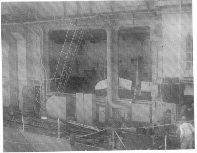

PostPosted: Tue May 08, 2018 9:48 am
Posts: 1381
Here is what I have involving either the hangar or the deck railings around the elevator on the Hornet. I would also recommend looking at the "Warship Pictorial #44 Yorktown" as there are 3-4 pictures in there that are great of CV-5. I had a photo somewhere that I can not find at the moment which showed planes in the hangar with at least one plane and several spare parts hanging from the support beams on the overhead.
5F1   NOTE DARK STRIPE R SIDE OF FLIGHT DECK..tif
Gabriel
