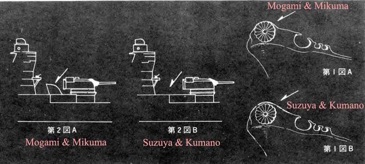

And not an expert, but to convert the 1/350 Mogami into her sisters ,I don't think will be very hard,maybe our IJN sensei Dan Kaplan can comment on this.

Well, a conversion is possible, though there are differences that need to be taken into consideration. The upper hull and 01 High Angle Gun Deck are different, as are the arrangements at the base of the superstructure. Some of these references have been posted previously, but these should be a little larger.
