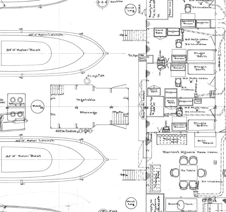

This drawing suggests that the sides do extend all the way down to the deck.

 Post subject: Re: At 'Em Arizona Fans!
PostPosted: Fri Jun 01, 2018 10:21 am
Joined: Mon Apr 13, 2015 2:16 pm
Posts: 156
If you look at the main deck drawing of the Arizona on Tracy's website, it appears that bulkheads make up the lockers and the port side locker is smaller than the starboard side, unlike the Pennsy which shows them equal in size. This is why I think the plans I mentioned in my original post are correct in that they do go all the way up to the bottom of the overhanging vegetable locker.
http://www.researcheratlarge.com/Ships/ ... 85-3_a.jpg
PostPosted: Fri Jun 01, 2018 12:03 pm
Posts: 999
When the ship was prepared for the memorial, the boat deck and casemate bulkheads were removed. This included removing the top half of the vegetable locker. If those wings on the sides of the veggie locker were still free floating during the attack like the original configuration shows in that 1st pic Larry posted then both wings would have been completely removed and would not show up on any of the Park Service drawings. The drawings show bulkheads on both sides attaching to the break in the deck bulkhead.
I am now leaning towards a modification took place at some point in her career that added those wing bulkheads that enclosed both sides. That portside locker that is labeled as such on the plans I believe now was inside the enclosure.
