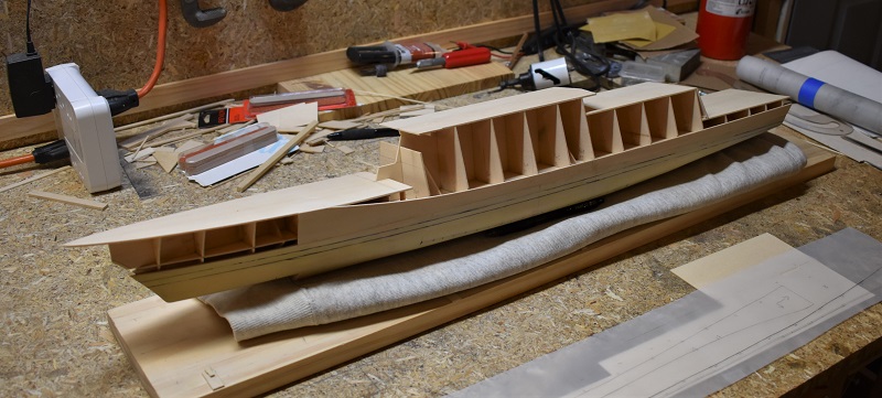

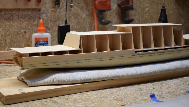

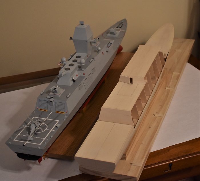

The first image shows glueing the roof onto the top of the superstructure with a little weight on the board to keep the sheet of wood from curling up from the glue. The second image shows the aft starboard side where I've started plating up to the side knuckle. The third and fourth images show the port side with the lower edge of the knuckle fully defined.

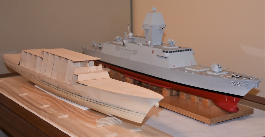

These two photos compare the FFG-63 design under construction with its prototype FFG-62, completed 8 years ago.

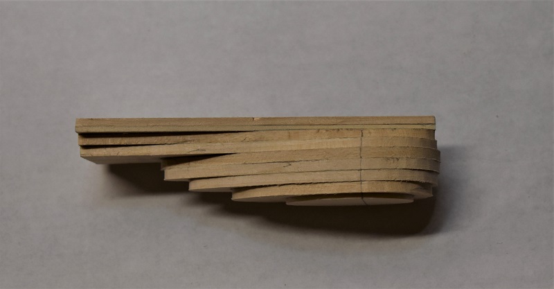

I roughed out the sonar dome this weekend. Actually, I did it twice. The first time after it was all glued together, I realized I had omitted one layer to the laminate. Glad I hadn't glued it to the model! So I made it again with all the parts. Count twice, glue once.

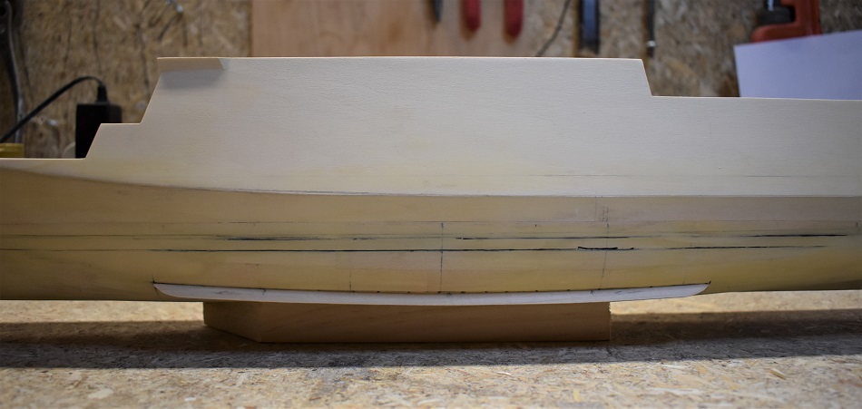

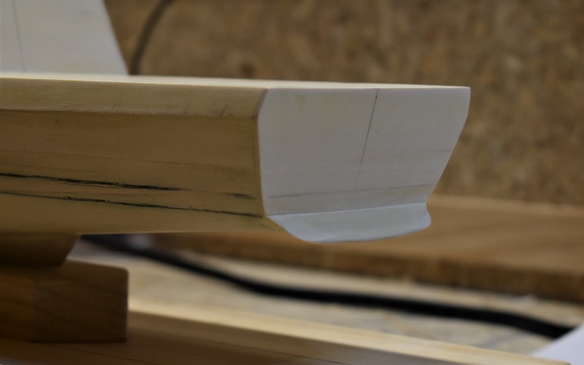

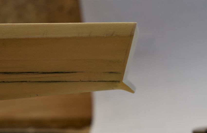

I've added the bilge keels and stern flap. Both are made of 1/16 inch basswood. The bilge keels are sanded to be tapered towards the outboard edge. The stern flap is curved to match the bottom edge of the transom and filler is added on the upper side to give it a wedge shape, thicker against the hull.

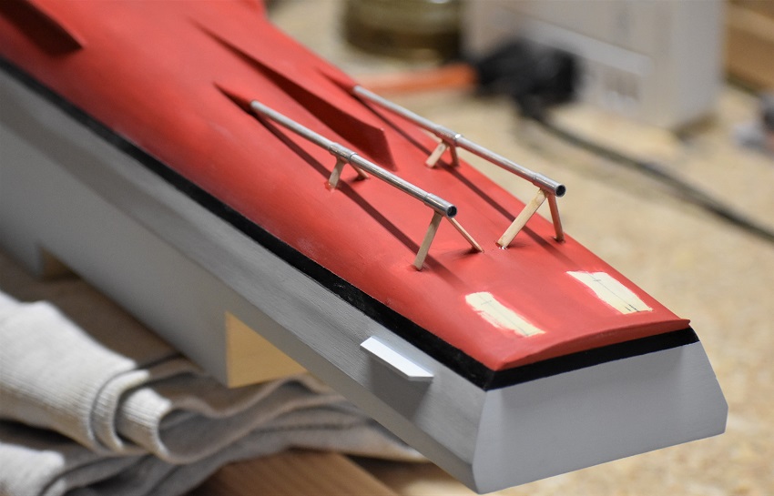

The shafts and struts are completed, pending some red paint.

This last week has been mainly painting. I use acrylic paints from the craft store, applied with a brush, and using blue painter's tape.

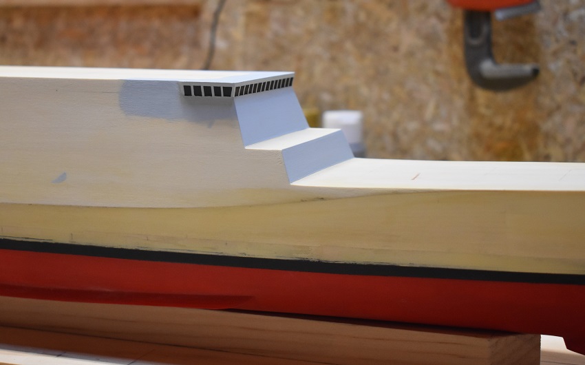

I recall my post on the previous page from 27 April, where I talked about marking the waterline for later painting. Turned out that was a pathetic job. I was getting set up to paint the draft marks and discovered that the black boot topping was only 3/16 inch high instead of the designed 4/16 inch. Just a 25% error. Carefully measuring heights above the baseline to see whether I needed to raise the upper edge or lower the bottom edge of the black, I discovered the answer is yes; it's not consistent along the model's length. Some rework is required.
I suppose a laser level would have provided better results, but those are a bit expensive for this hobby. Is it Friday yet?

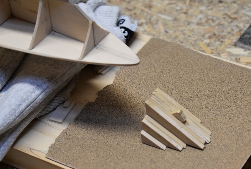

David, I originally used the tool in the upper right corner of the first picture here. I think it was too long, so it was difficult to adjust to the precise marking height, and it jittered when moving across the hull.
The second photo shows today's rig to mark the hull a second time. This one was made up of stacked wood pieces that fortunately worked out to the correct height for the bottom edge of the black boot topping. Adding a quarter inch piece provided the correct height for the top of the black. And it fit my hand easily for firm control, sliding across the tabletop. The bubble level and tape keeping the hull stable on the stand ensured that the hull was properly leveled for uniform results on both sides. I just made pencil marks every inch or two that I'll connect with the tape for new black stripe. Fortunately I don't need to cover misplaced black with red or gray.
